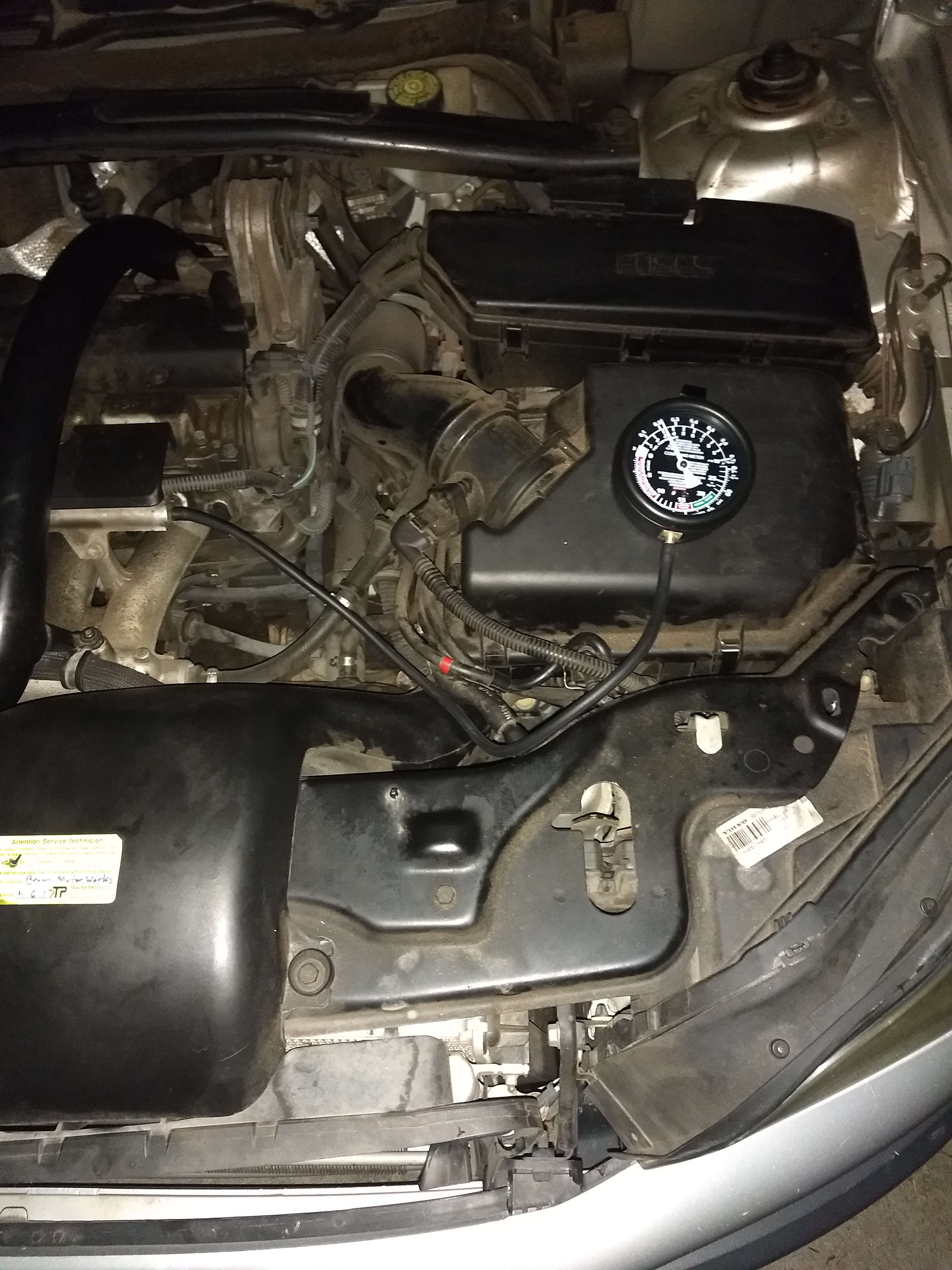

Trying to replace the fuel pump in a 2004 Volvo XC90 (2.5, 2WD).
I not an expert mechanic by any means but pretty decent at following directions and whatnot, but can't figure out for the life of me why it doesn't work.
After replacing fuel pump, engine won't catch. It sounds like it's not getting enough fuel, but I hooked a pressure gauge up and verified that there is at least some fuel coming into the fuel rail (just not sure if it's enough).
I'm wondering if there is some trick or adjustment or setting on a new fuel pump that some of you experienced folks might know about that I'm just not aware of.
Here are some pics of what the pressure gauge is showing:
My setup, with pressure gauge attached to fuel rail
Trying to crank engine
Trying to crank the engine and pumping accelerator once
I'm at wits end. I even tried putting the old fuel pump back in to test if it was just a bad pump (the old one wasn't completely busted, just not working right), and it's the exact same problem as the new one.
Also, I audibly verified that while the key is turned on, in the last position before cranking, both the fuel pump and the fuel sending unit are making noise for a couple seconds like they're priming.
Anyway...I know that's a lot but if anyone has any ideas before we shell out cash for a mechanic, I'd appreciate it!

Just a little update here...
I put a little more fuel in the car so it was closer to halfway full. I primed it about 12 times in a row to make sure there was pressure in the fuel rail. Then it started.
The little bit of fuel pressure I was getting off of the recommended 3-5 primes just wasn't quite enough.
