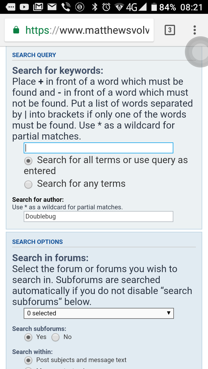

I caught a screen capture of how to search for a member. Then you click on the member name then choose Private Message.
