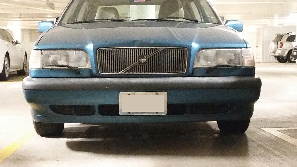

Can you guys tell me which alter I have? Below is a picture showing the front of my Volvo 850 1996 GLT.

Alter 2.
1995 is facelift year.

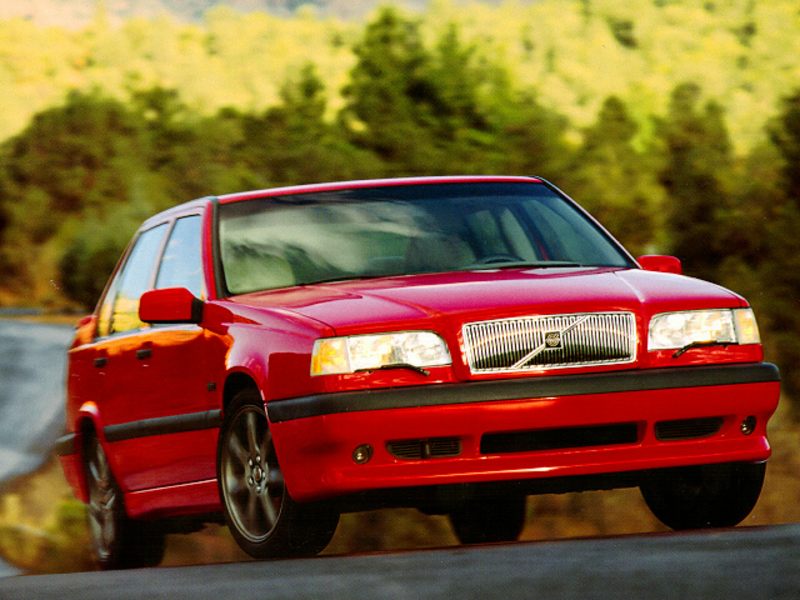

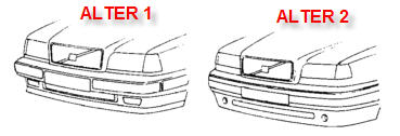

Thank you Misha. I was confused by the picture below. I don't have the round holes under the bumper. My holes are rectangular like in Alter 1, but I notice my headlamps are shorter as in Alter 2.

Those holes are for fog lights(spot lights).They were introduced in '95 with top equipped models and T5....up to '97 (including '97).
"Alter 1" have different headlights,side lights,bumpers,fog lights and tail lights.
That rectangular holes you have are just vent holes.Fog lights(if equipped) goes like this: This is "Alter 1" look:
