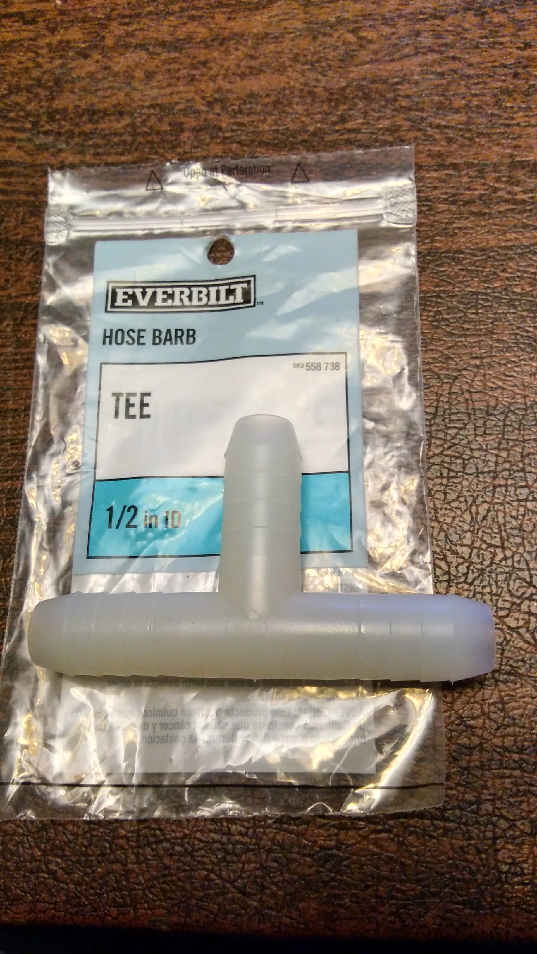

So, here we go. I bought two of this item at Home Depot. I think they were $1.77 each. (I experimented with a brass part, but the plastic tee was much easier to work with and perfectly adequate.)
Next, I cut them down to this shape. I used a Dremel cut-off wheel which was messy but worked fine.
Why is it cut like that? Well, the slot is where the "ears" on the spring-loaded center bar go, and they move around some. The perpendicular part at the bottom is made as shallow as possible because the cargo cover will be too wide to install unless you do this. The original part was designed to work more cleverly than mine is, but they could mold anything they wanted. I'm working like McGiver, here. Unless you cut this down, you will be adding over 1/2" at each end of the shade. You'll have a bear of a time fitting that between the walls, and a bear and a half trying to get it out. What I did increased the length about 1/4" at one end and no increase at the other end.
