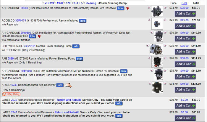

Thinking about some options here. FCP has a Meyle power steering pump for $201 and a Maval one for $122. So, being the frugal person that I am, I'm looking over at Rockauto and there are other options here... I'm thinking about the AC/Delco. It's Professional! Or the Cardone... Any thoughts?

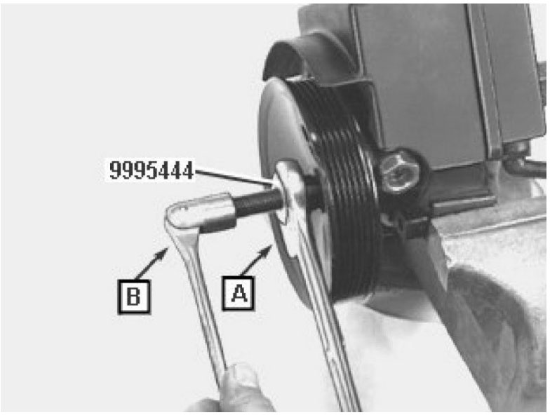

I was thinking about that AC Delco one, too. I need to run into my local Napa and see if they have a shop that can pull that pulley off. Now I see why most folks install used pieces on here and on the internet. Does anyone have that Volvo tool? What makes it special? I'm sure there's a way to mimic its function...
Volvo 9995444 doesn't seem too terribly complex. It actually looks a lot like a bicycle bottom bracket puller tool.
For $17 plus shipping, I might just bite the bullet and get it. As long as I could lend it out at least once it'd be worth it...

I don't have as much time on my hands as I used to have so I ordered a 9995443 tool in order to be able to remove the pulley with relative ease. Is there a secret to doing this? These are reverse threaded right (i.e., righty-loosey; lefty-tight), no?
