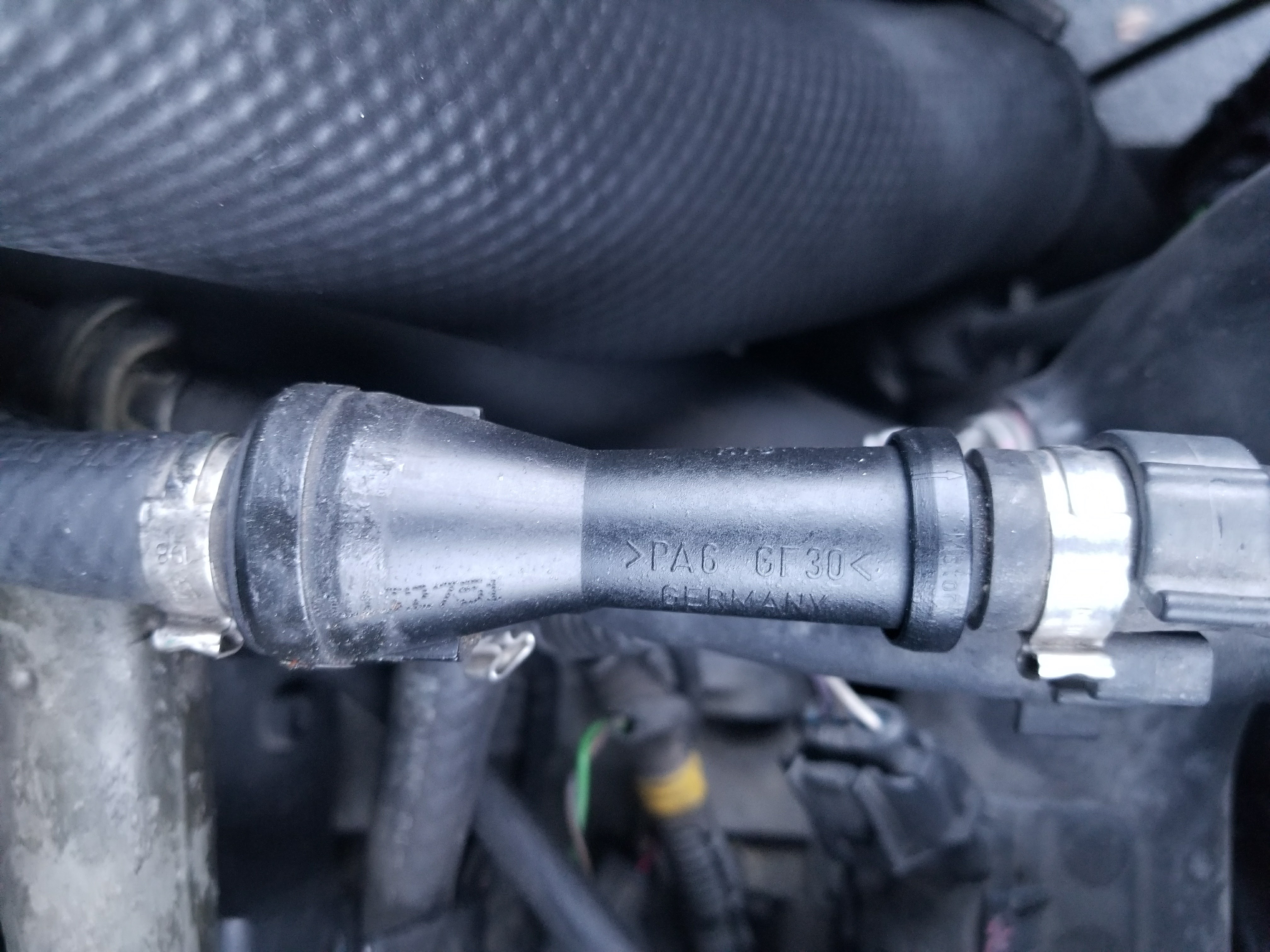

Add another pic zoomed out a little. Is that the air intake hose in the back, or the intercooler hose from the bottom?

It's sitting on top is all I know

I don't know but I know it's sitting on top

That designation actually says what material the part is made of.
Read all other designations from it and post it.

>PAG GF30< is 30% long strand glass fiber reinforced nylon 6 Black.
Get and post the marking on the other side.

Or, as FLX90 suggested, can you take another picture from slightly further away so we can figure out where the parts sits in the engine bay. It looks familiar, but I too can't think where it is.

Looks like the one way valve going to intake from the brake booster but just a guess because the size of the object is difficult to guage. How long is it?

I believe this is what you're looking for:

What does a Volvo Brake Master Cylinder Ejector Valve do?
