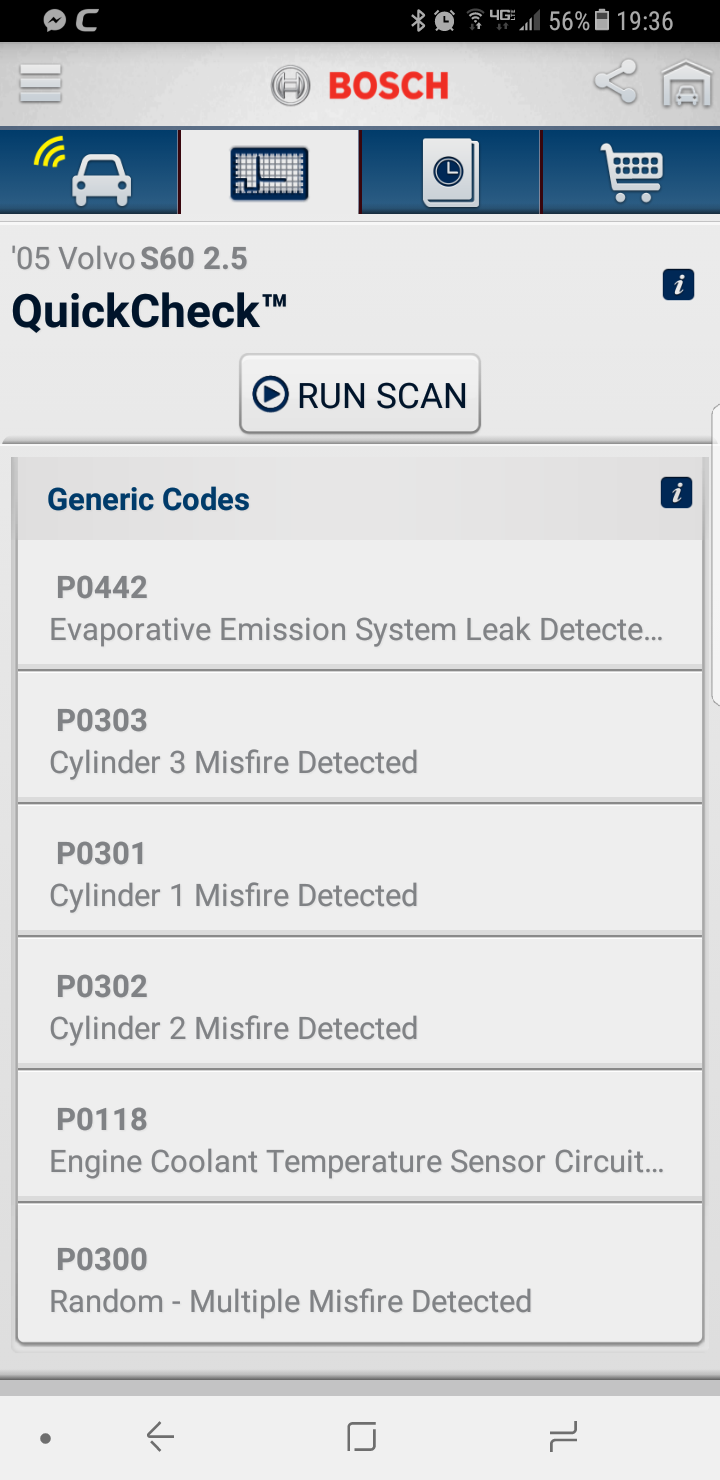

Interesting. Got the Bosch 1050 just to get the basics. Apparently 1-3 had misfires. Pulled coil #3 and nothing changes in stumble, so I definitely know which cyl it is on.

Note how the misfire indicators aren't always reported correctly. I doubt you had number one and two proble,s but if the car is skipping the sensing of cylinders can be fooled
