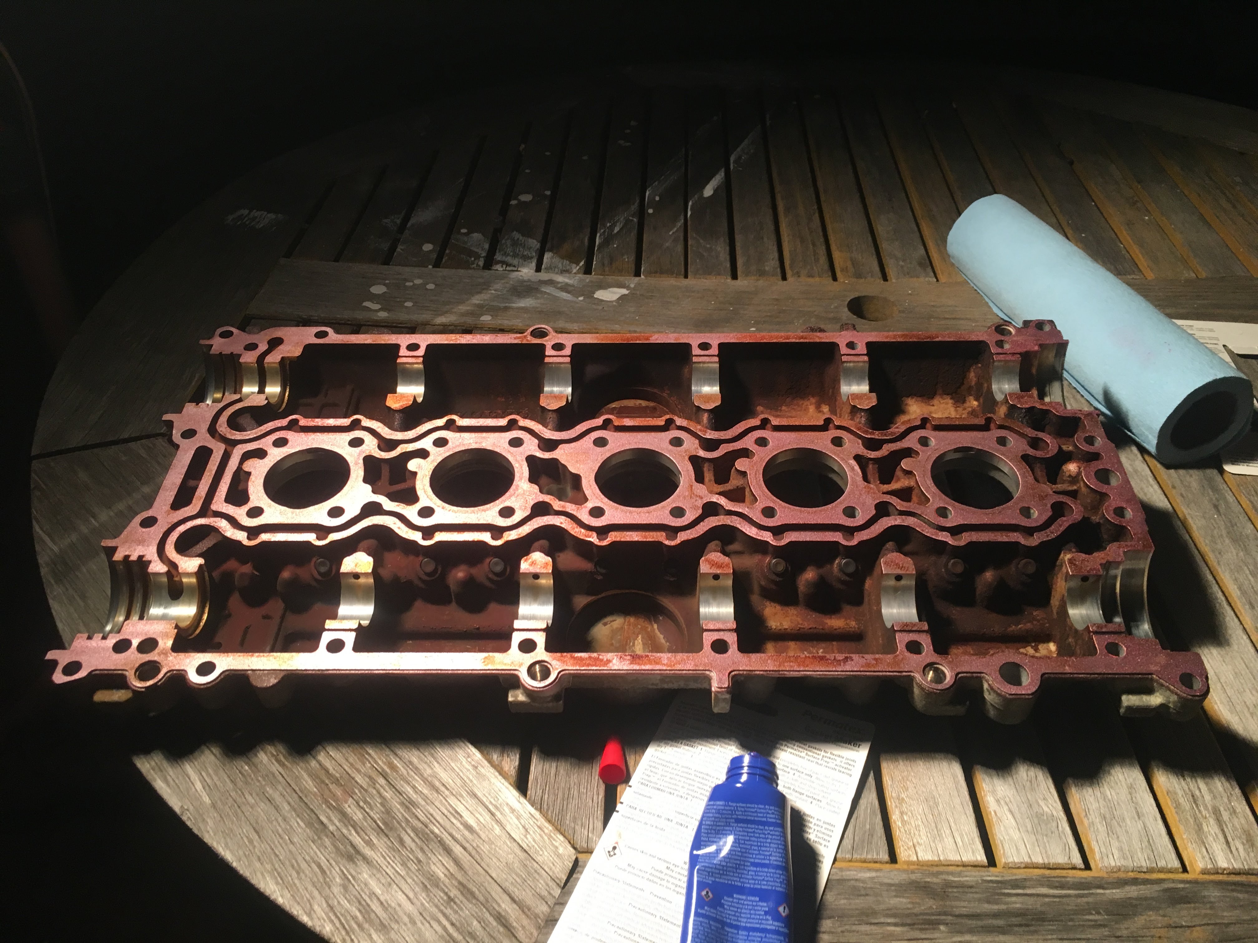

Another thought I had was whether I could use emery cloth to clean the cylinder head. Volvo specifies it to smooth the mating surfaces for the camshaft oil seals, so I’m wondering if there’s any reason I couldn’t use it on the mating surfaces of the head...

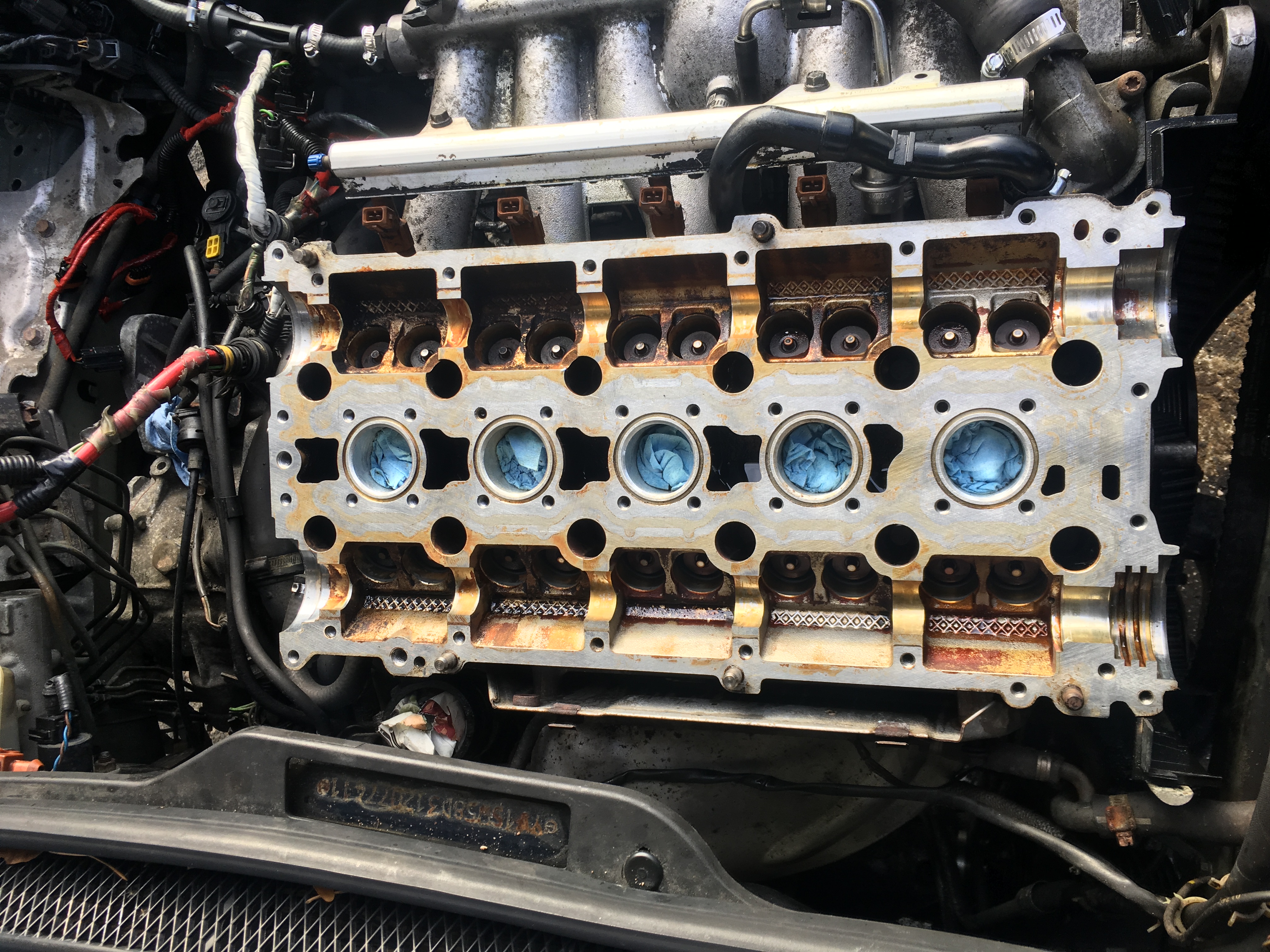

Over the years I have learned that for head work there are two kinds of automotive gasket remover products: the worthless ones (e.g. Permatex) and the ones that are essentially paint stripper. If you can very carefully contain the overspray, varnish remover is superb for preparing the head and cam cover surfaces. Spray it on, let it sit to dissolve oil deposits, wipe it off. Come back through with a razor blade for the smallest of touch-up spots.

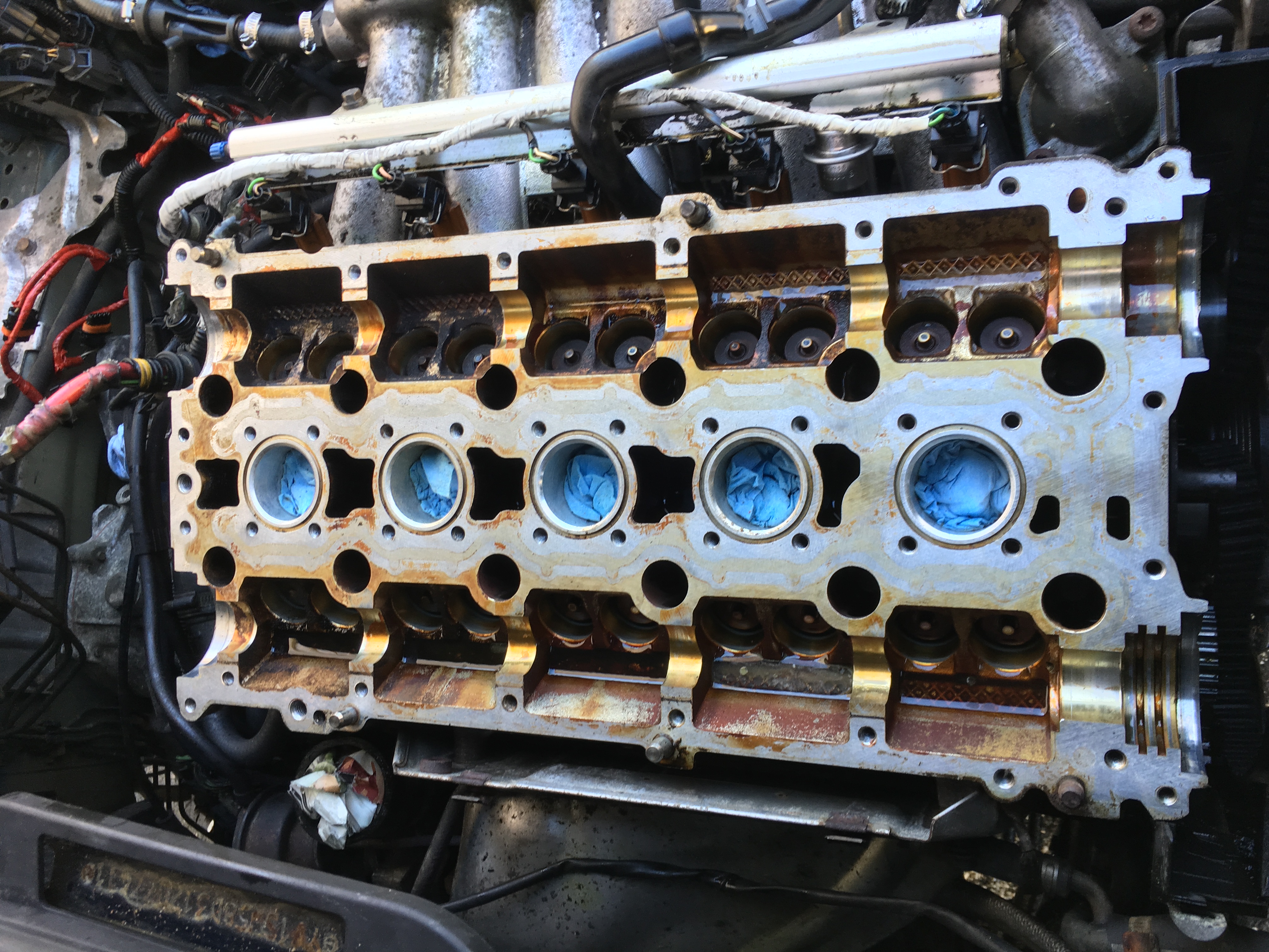

Post-weekend update. Removed as much gunk and discoloration from the cylinder head and camshaft cover as I felt I safely could. Took quite a while and I think if I had to do it again I would probably try the paint stripper method.

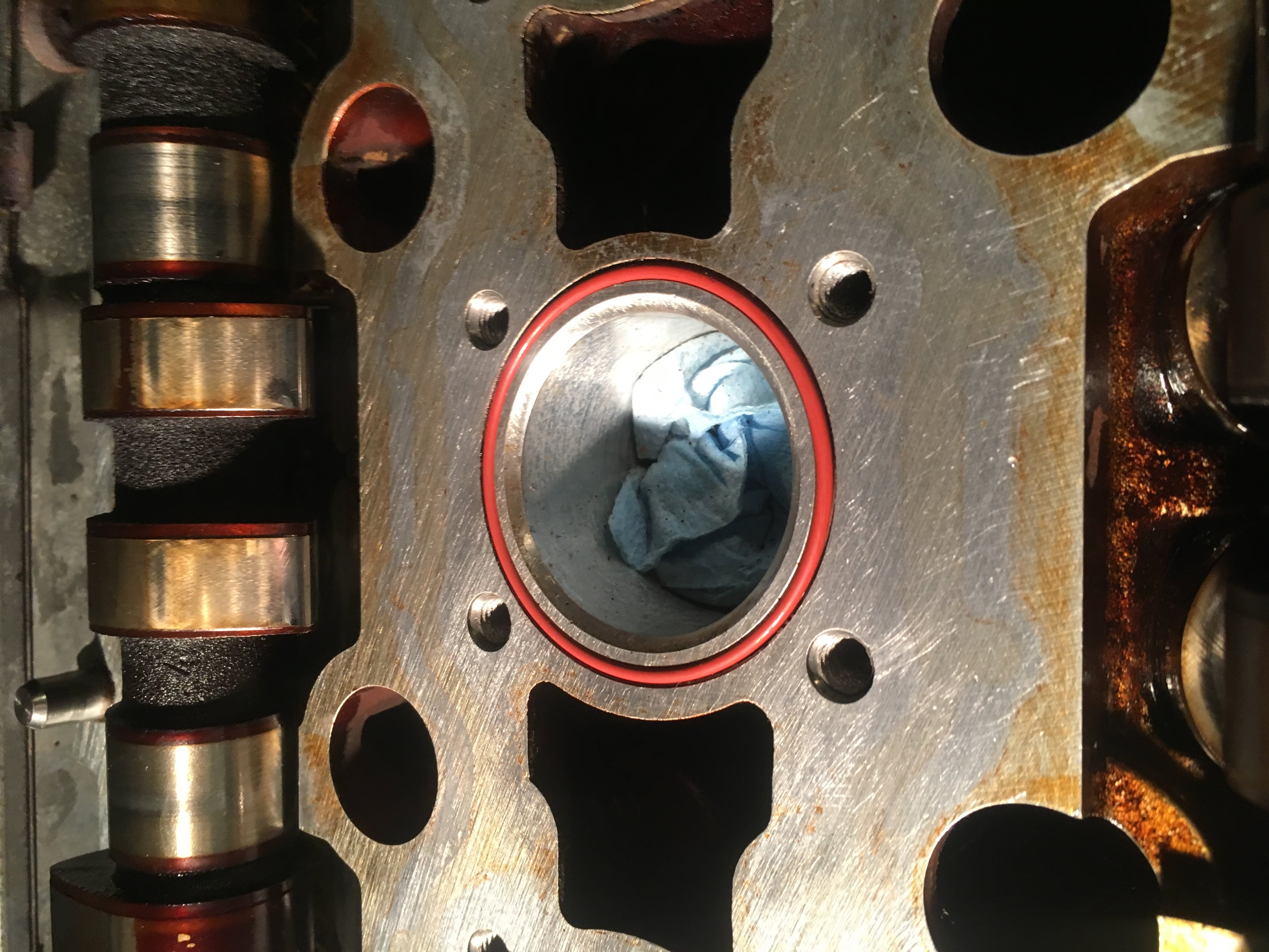

Installed the new o-rings around the spark plug tubes:
Applied the anerobic gasket to the cam cover:
I did the thinnest layer I could manage while still giving what I considered adequate coverage.
I reinstalled the camshafts and the camshaft cover. I used very slow and methodical hand-tightening of the 42 bolts in an inside-out pattern to get the cover all the way down. Used a 1/4" drive mini ratchet in quarter turn increments when I encountered resistance.
