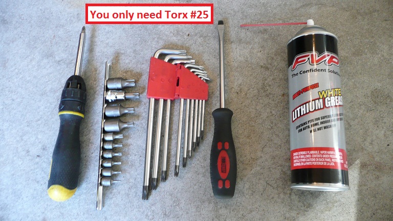

TOOLS:
- Torx Key #25
- Work Light
- Oil, lithium grease etc.

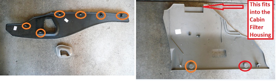

1. Move passenger chair back. Remove key from ignition. Pull the trim outward. Remove the 2 T25 screws and remove the trim:
2. Look up and you will see this. Look around and you will see 4 screws, the 5th screw is hidden and you need to break the tab to remove it.

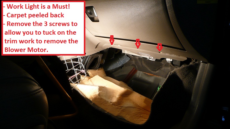

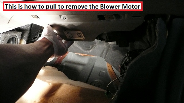

4. In order to remove the Blower Motor, you will need to:
- Remove the three (3) T25 screws as shown, this allows you to pull on the trim work to remove the BM.
- Peel the carpet back to create extra space.

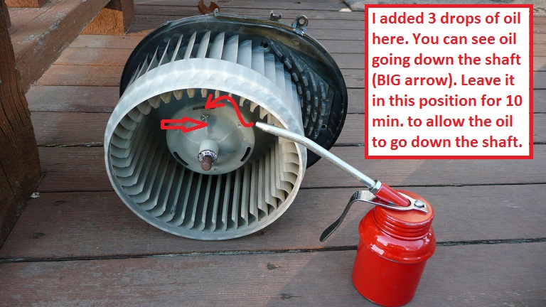

7. To lubricate the FRONT shaft, unless you have the tool to remove the plastic cage, you need to do it the redneck way: I added 3 drops of oil at 12 o’clock position. Leave it alone like that for 10 minutes (don’t disturb it, you want to oil to wick downward to the shaft).

Nice DIY about removing the blower. I tried too to lubricate the bushing bearings. Unfortunately it didn't last so I went and removed the fan wheel and damaged the motor in the process. Turns out, the upper bearing (it's actualy the one that gets noisy) was rusted inside so oil would only temporarily help. The bearing (it's a bushing bearing) needs cleaned with a wire brush. Even easier, used fan units are available for not much, just carefully look for one that has the metal tip in the center of the fan wheel not rusted.

As I mentioned before, these are not bearings but rather, they are bushings. So 1-2 drops of oil is all you need and this should last another 100K miles.
