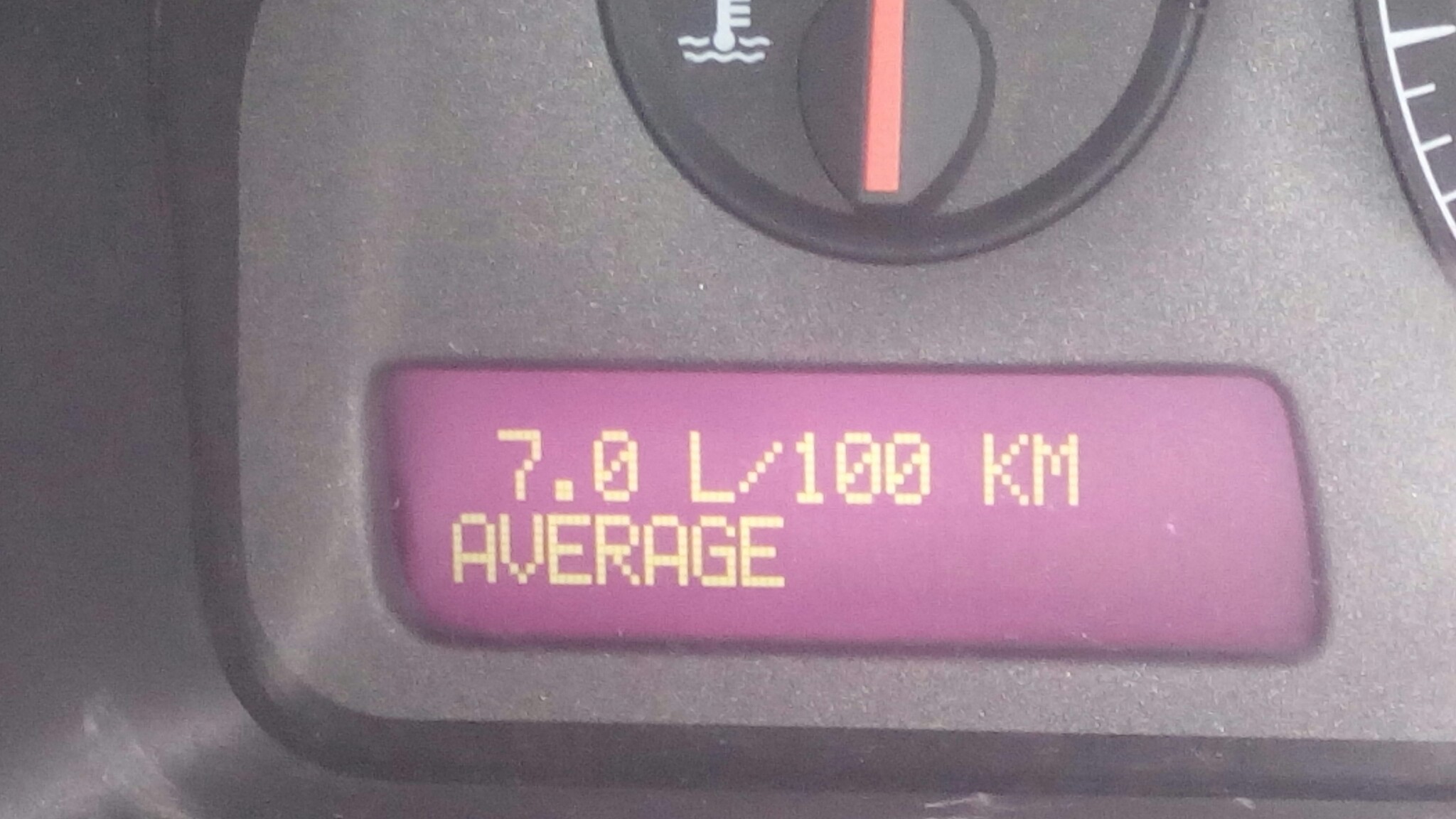

When my front 02 sensor failed a few weeks ago in my 2001 V70T5 it was like someone flicked a switch. The heated element circuit went open and fuel mileage plummeted, especially around town.
I had the same CEL for front O2 sensor and fitted the Bosch 17070 sensor yesterday. Today I got my first ever 7.0L/100kms (about 34mpg) on a stretch of freeway and averaged 25mpg on the whole trip. Hope it fixes yours too.
