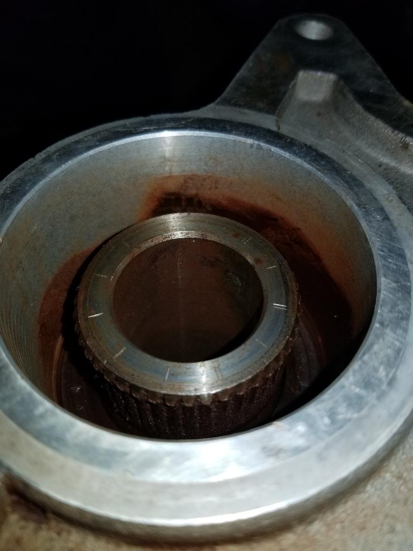

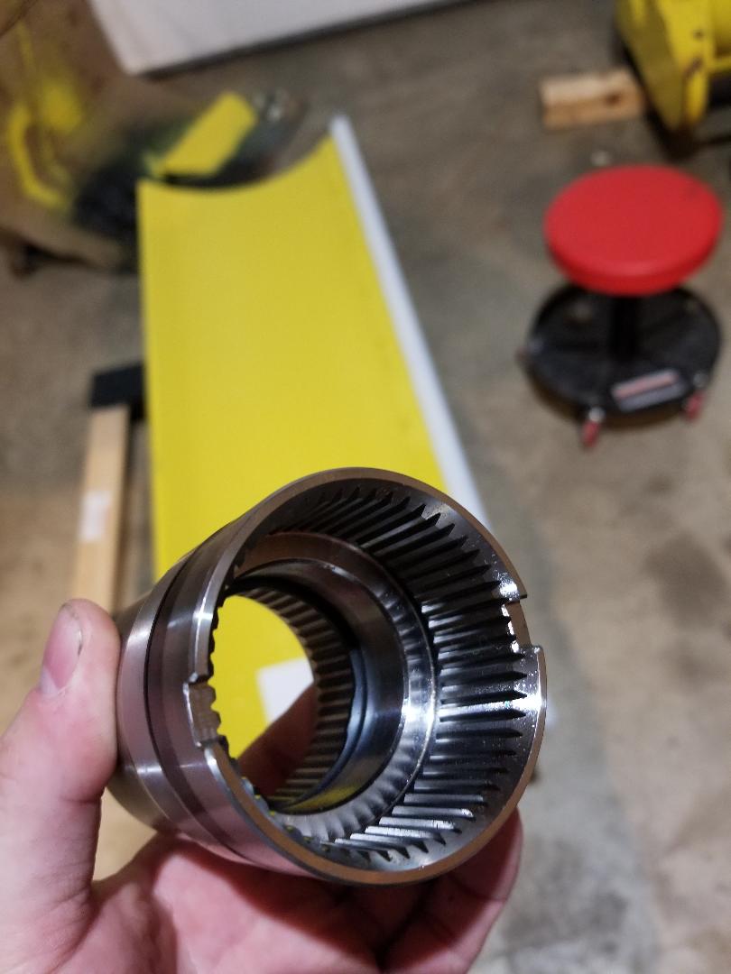

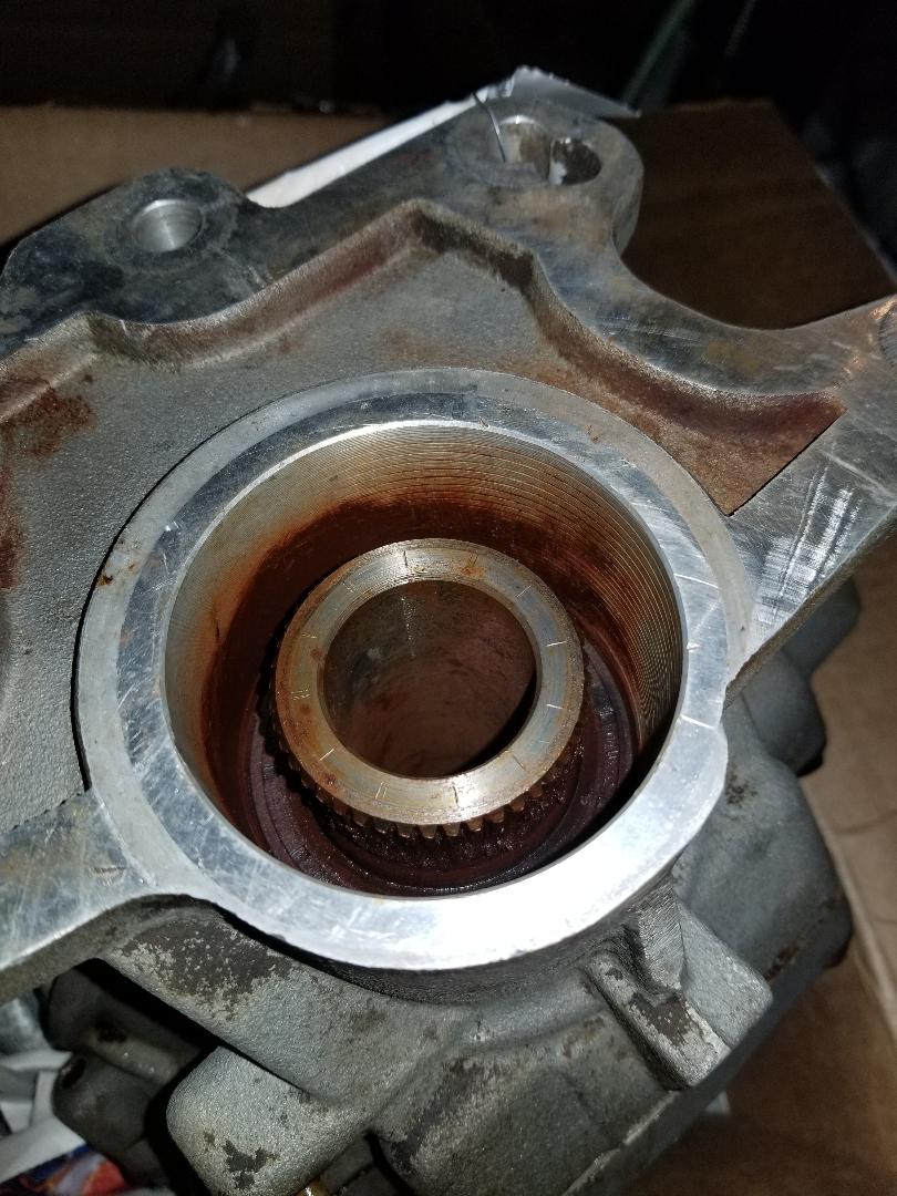

So I bit the bullet and purchased a used angle gear from the same year as my XC70. It has 100k miles on, versus my 165k. I had to purchase sight unseen, I got a pretty good price but am concerned the spline teeth on the actual angle gear may be too worn, but I am not sure.
There is no lateral movement and the bevel gear spins nice and freely. My problem is that I can't seem to get the new spline collar to easily slide on to the splined shaft of the angle gear. I already checked that I ordered the correct par so I am asking if there is some trick to installing the spline shaft?
I am also asking for opinions on if the teeth are too worn and what I should do.

Hi all, Looking for some guidance on angle gear replacement.
The unit I have pictured in the last post was one I got cheap from a junk yard. From a visual standpoint the housing matches the non-operational/toothless unit in my car currently, however the spline teeth on the one pictured are damaged and I cannot get a new gear collar sleeve on it. I found another one online via Ebay with splines in good shape. Ebay seller (store front, not independent person) stated it was compatible with my vehicle and the 36000340 PN jives as an equivalent PN on the volvoparts.com website for my vehicle. HOWEVER the housing is not the same as my current one and on FCP Euro the 36000340 PN is stated as NOT compatible with 2003 XC70s. I don't know how to determine 100% if the nicer unit I got will work with my car before tearing into the car and potentially leaving it not operational if it doesn't. The local Volvo dealer couldn't even tell me for certain, the diagrams and PN lists they gave me were the same as what is on volvoparts.com and the diagrams/drawings don't show any of the features that differ.
My VIN # is YV1SZ59H431105010 , so if anyone can for certain tell me what my original PN is and if the 36000340 part will work I would be eternally grateful. Hoping to get this repair completed before snowfall.

Have you seen this thread?
viewtopic.php?f=9&t=91078&p=522262#p522262
I'm getting ready to weld my collar to the angle gear shaft. Will post more in the next week or two when I get it back apart.
I hope you didn't give much for that angle gear. The splines look worse than mine did and mine only lasted 2 weeks with the new collar installed before acting up again.
