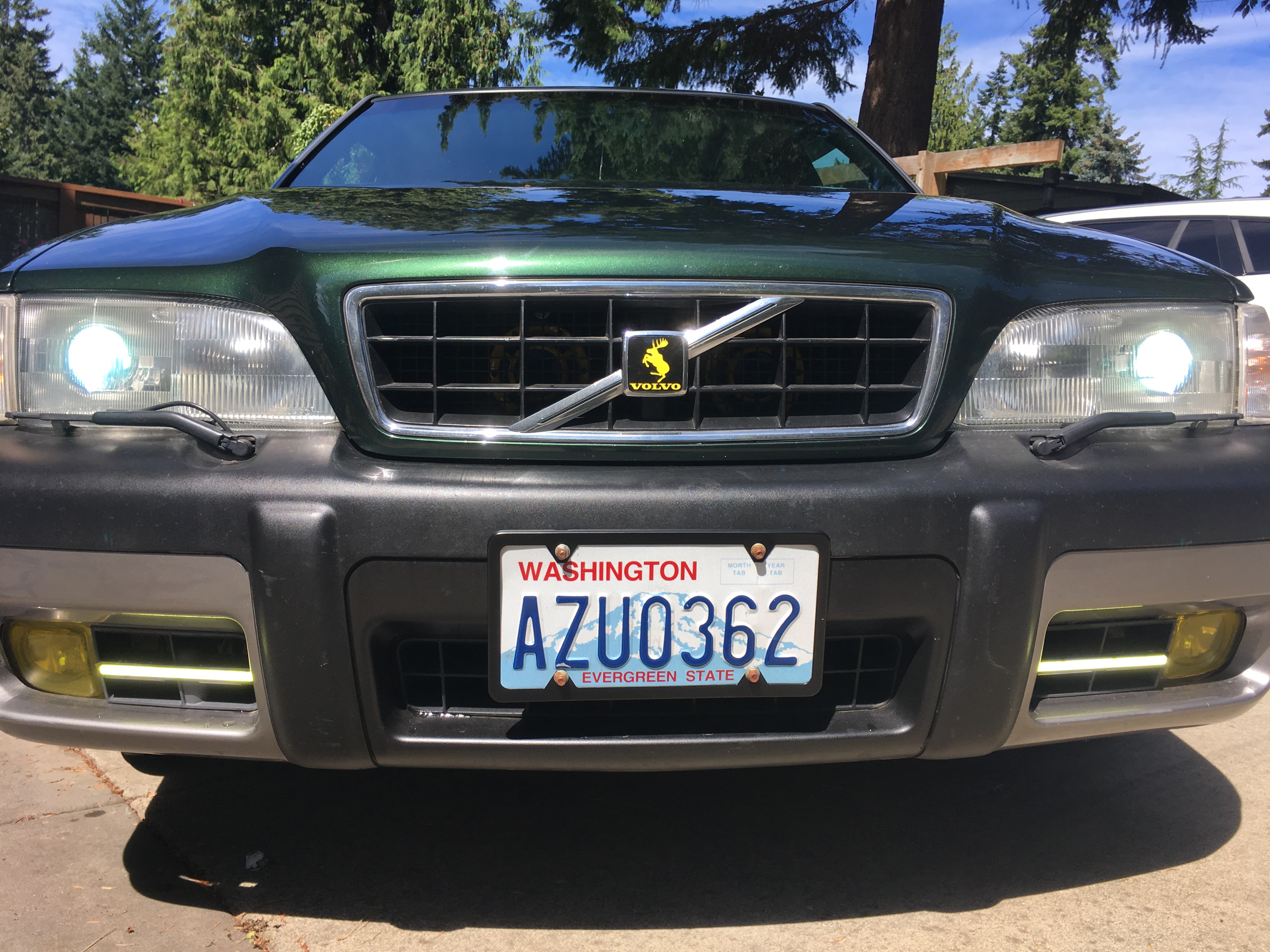

Followed your retrofit directions and am very pleased with the results. I didn't even need to take the fluting out the light output was so much improved. Thanks for a great write-up!
- IMG_8431.JPG (2.69 MiB) Viewed 2026 times
FlyingVolvo
- Posts: 1822
- Joined: 8 March 2009
- Year and Model: 2000 V70XC
- Location: USA
- Has thanked: 51 times
- Been thanked: 73 times
Very nicely done! (Best color wagon too
) What are those LED bars on your fog light grills?
