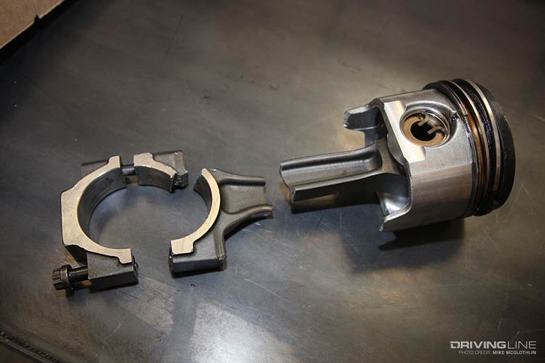

- After all these years in forum, I have never seen a failed oil pump. An oil pump typically lasts some 400K-500K, basically the life of the car, unless abused. This is why you don't see too many of these sold on ebay etc. On the other hand, I think you can sell the new oil pump on ebay, someone rebuilding an engine may want it later.
- Still curious what your problem is, I suspect a broken #1 con rod assembly.

Below is a GENERIC PHOTO of a broken rod from a random car, my theory is that. When the rod is broken, sometimes it punches a hole in the engine block, sometimes, it is like this: not long enough to punch a hole in the block, but being short and next to the oil filter housing, it punched a hole in the oil filter housing.
Just a theory...
Just a theory...

I'm pretty sure the only person to suggest a broken connecting rod during the whole saga was wizechatmgr, way back on Dec 15 (viewtopic.php?f=1&t=83738&start=10; Viking horns to you it seems!!) He also suggested a very easy way to investigate that, by just cranking the engine by hand, to see if the piston travel is normal in #1, where the misfire was. Basically in lieu of a compression test. But we all got swept up in oil pump speculation. Good lesson to do all of the easy tests first, even when we are "sure" we know what is wrong.
