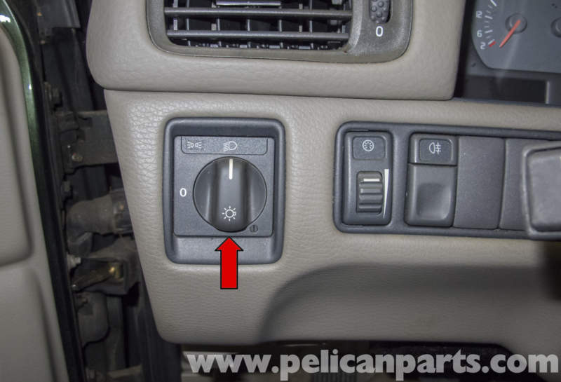

- Don't know English term for middle setting, but that's what I want to turn on remotely!
- pic01.jpg (59.42 KiB) Viewed 4128 times

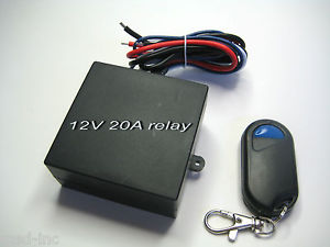

- I could use a fairly standard fob/remote + 12v relay like this one and tie it into the switch?
- s-l300.jpg (11.11 KiB) Viewed 4121 times

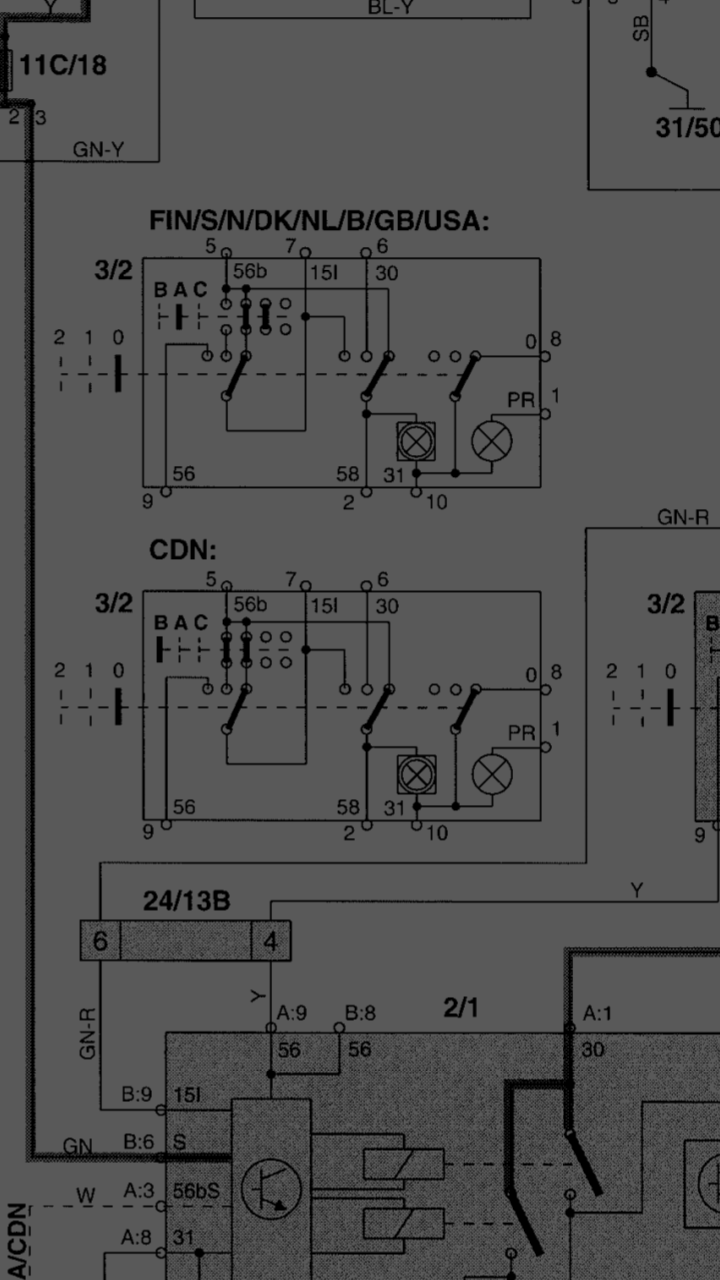

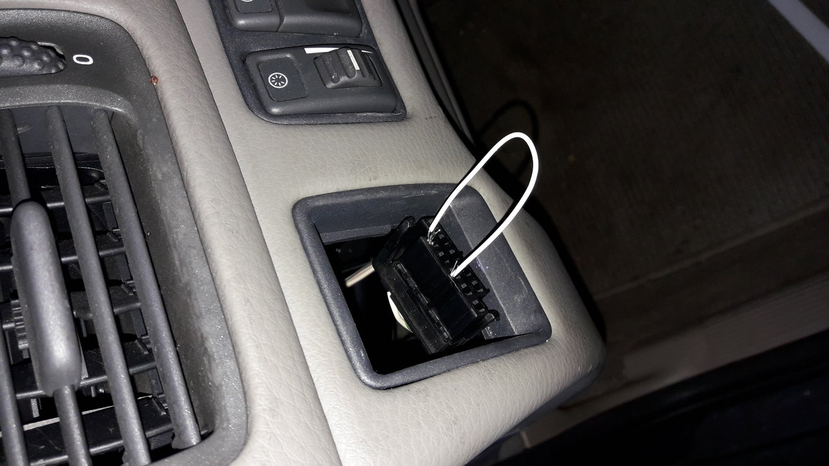

So, I ordered a remote relay kit online and, in preparation, started looking up wiring diagrams today.
Please see the picture attached. It's a close up of the headlamp switch. I think that I can override the parking lights setting by having the remote relay bridging contact no. 30 and no. 58, right? I have the Dutch (NL) switch. Or am I overlooking something and will this end in tears?
Any tips appreciated before I fry my wiring loom.

I'm by no means an electronics expert, but as far as I can tell from the wiring diagram, bridging pin 30 to 58 wouldn't help you, as they are already bridged when the light switch is in pos 0.
You'll need to bridge pin 6 and 58, but at the same time you have to break the connection between pin 8 and 31/10 and the connection between 30 and 58 or you'll be putting yourself at the risk of tears. A small fuse in series with the bridge wouldn't be a bad idea either.
I'd take the light switch out of the car and probe the pins with a multimeter checking for connectivity with the switch in pos 0 before bridging pin 6 and 58, then again after bridging them. I'd do the same with the light switch in pos 2, just to make sure there aren't any connections where there shouldn't be any.

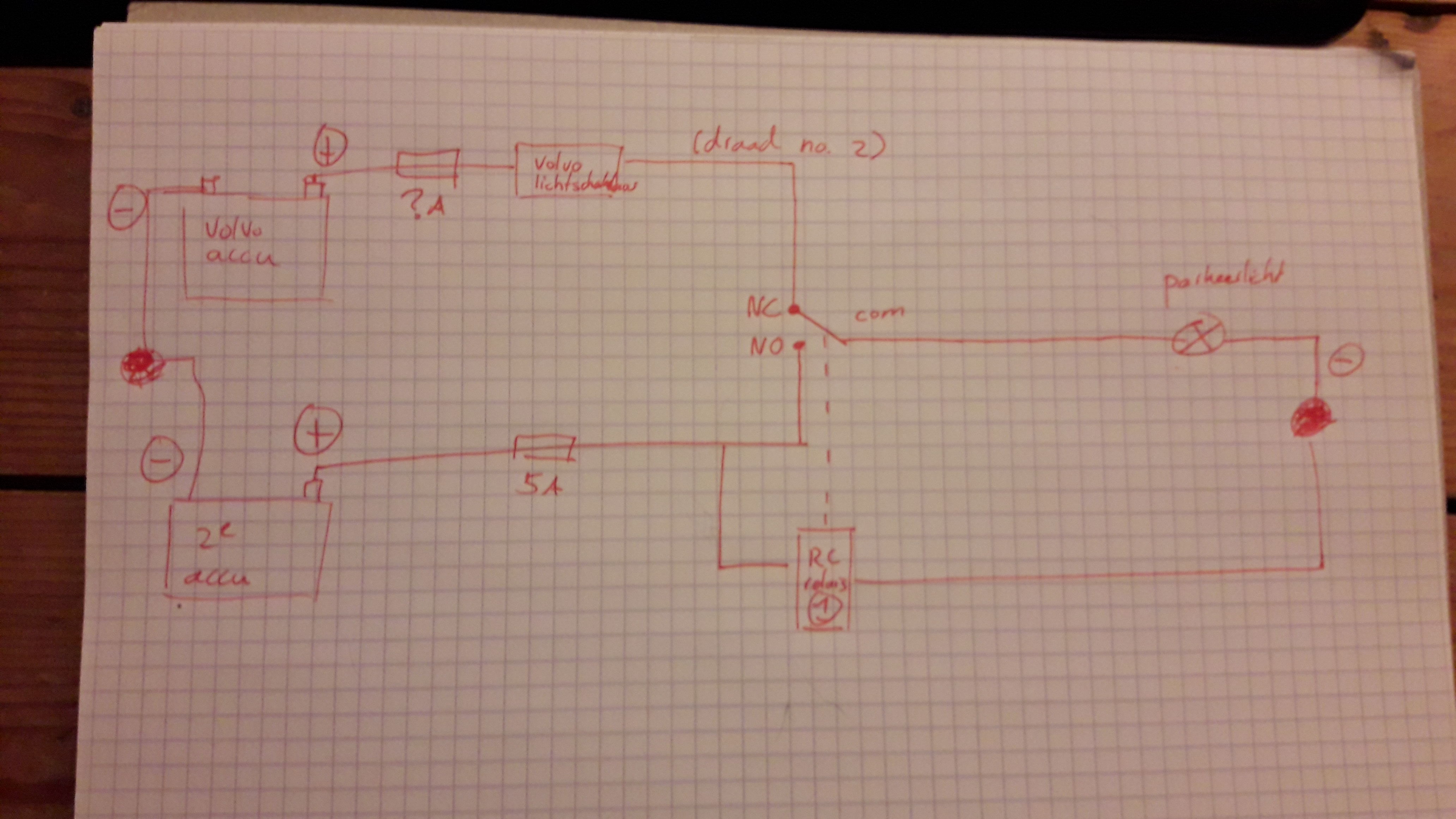

Got around to this install today.
The picture I attached shows (sorry, partially in Dutch) which solution I chose to use.
Components used:
- 2 channel keyfob + 12v receiver with 2 relays
- 4 amp fuse + fuse holder for lights
- 0.2 amp fuse for 12v receiver and relays
- wiring to auxilliary battery
- cable ties and connectors
Total cost about €20,-
Basically, the parking lights (that draw 2.6 amps altogether) can now:
Components used:
- be powered as normal with the OEM switch,
In that case run from Volvo battery.- be switched on and off with the keyfob. If so; they run off of the auxilliary battery. Added benefit is that I could keep them running very long without worrying about whether I can still start the car later on.
I still have 1 spare channel left on the RC receiver... any great tips on which gadgets to add
