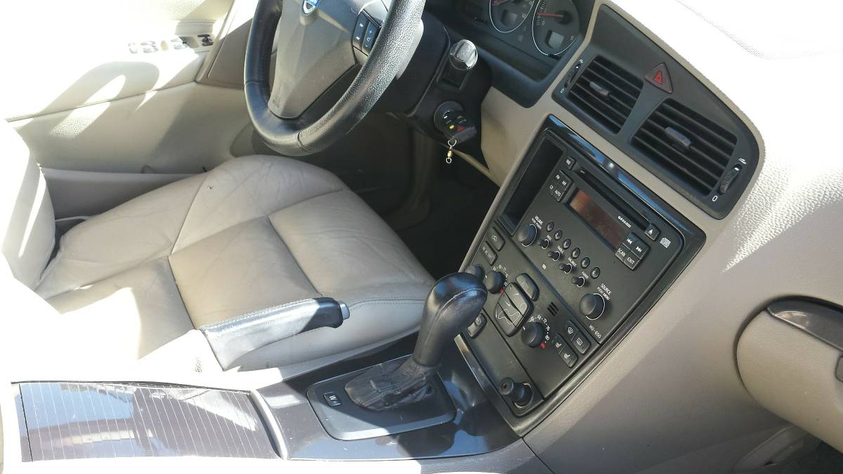

It's been a busy week, so I haven't had a lot of time to work on the car. Instead, I spent what time I had detailing the interior. Gave the interior a deluded Simple Green wash, leather conditioner, and carpet cleaning. I read steaming the foam helps resolve it, so I removed the covers and steamed the foam. You can see the foam expanded when you hit it with the steam, pretty cool. Covers fit a little tighter then before.

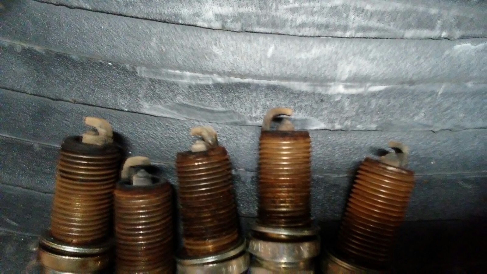

Spark Plugs
Fuel Filter
Cabin Filter

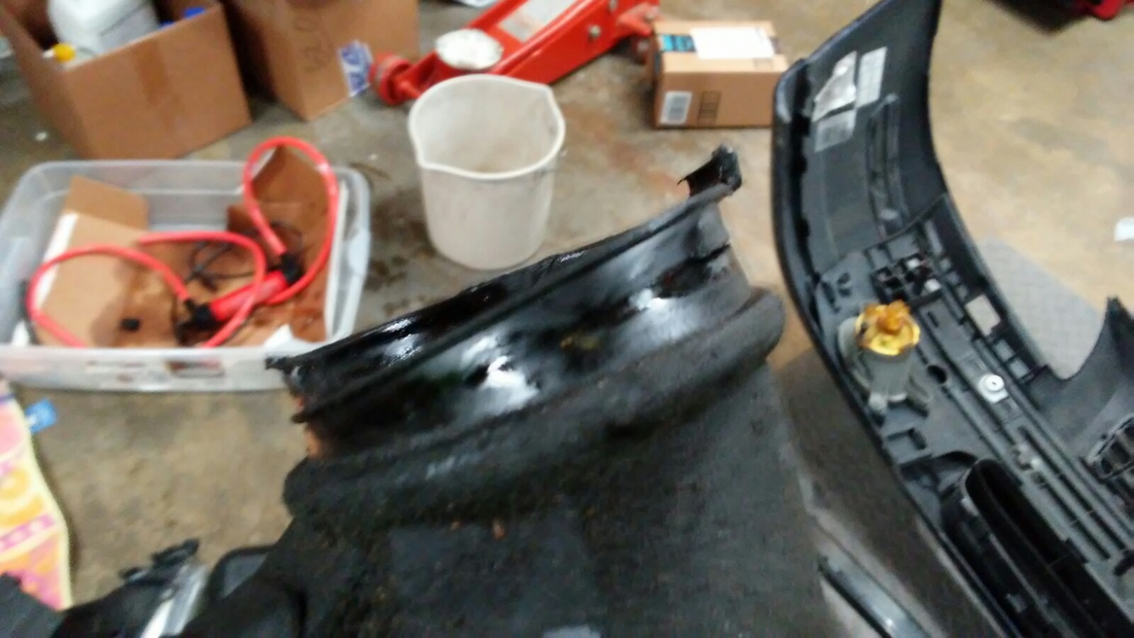

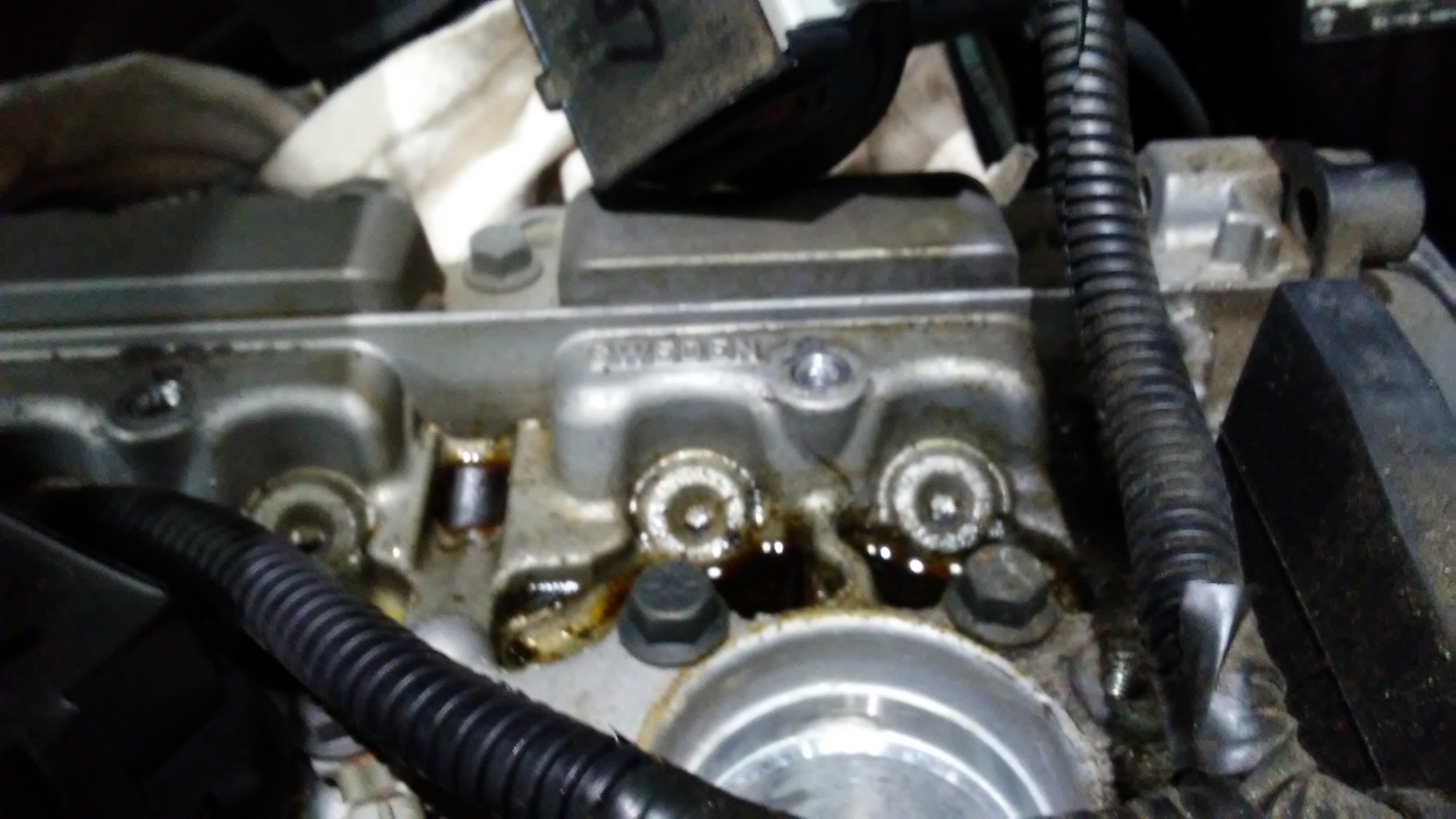

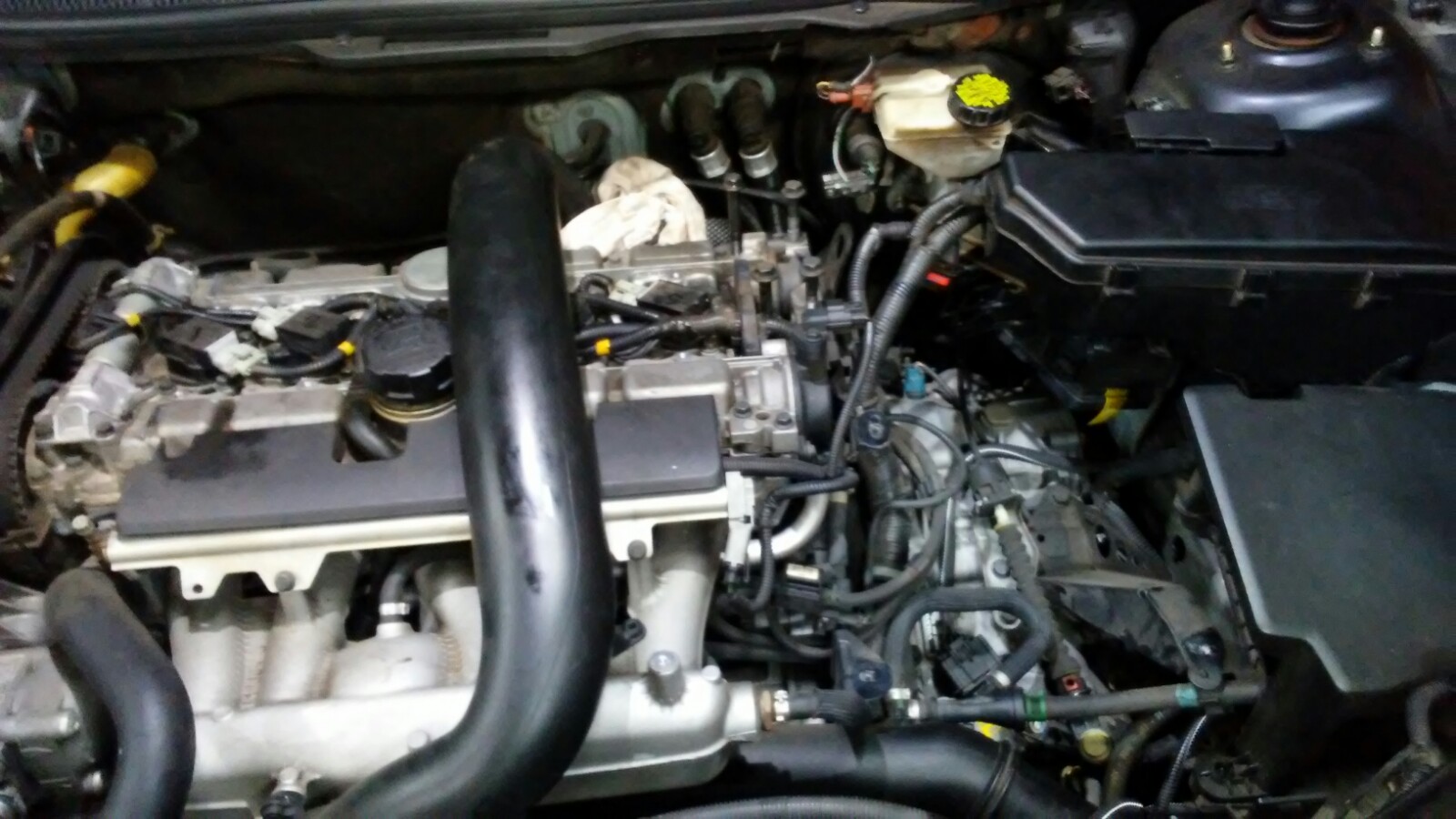

The PVC system "failed" the glove test, the glove did not suck in. Additionally, I discovered a lot of oil under the spark plug cover . So I ordered the PVC Breather Kit from FCP. While I had the top brace off for the spark plugs I decided to check and clean the PTC nipple. After removing the air intake tube I noticed the bottom broken, so I'll need to order a replacement or an upgrade intake tube.

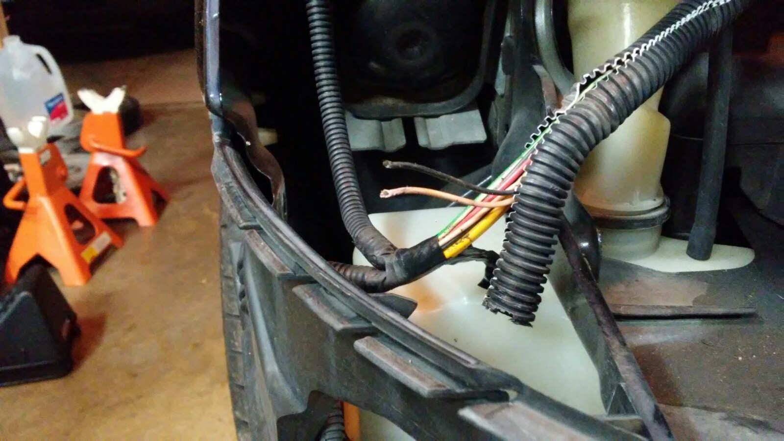

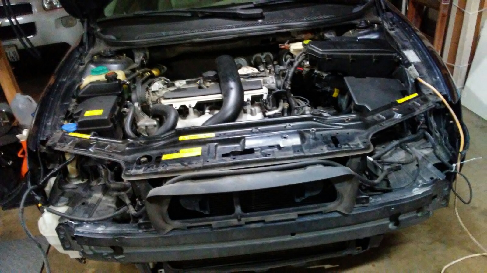

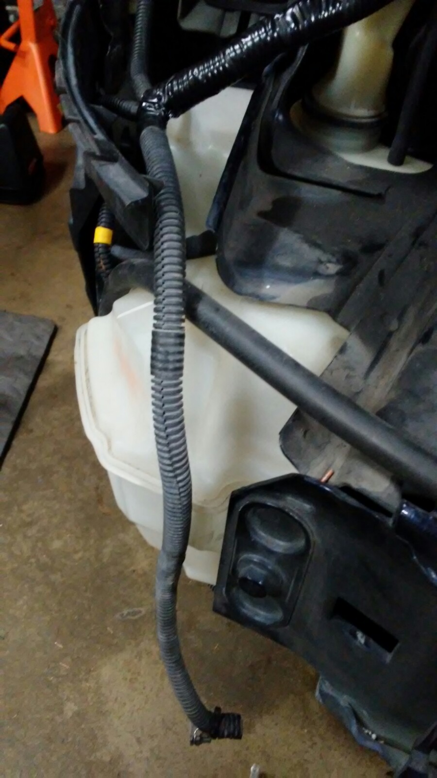

I found a pair of headlights to replace the cracked driver side and the faded passenger side. So I removed the front bumper to replace the headlights. Unfortunately, after removing the lights I noticed mime where HID and the replacements I picked up where halogen. So the replacements need to go and I need to find a driver side HID assembly. In the process I discovered someone had cut the passenger side fog light wire harness. I picked one up at the junkyard and rewired it to the main wiring harness.
Old Spark Plugs, mileage unknown
Oil Under Spark Plug Cover

Missing Fog Light Wire Harness
Broken Intake Tube

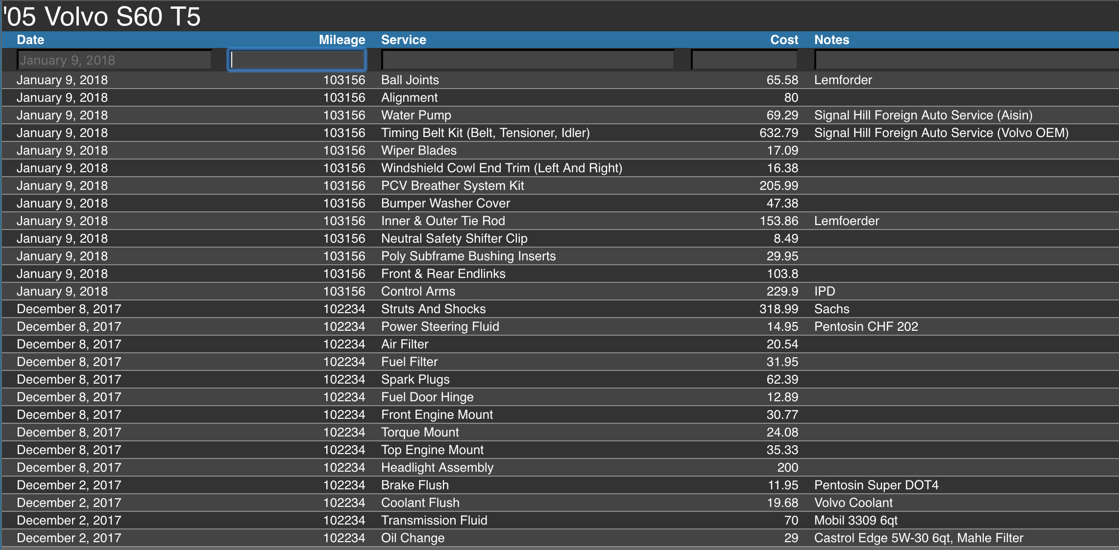

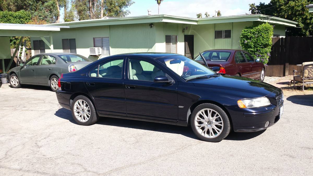

Finally finished!!! Here is the cost break down for the project. I'm about $1,500 over my original $1,000 budget for repairs, which is quite a lot. I'm coming to the conclusion that owning a P2 or earlier is more about desire then smart money. The resale value is not there given the DIY repair costs for these cars over 100K miles. I'm at $6K which is probably $1,500 over the best resale value. There are a few things I feel I could have skipped, but not many. I really enjoy driving it, I have a 2010 BMW 328i (e92) coupe and a 2013 BMW 328i (f30) sedan to compare it to. The S60 T5 is top of the list, so for $6K I got a car I love driving.
This is my second time around with a S60 crossing the 100K mileage mark. From my experience and knowledge from reading, this is par for the coarse. The only difference was I owned the first S60 since 36K miles and did most these items between 80K and 140K miles so the sticker shock wasn't so bad.
