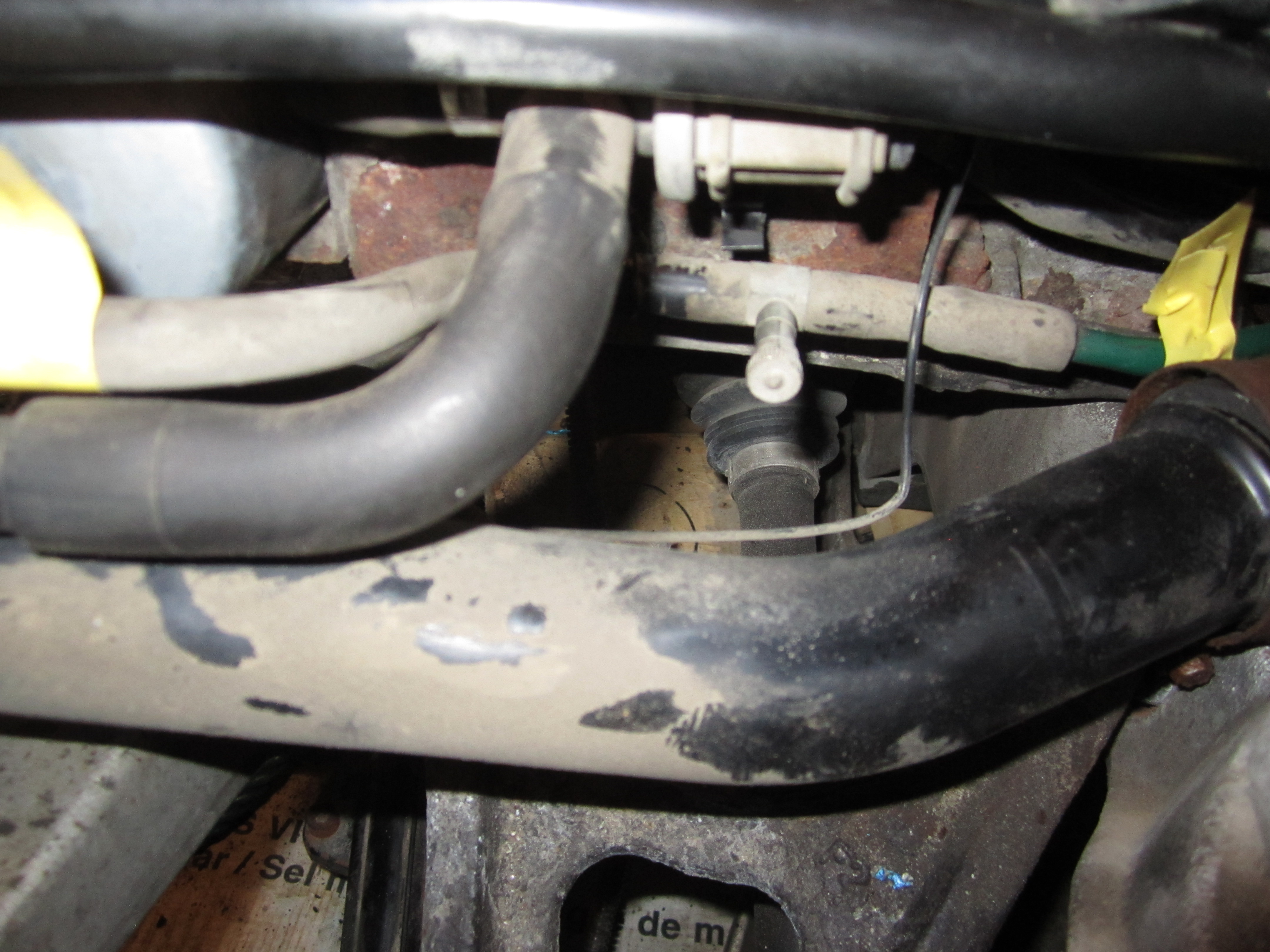

I'm not clear on what car jtp replaced the fuel filter on. But on my 2000 V70R there is a hard to see Schraeder valve at the back of the fuel line inside of the RHR wheel near the roll-over valve.
There it is above just forward of the fuel filter on the RHS.
