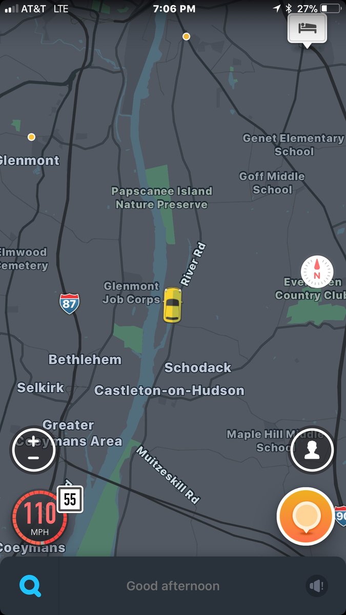

Exactly double... nice!abscate wrote: 20 Jan 2018, 06:03 image.jpegMy mileage coming home last night was horrible but my trip was short...no idea why...
