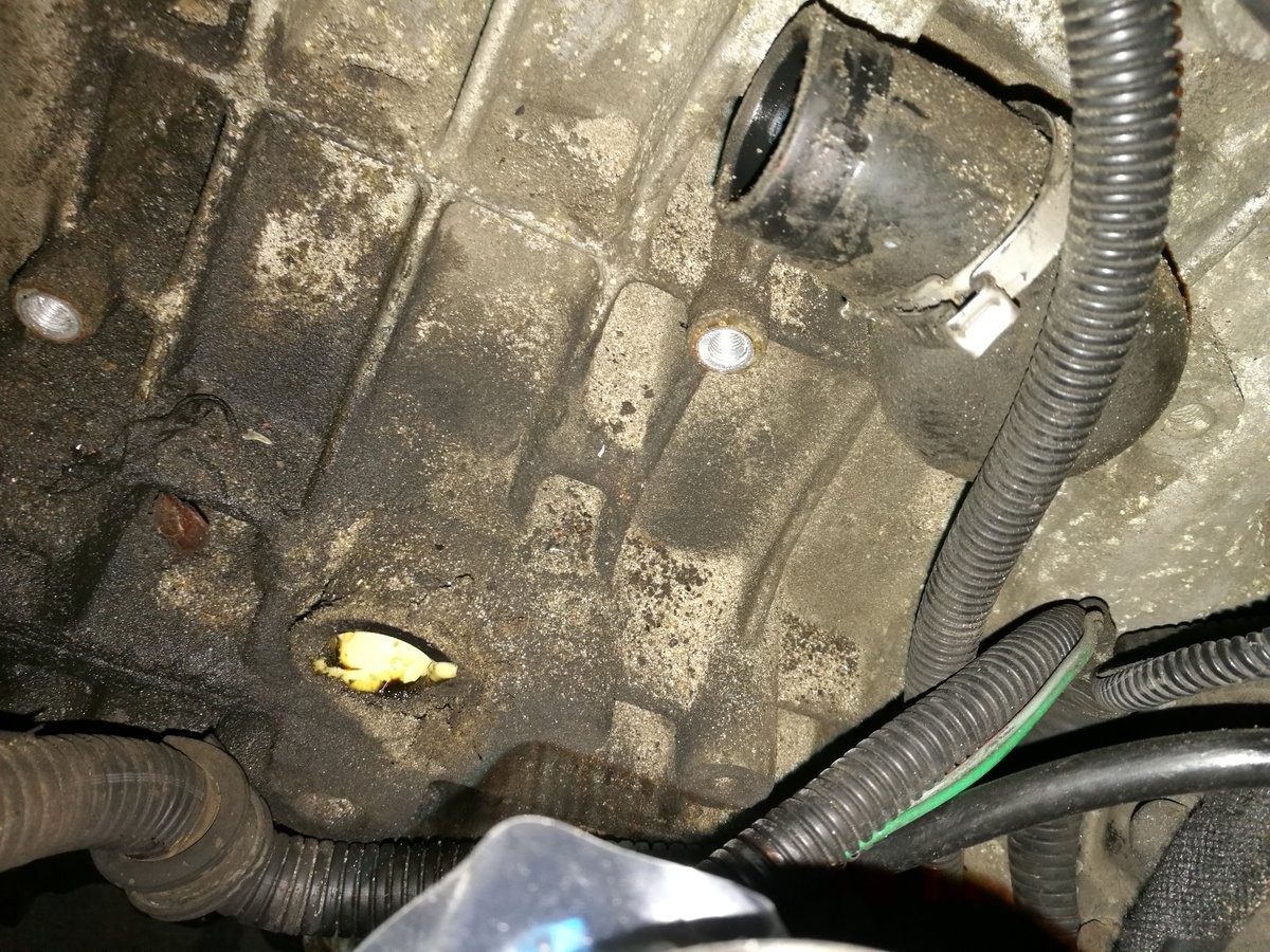

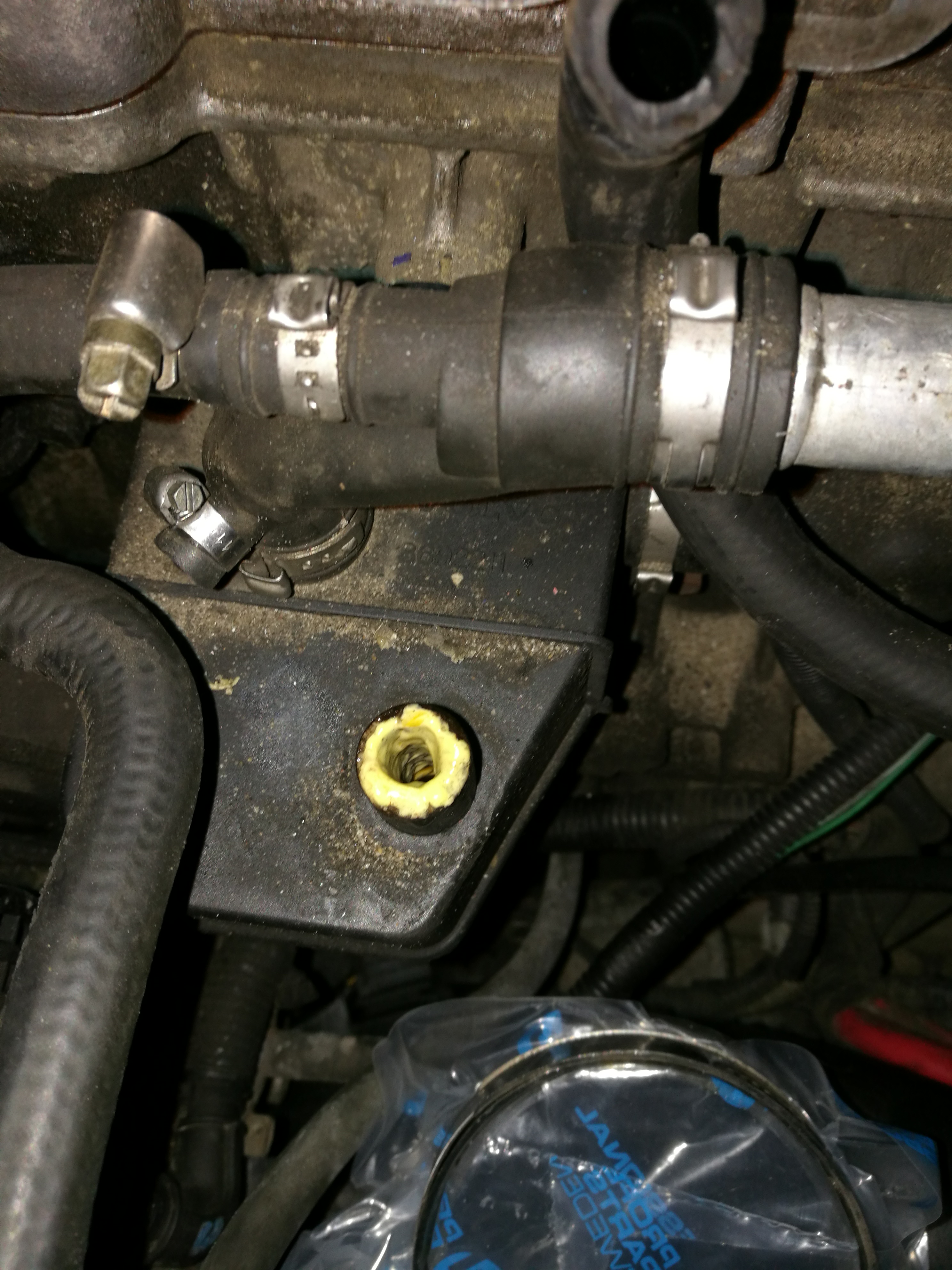

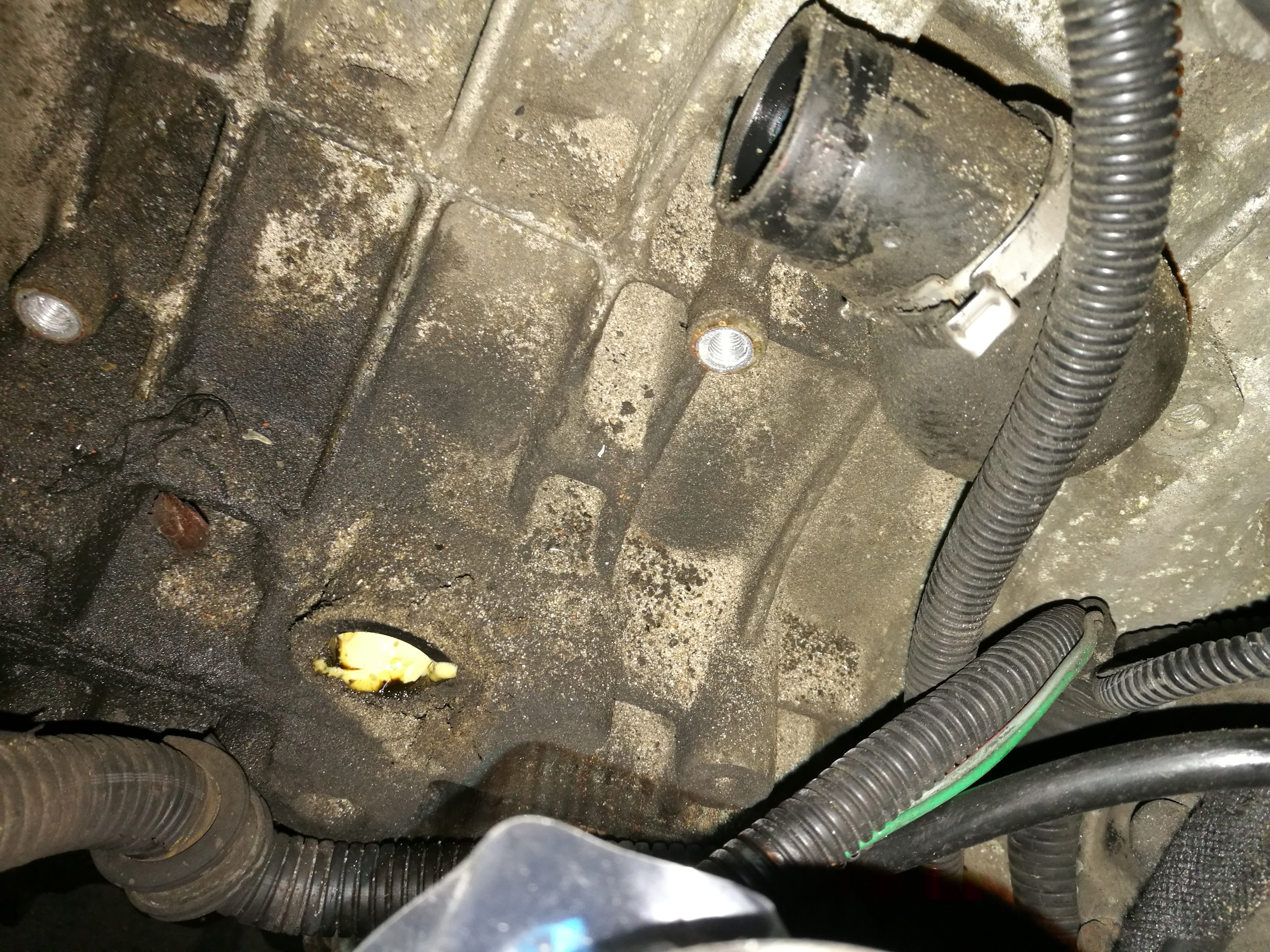

This is how the pcv looked

With that milkshake chris has nailed it, plugged channel in block.

Wow that's a lot of oil foam, especially for the topmost connection.
I'd start by making sure the drain port in the block is clean. It seems you have decent suction in the air hoses since you say you pass the glove test but too much oil in your pictures.

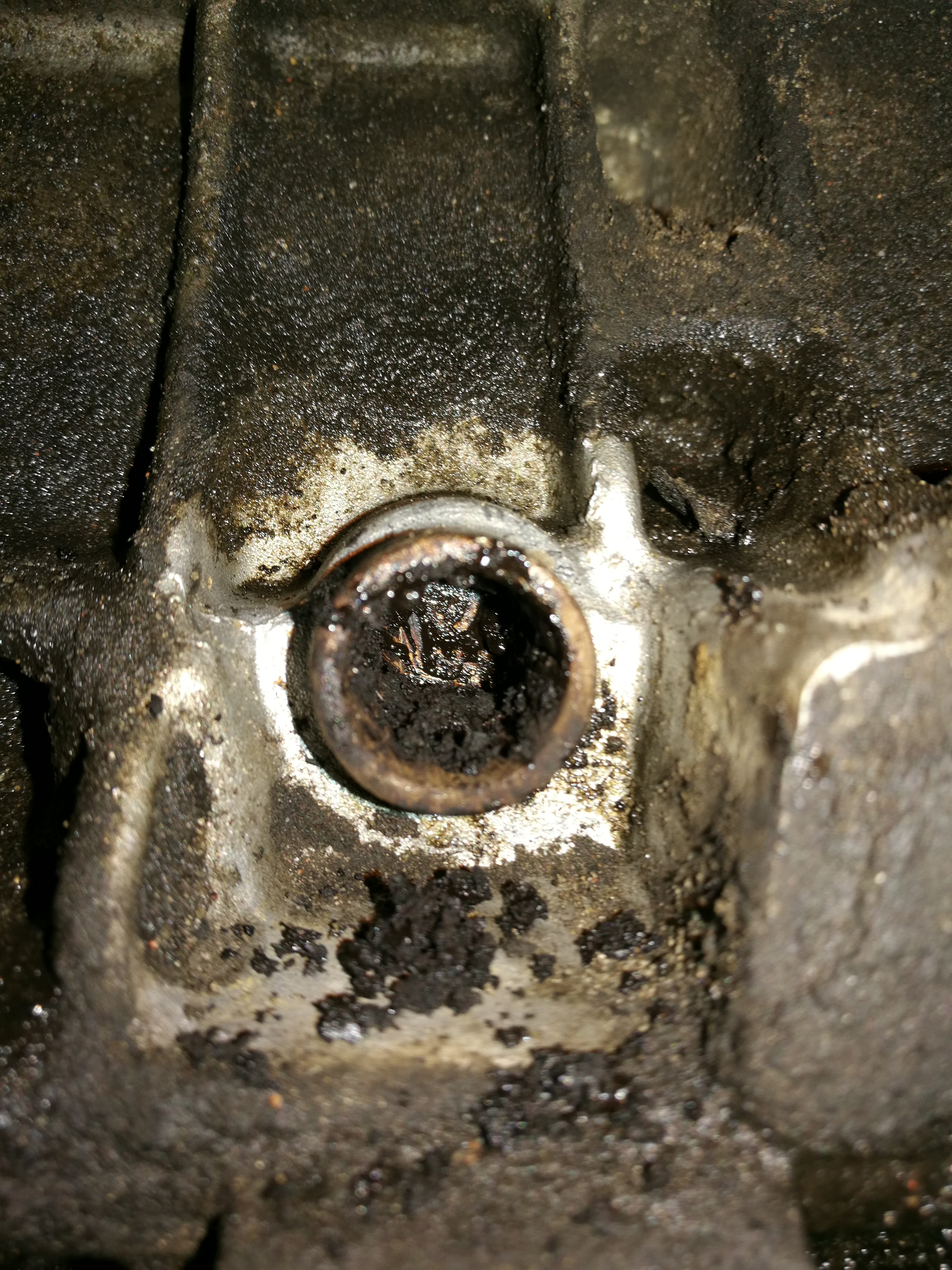

I cleaned lower drain port as good as I could.
I will be dropping the oil pan this week. Is it hard to do on this engine? Do I have to raise the engine a bit?

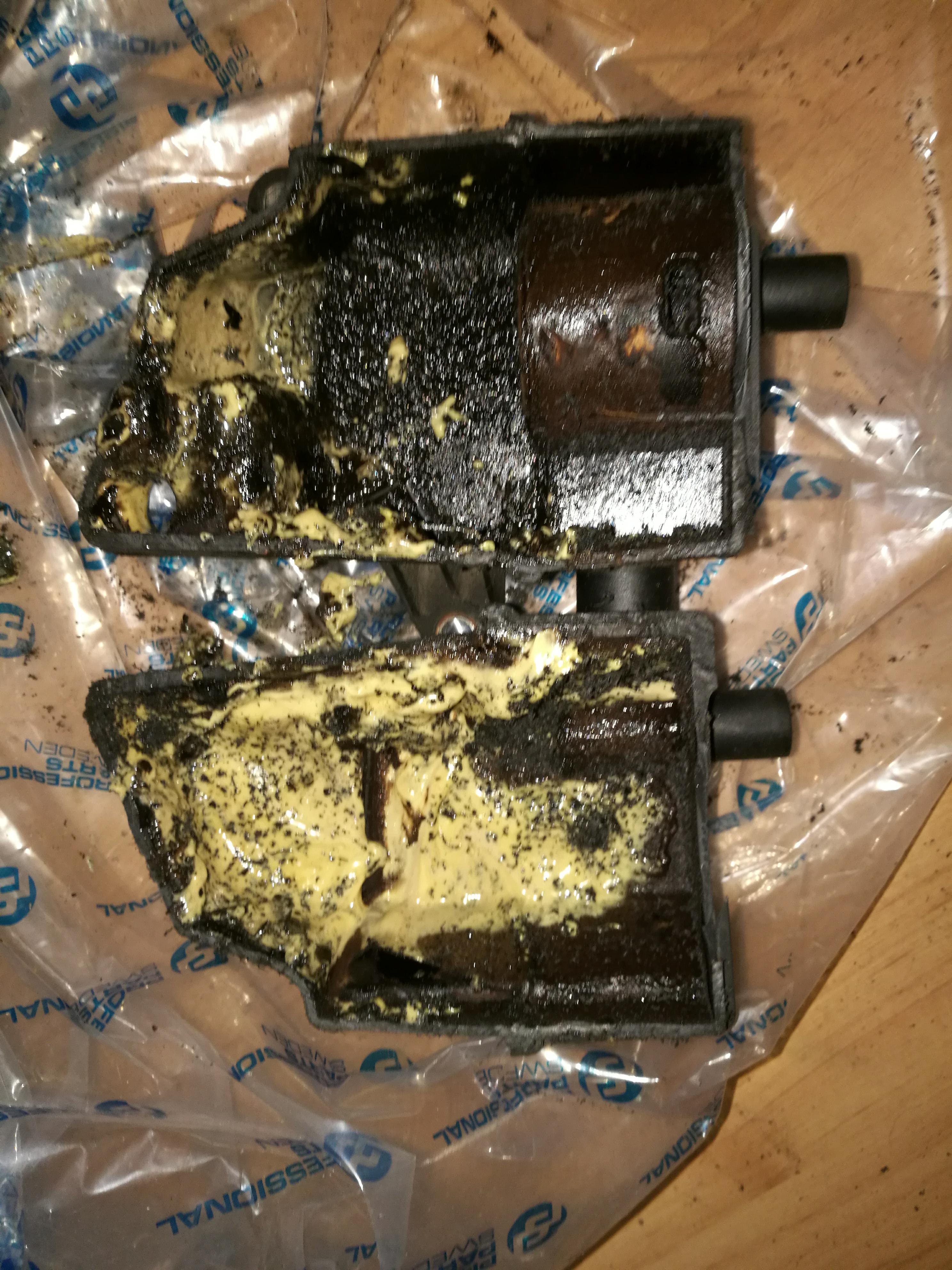

Brather cut in half (that black dust is from cutting):

Post by chrism »
Is it really necessary to drop the pan or is it OK to just spray a goodly amount of carb cleaner through the port and out the pan drain?
