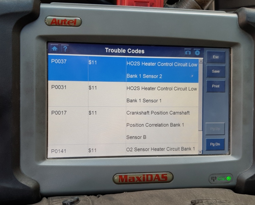

Help please. Bought 2003 Volvo XC90 2.5T yesterday. It has loping and surging of the engine at idle
(when running it is absolutely fine) with CEL; hooked up a scan tool which showed multiple codes (please find attached pics). There are no visible vacuum leaks but there is kinna hissing/turbo sound when flooring the accelerator. I am not sure where to start looking and there aren’t many good mechanics in Qatar other than the dealer.

Did you clear the codes to determine what DTCs are current and which ones are artifacts?
