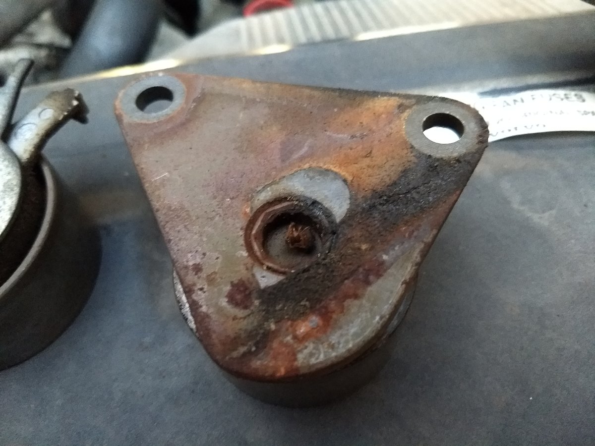

My brother (thewifes_s70) came by to swap the timing belt @ 182k miles in the '00 V70 I picked up a couple of months ago. It was the one thing I thought I should have done before spending any more money on it since the previous owner guessed it was last changed "somewhere around " 100k miles.

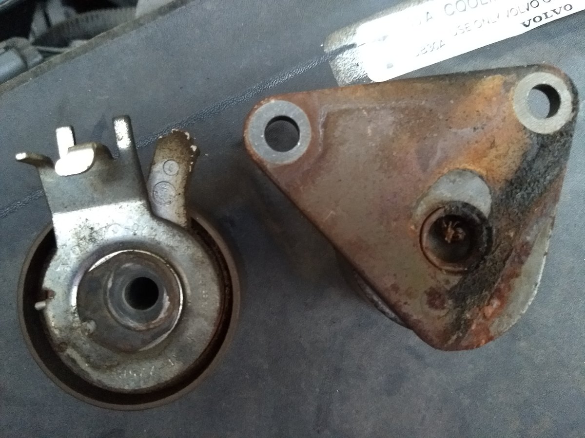

There was a Volvo-branded water pump (some white residue on it) and tensioner on it, and an INA idler. A bee had made its home (or tomb, really) in the back of the idler.

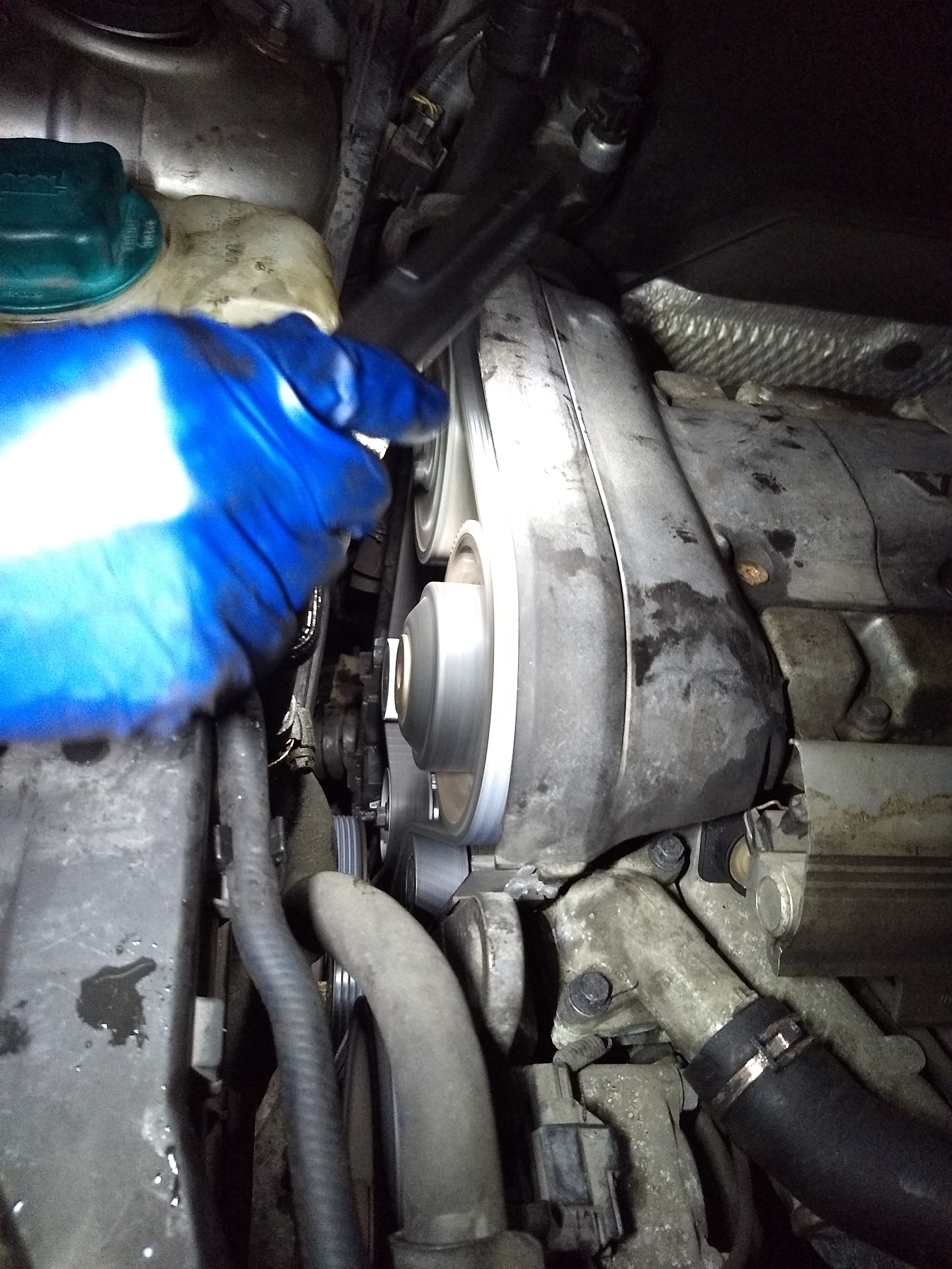

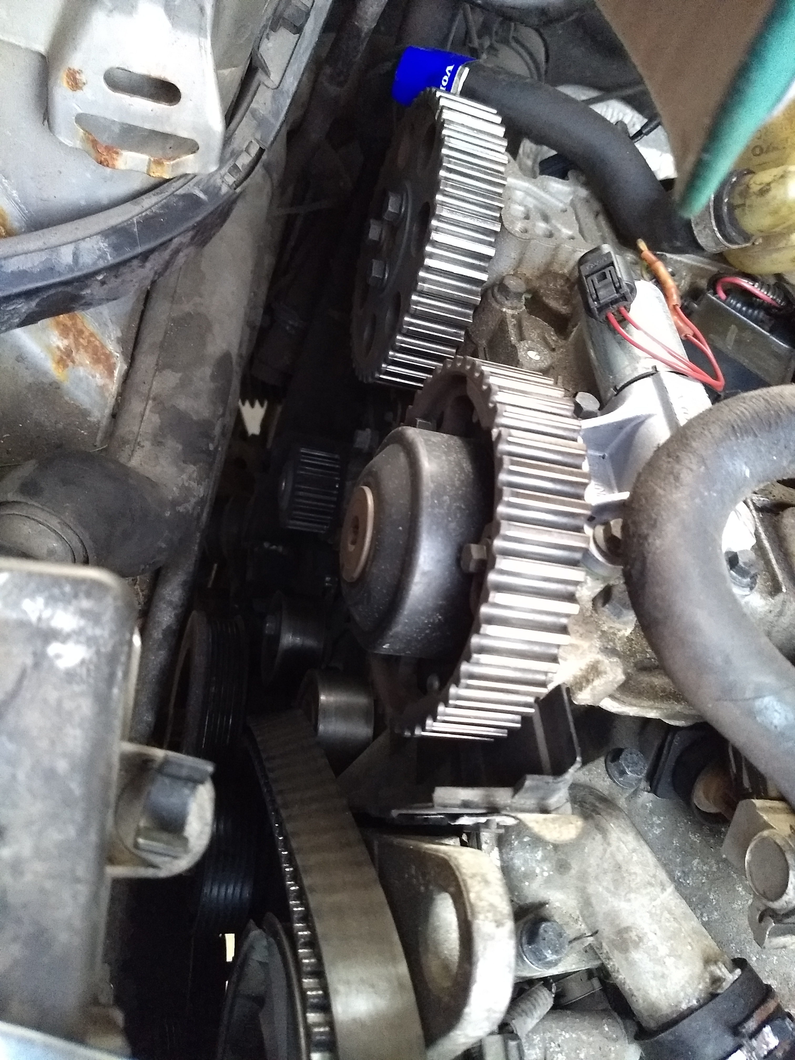

The job was made much faster with my xmas gift to him: A Milwaukee mid-torque impact wrench, which took the harmonic balancer nut off in seconds. Everything lined up well after a while and started up perfectly. Useful next time would be a dead-blow hammer to loosen the pulley, and a cam lock tool.

The cam locker is definitely helpful for VVT engines. It makes it a lot easier to ensure the VVT hub is preloaded properly.
