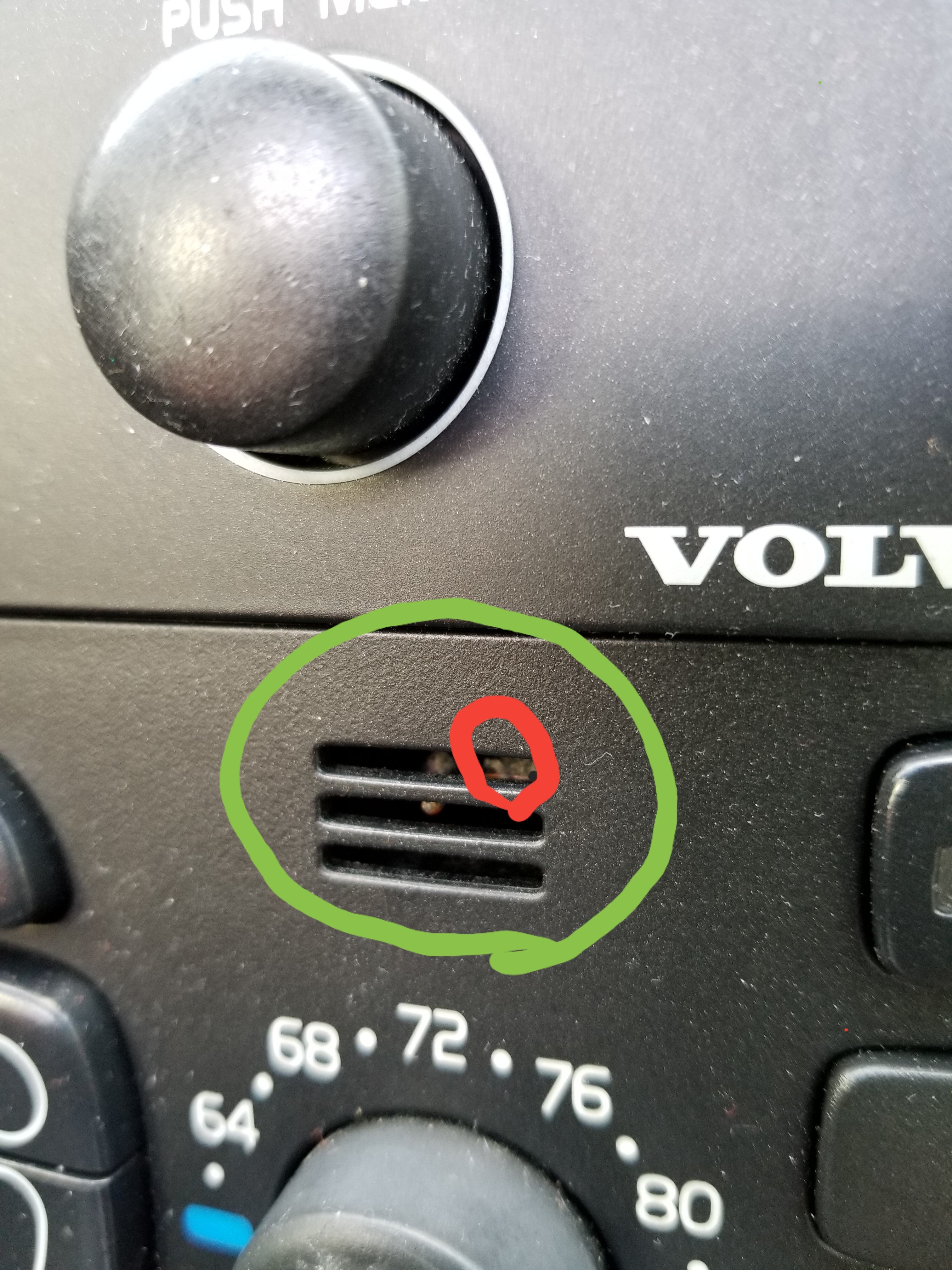

I was reading a thread on here where someone mentioned this sensor may need to be cleaned. Sure enough mine was full of fluffy stuff. Now for years my car only seemed to blow ice cold air out if the vents only on the hottest day like 100°, even set all the way to cold. Yesterday the outside temp reached 80° and even as the day cooled in the evening the vent temp stayed ice cold without the constant sound of the electric doors of the climate system changing position like they were hunting. How this sensor could cause such a profound effect, I can't say.
In the pic the red area is fluff I missed, green is the sensor area. June

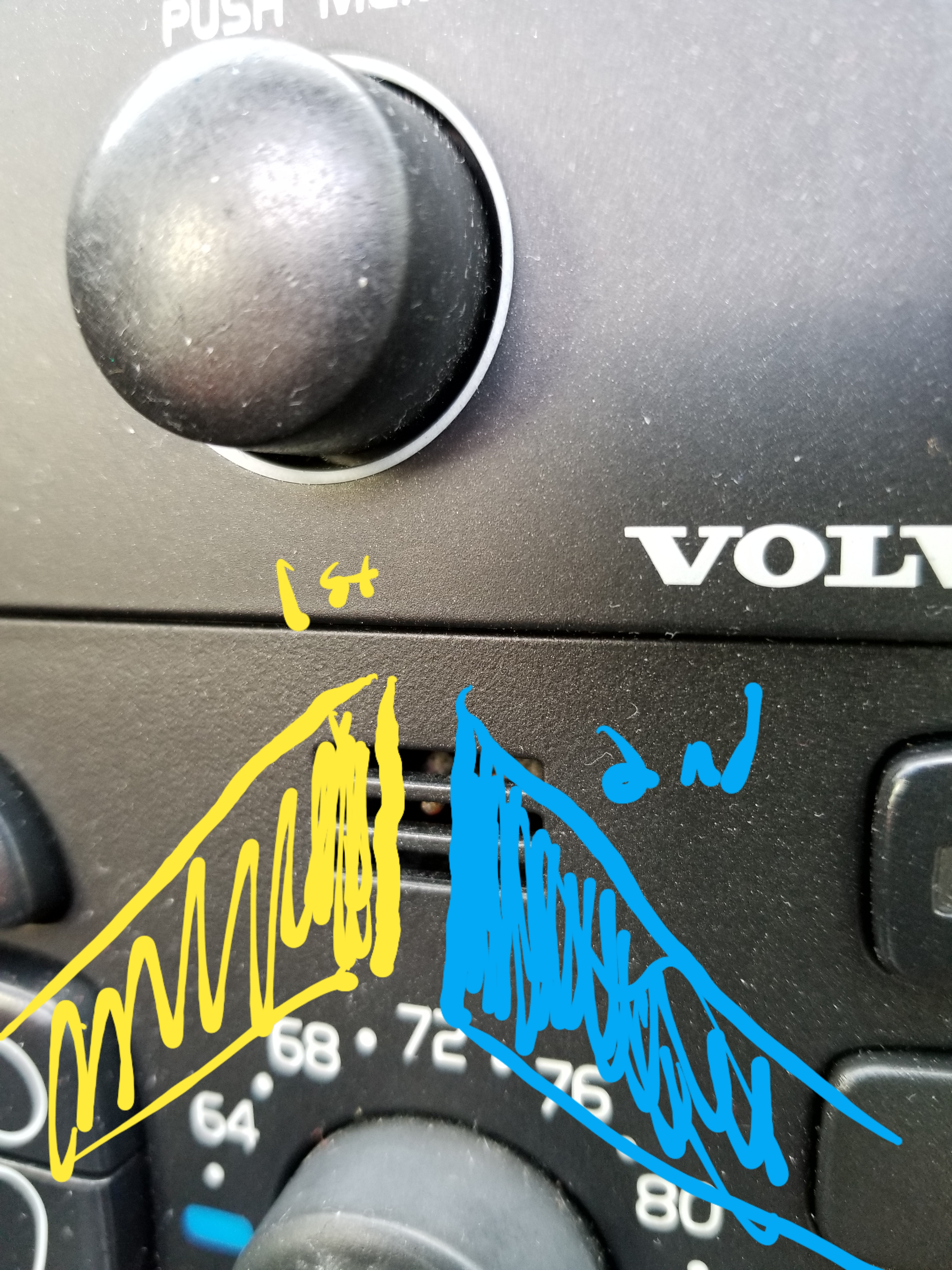

To anyone stumbling across this thread, be aware this sensor is considered fragile. Preferred method to clear it would be alternating between light/low pressure compressed air and suction from a vacuum hose. If you stick anything through those holes be extremely careful to pick away at the fluff that seems to accumulate there while not exerting pressure on the sensor element itself.

The best way would be to take the AC control panel out (it's quite easy) and cleaning it from behind. There's a small fan in the rear moving air across the sensor. There's more room to clean carefully from there.

I used the vacuum cleaner 1/2 at a time avoiding the center using the crevice attachment alternating one side than the other until all the visible fluff was gone. More has shown up from behind so my sensor was plugged good. June

Just a reminder to clean this sensor! Lately my A/C has not been cooling down right unless it's 100° outside. Then I thought about this sensor. I could not believe how much lint came out. I used a vacuum cleaner again and huge chunks came from deep inside. Now the A/C is back to normal again. So Jan 2018 to today it cloged again. JuneJune wrote: ↑23 Jan 2018, 07:13 I was reading a thread on here where someone mentioned this sensor may need to be cleaned. Sure enough mine was full of fluffy stuff. Now for years my car only seemed to blow ice cold air out if the vents only on the hottest day like 100°, even set all the way to cold. Yesterday the outside temp reached 80° and even as the day cooled in the evening the vent temp stayed ice cold without the constant sound of the electric doors of the climate system changing position like they were hunting. How this sensor could cause such a profound effect, I can't say.
