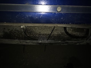

Teach me to look at this excellent site at breakfast! Out and busy several times cross country about 30 miles. Parked up at home off loaded tools to garage and saw transmission fluid leaking (dripping) under front sole plate. So off with front bumper after engine bay inspection and inspected hoses attaching to external trans cooler mounted in front of climate condenser. Conclusion splitting hose on return side at hose clip. Simple fix but saved me loosing fluid. - I just flushed it again before Christmas.
