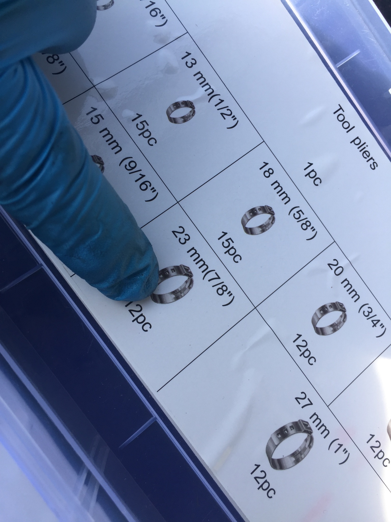

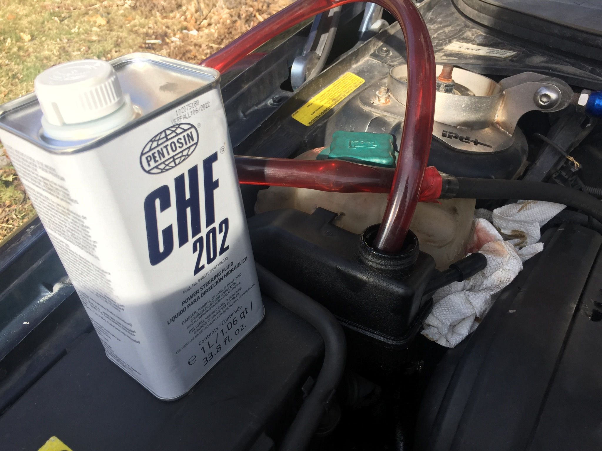

After a good session to replace my rear ABS sensor harness I caught a perfect 55F day to
Flush out my old ATF and replace the PS fluid with green Pentosin
Wrap and clamp an exhaust leak behind the cat ..worked like a charm.
18mm Oetinger clamp on the return line, 23 mm on the supply
