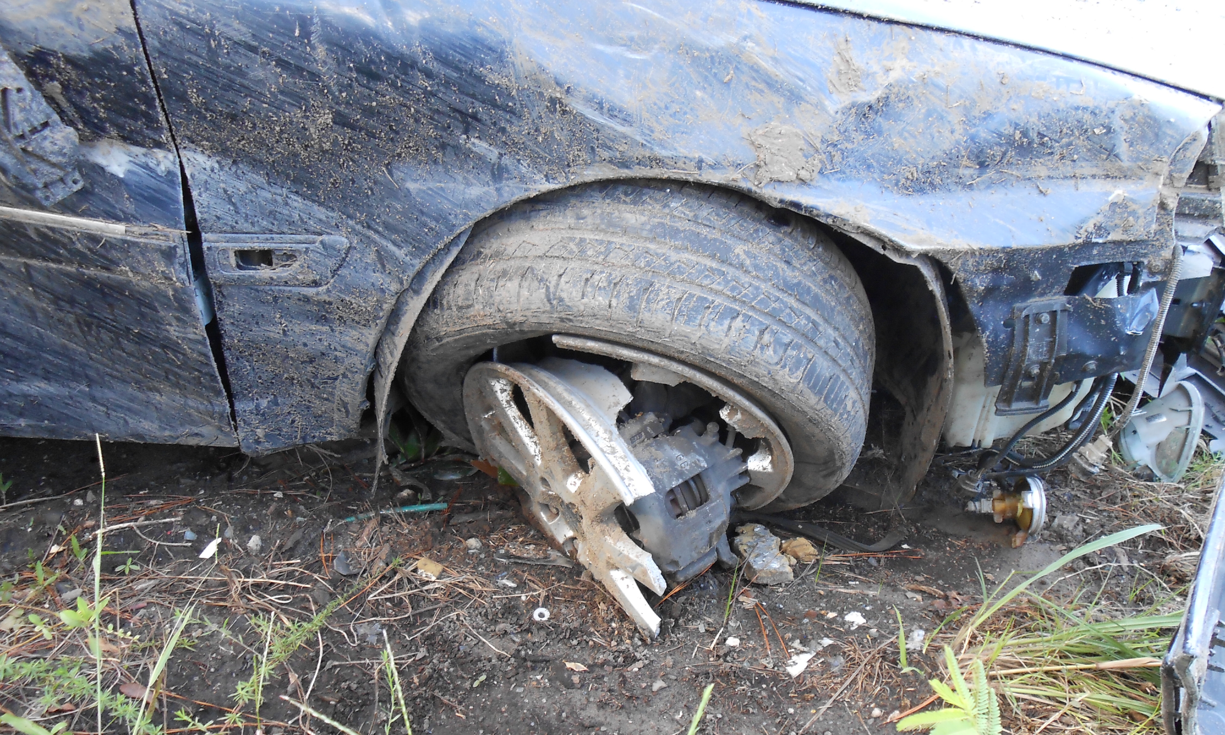

One thing to consider with the control arm is the aluminum original is made to break away in partial front collision. It is part of the safety designed to protect your feet. To put a part not designed to break away could one day cost you potential injury. Something to consider. +1 for OEM on this part.
Twice a Volvo has saved me death or serious injury, wrecks happen and you want the car to perform as designed. Here is a photo of the passenger side wheel of my 2002 S80 I totalled. Notice both the rim and control arm broke away. I fell asleep driving 3:30 AM and woke up hitting a light pole, jumping the edge of the interstate, taking out two oak trees, and finally rolling side over side out in a field. June

Did that buff out ok??

You can see how solid that fender is. Not only Volvo put a ton of paint on these, but the metal sheet is like on trucks. It barely dent.
