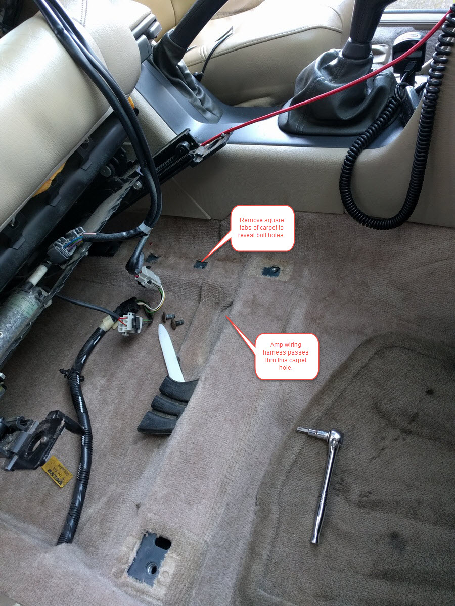

Some notes on installing the Volvo 9452029 amplifier in a 1998 V70. Easy job once you know about the hidden features and have the right parts. The carpet on the transmission tunnel pulled right out from under the various trim pieces and refit just as easily. As an audiophile, I can tell you that the sonic benefit is well worth the effort. If you have never removed your front seats go on Youtube and learn how to not trigger the side airbag before proceeding!

I actually never secured mine after installing, it's just stayed in place. Good to now about the bolt holes under the carpet... I'll have to punch those out and bolt it down!
I must say, your carpet is very clean!

What’s the red wire running by the seat? Is that the heated third seat option ?

Did we finally find a car with that option!?!?abscate wrote: 01 Feb 2018, 09:00 What’s the red wire running by the seat? Is that the heated third seat option ?

Red wire charges my cell phone.abscate wrote: 01 Feb 2018, 09:00What’s the red wire running by the seat? Is that the heated third seat option ?

Sssshhhh. Everyone will want one if we let the cat out of the bag.bmdubya1198 wrote: 01 Feb 2018, 09:29Did we finally find a car with that option!?!?abscate wrote: 01 Feb 2018, 09:00 What’s the red wire running by the seat? Is that the heated third seat option ?
