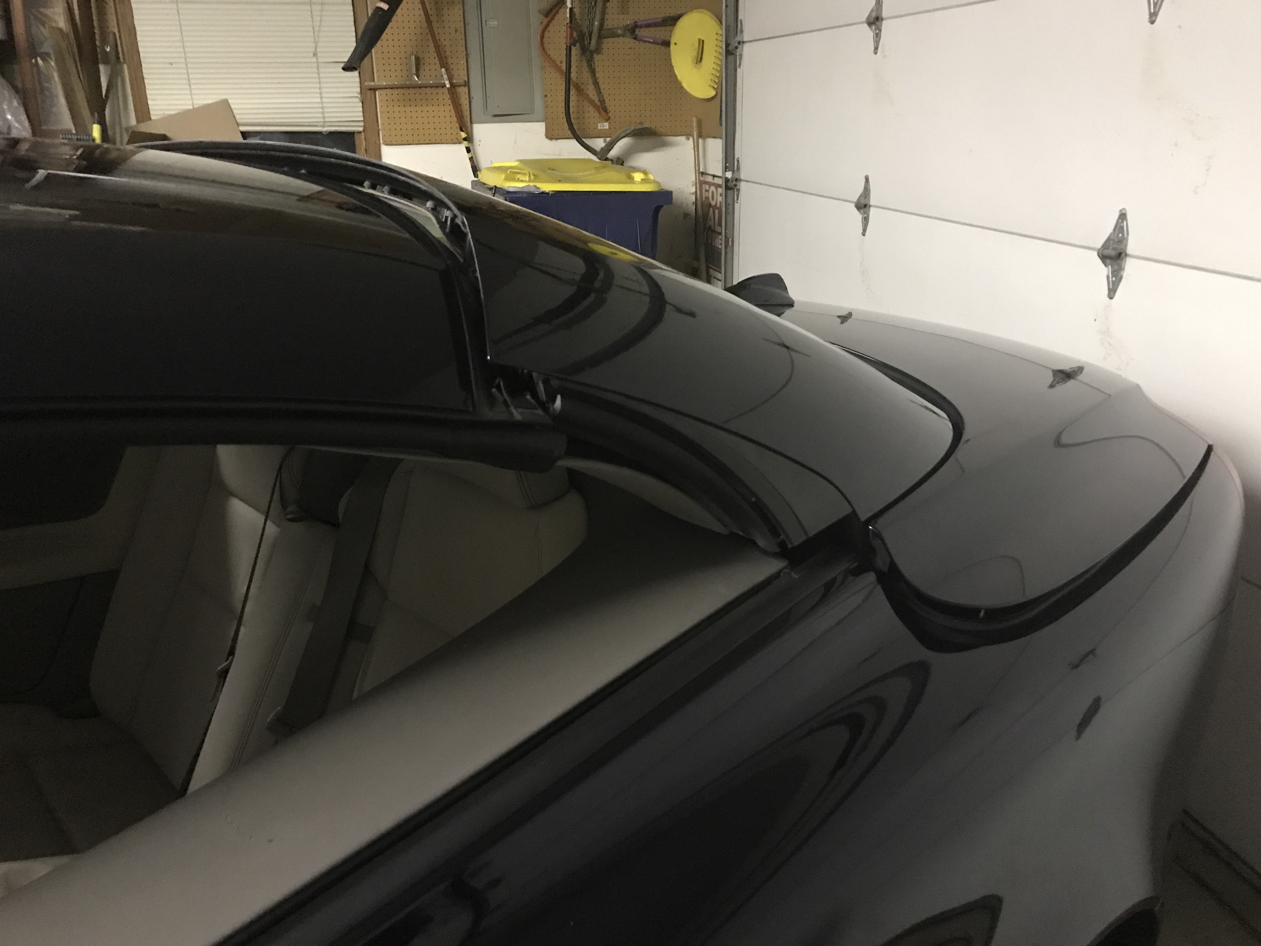

I pulled the “do not pull” hydraulic release lever and now my top will not latch. The rear panel is not latched to the car and the trunk deck is not seated either. Help! I’m stranded with 3 kids and no backup car.

I cannot tell you exactly how to get it closed but the general process is in the attached file.
It looks like a four person job to do it manually.
