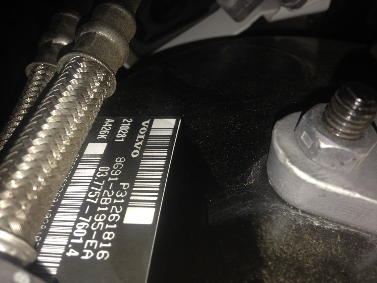

I want to make sure I get the right replacement booster.
Start by positively identifying the booster to be replaced.
Get the Volvo part number off the Booster. It will be in the format 31274XXX, 31302533 or 31329898.

No Volvo part number 31261816 in the database.
The closest number I could find is Volvo part number 31261819 which is an XC90 fuel pump.
You sure the only number on the booster?

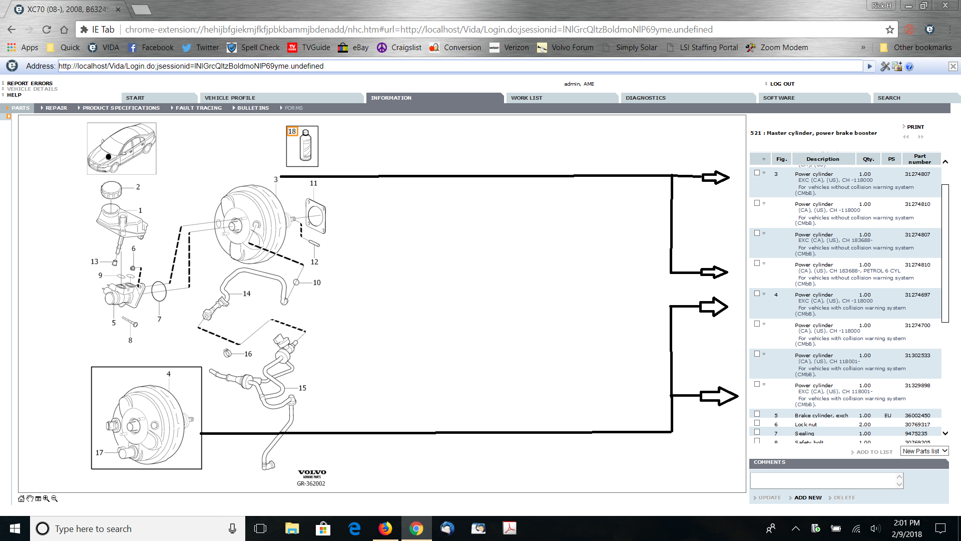

Put your VIN number into the Volvo Parts Lisle web engine and you will nail it. Save your account and you don't have to do that again.
there appears to be two groupings of brake boosters for XC70 cars w/o collision brake assist, those with asbestos brake pads and those without asbestos brake pads. Does anyone know why there is a difference based on asbestos pads?

Weird, the only reference to Volvo part number 316261816 that I can find is on a couple of Russian websites for used parts.

It looks like there are parts numbers for CA US, without and without collision warning, plus a chassis break number, so six part numbers - of which one will be right for your car.
If you put your VIN into the Lisle site - that will help
