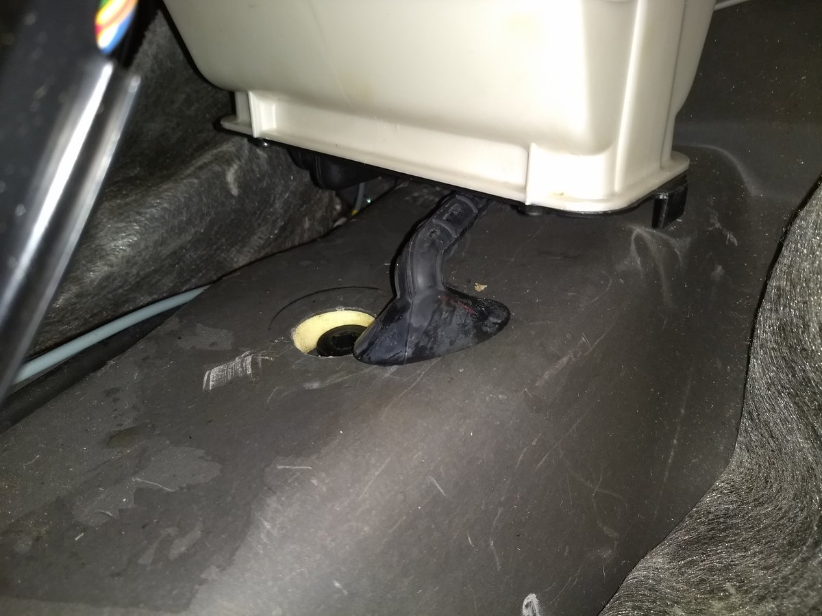

Manged to flush the coolant in the '98 V70, swap some hoses and reservoir, and replace the original heater core (manufactured in 1997!) with one from Swedish Parts today. When accessing the heater core box, I noticed this hose that leads from the firewall to the floor was broken at the floor.
Might try some Gorilla tape, or maybe JB Weld to reattach the coupling end to the floor tube.

That's the climate unit condensate and rain drain, so make sure that's going out under the car or else you will be soaking it into your floor padding
I think it is just a press fit on the floor pipe?

Yea, you should be able to just push it onto the tube.

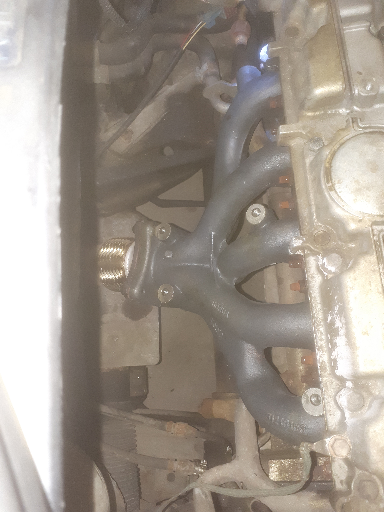

I was allowed the use of a heated garage with a lift for a few hours today. Sure beats having to work on the car in the driveway in -2C/28F.
I bolted on a new exhaust manifold, now the complete exhaust is less than 2 months old from the engine and all the way back
I located the manifold in Holland, manufactured in Sweden by Volvo OE supplier and it was a perfect fit. I almost felt like it was a shame to hide it underneath the slowly detoriating heat shield, but now I can hear the injectors at work instead of the exhaust leaking through the cracked manifold.
Next up is to remove the intake manifold and hunt down the bad connection to the front knock sensor, I'm so not looking forward to it. (It took 30 minutes to burn off the protective coating from the manifold when I had finished putting it all back together)
