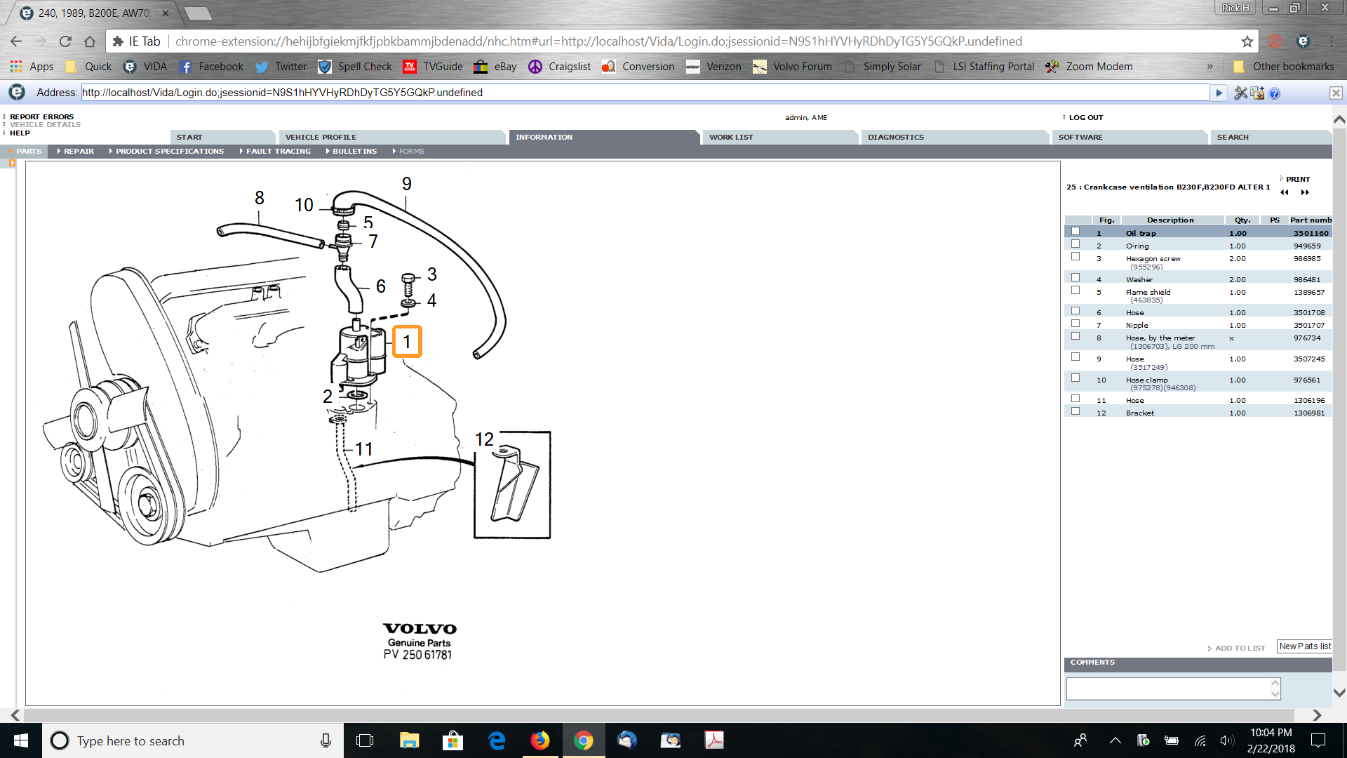

I have the 2.3. The crankcase ventilation was serviced a year ago because the crankcase pressure got so high that it blew out the rear cam seal and dumped out like a quart of oil. Replaced the oil separator/breather box, rear camshaft seal and cleaned out the flame trap. Are there any other parts that should be cleaned or replaced?
