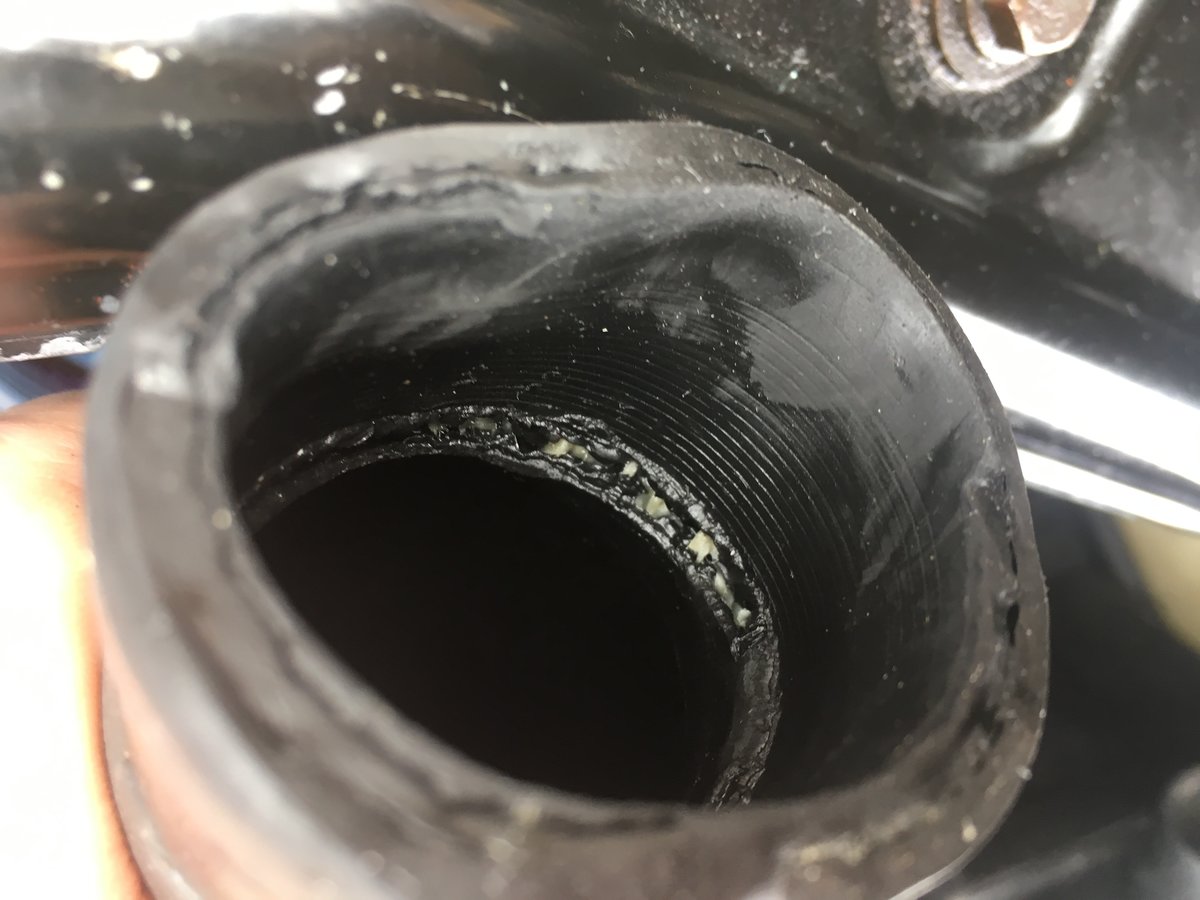

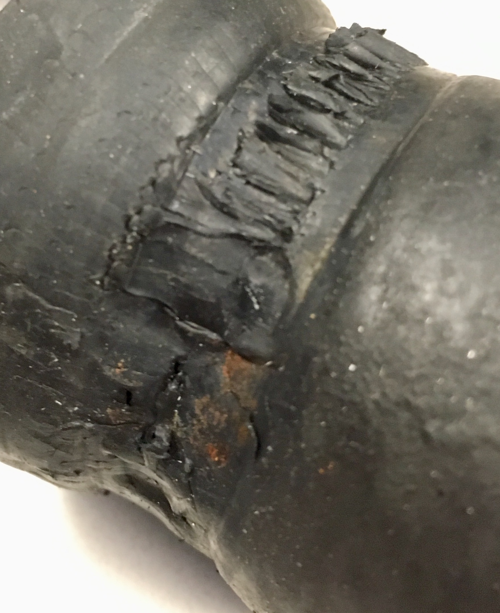

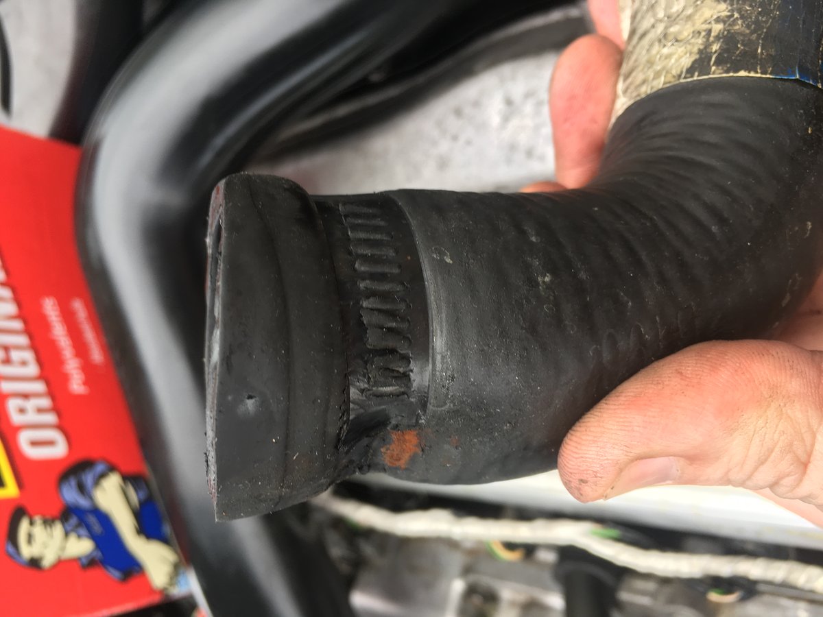

I've traced down a coolant leak to a perforated upper radiator hose. It's not obvious from these photos, but the welts left by the hose clamp do run all the way through, and when coolant pressure gets particularly high, coolant begins to leak from this area.

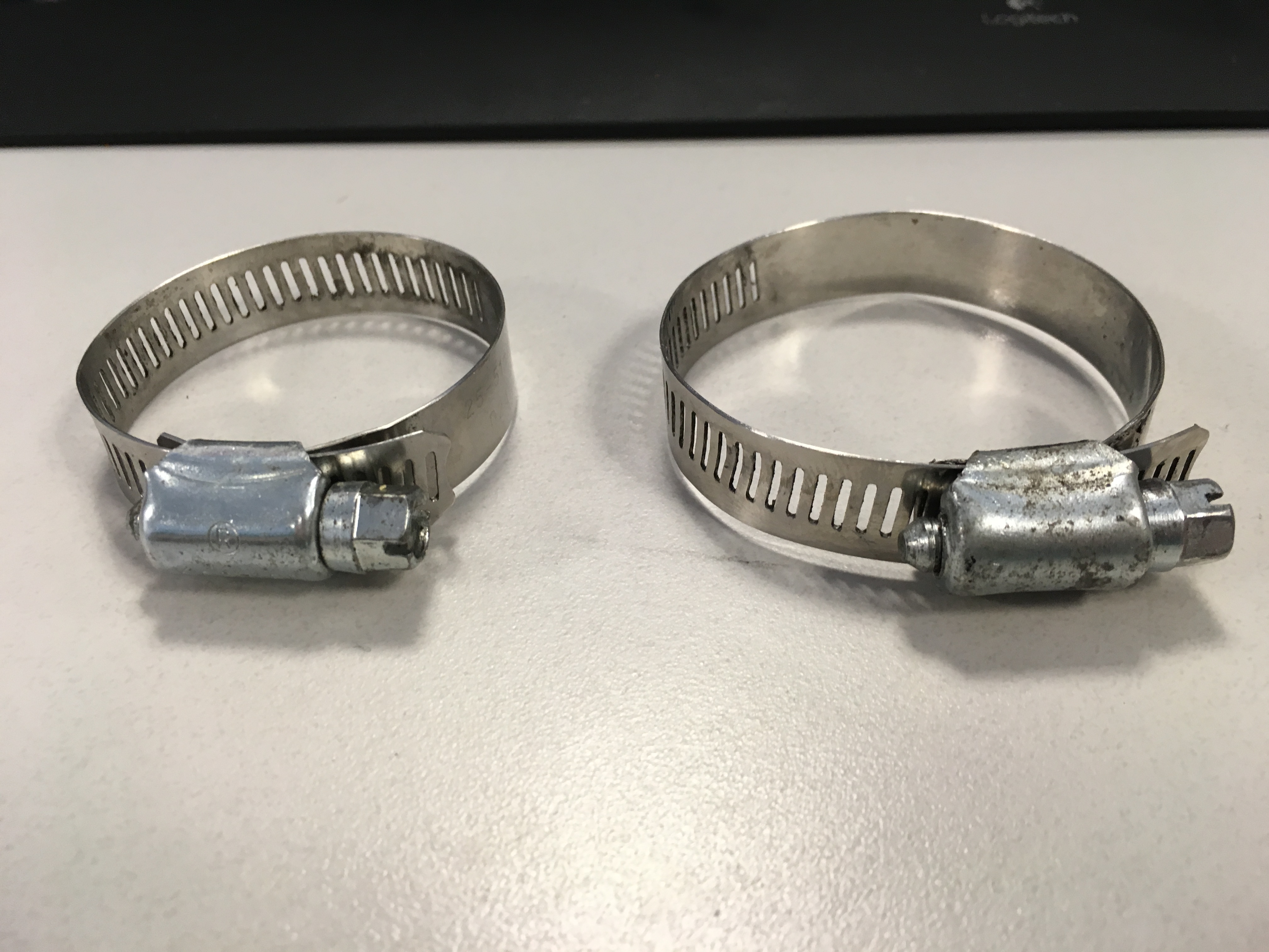

The hose I'm currently using is a Carquest / Dayco hose from Advance Auto Parts: https://shop.advanceautoparts.com/p/car ... 19590400-P It is attached with two off-shelf hose clamps also from Advance. I'd like to be sure I replace this with good-quality components. Is Genuine Volvo my only choice, or is there an OE/OEM brand that would have equal quality?
FCP Euro has the Genuine Volvo radiator hose for $52 https://www.fcpeuro.com/products/volvo- ... -9492889oe and the Genuine Volvo clamp is $4 https://www.fcpeuro.com/products/volvo- ... amp-988030
FCP also has an "OEM" hose from Rein for $5.49, but I'm questioning its quality at only 10% of the Genuine Volvo price https://www.fcpeuro.com/products/volvo- ... 60-9492889
Any suggestions?

I traditionally like to go with the Volvo brand or the OEM sub-supplier, but for a 17 YO car, I'd chance the Rein at 10% the price of the Volvo brand.
I'm still running my original upper radiator hose, so they do last. If you think you will have your V70 for another 10 years, drop the coin and get the Volvo brand. Do it once and forget about it.
Your bigger issue may be the clamps you were using...

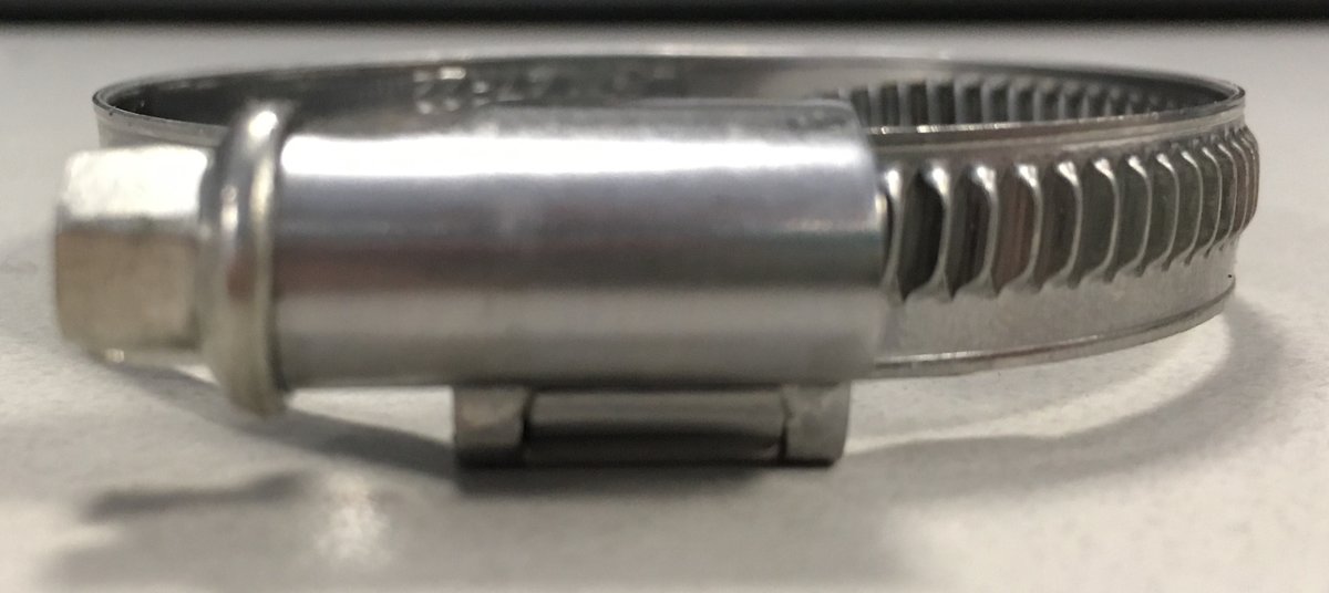

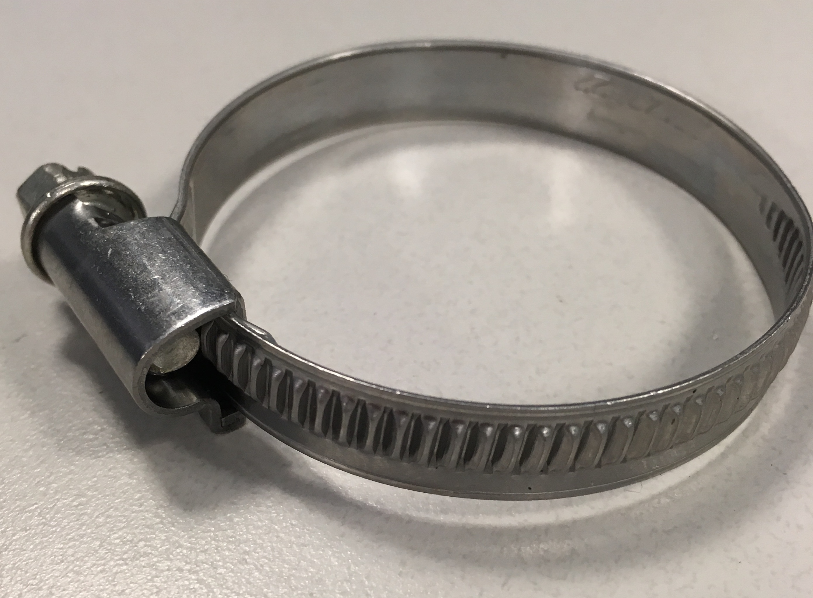

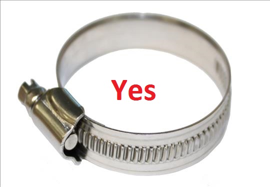

I'd go with a used Volvo one from scrap yard, these rarely go bad even old. I remember a thread about a owner who put Ipd or like such aftermarket = leaks. As mentioned, the clamps must be the worm type, I got a bunch of these from the scrapyard as well.

Peter..it almost looks like your clamp wasn’t on the actual snout of the radiator but was crushing the hose? Is that possible? It sure would leak being crunched on the edge of the snout
- prwood
- Posts: 689
- Joined: 02 Oct 2015, 09:24
- Year and Model: 2001 V70 2.4T
- Location: Salem, Massachusetts, USA
- Has thanked: 9 times
- Been thanked: 22 times
Quite possible. The snout is at a weird angle and very difficult to get the hose clamp around in the proper position while also leaving the screw accessible for tightening.abscate wrote: 27 Feb 2018, 08:01 ...and Horatio of course

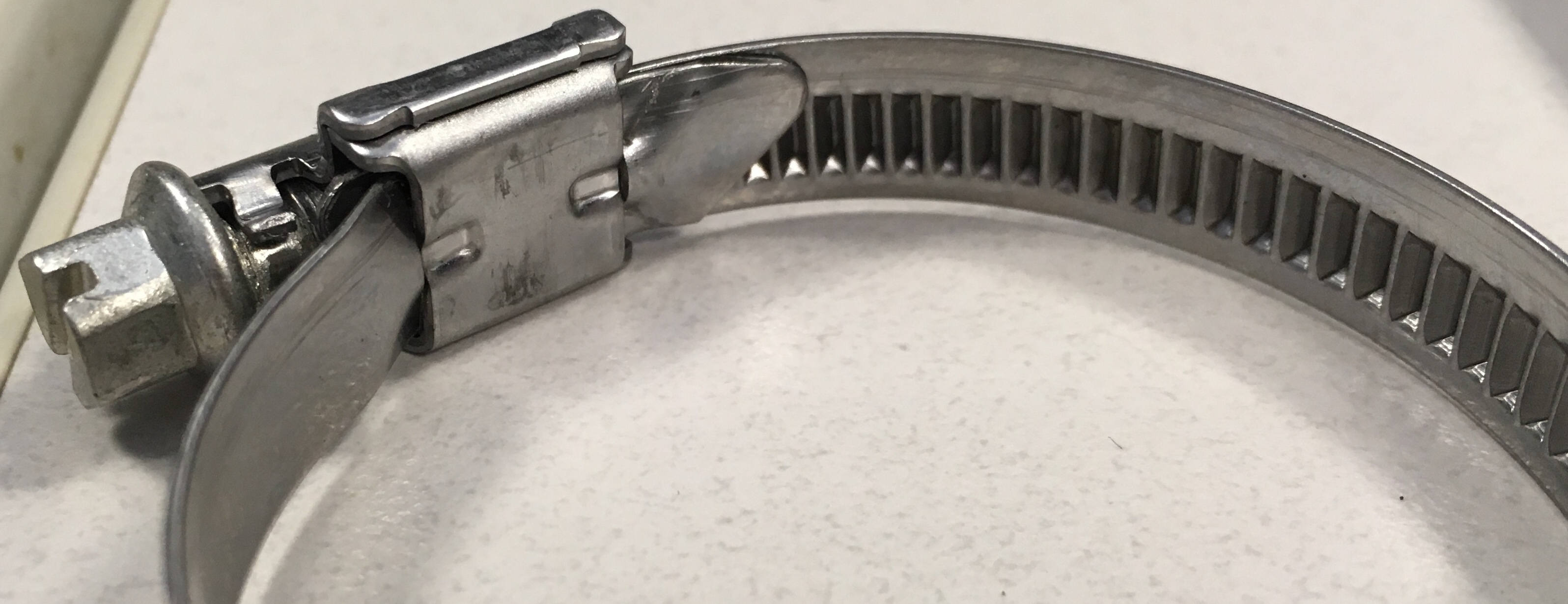

I went over to Volvo Village Danvers' parts department and got the proper hose clamps. Today was the first day they addressed me by name without asking, so that's a milestone to be proud of, I guess.
I'm planning to clean the hose and then wrap it in silicone tape, with extra around the clamp areas, and see how well that holds up for now, with the proper clamps. Of course I will need to make sure not to wrap too tightly, since the hose does need to be able to expand with the hot coolant. The silicone will expand to a point, but less so if I pull it extremely tight when wrapping.
Some more photos for fun.

That does not look like an OEM radiator, no metal insert in the snout to keep it from deforming.
