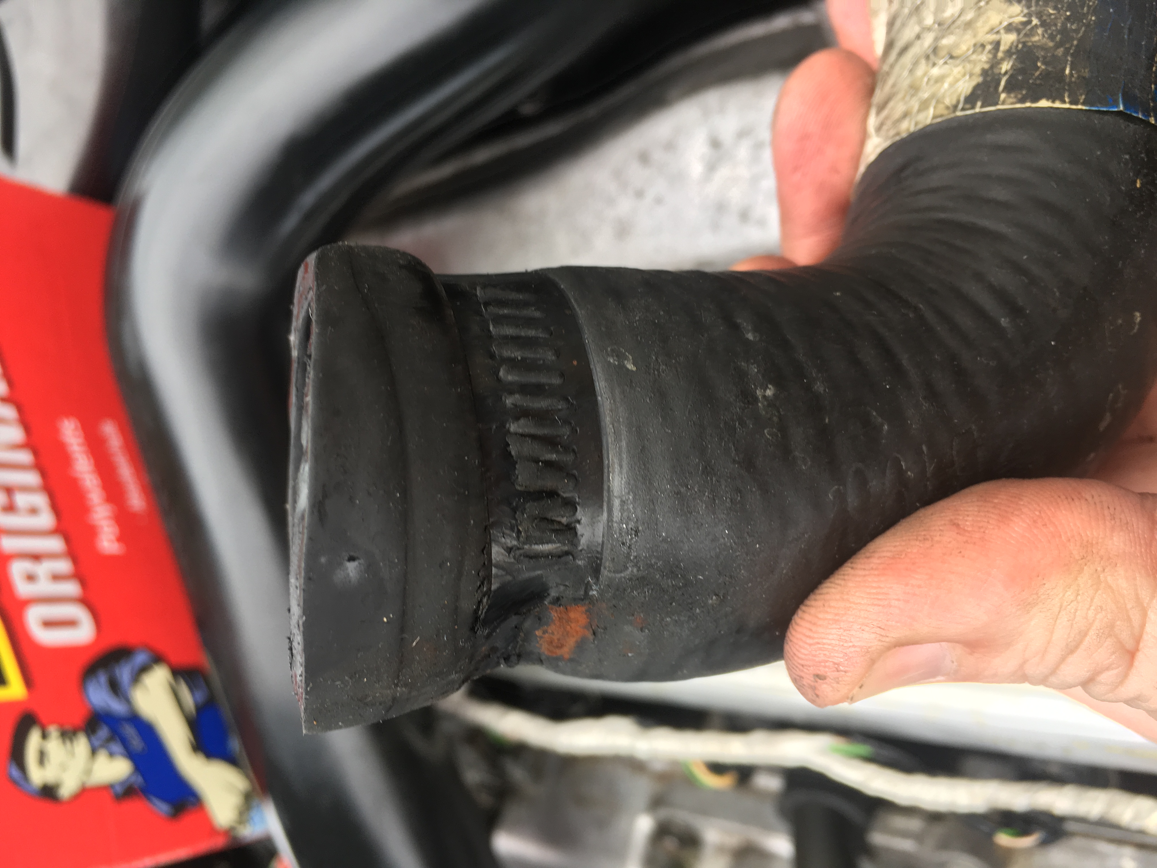

I've traced down a coolant leak to a perforated upper radiator hose. It's not obvious from these photos, but the welts left by the hose clamp do run all the way through, and when coolant pressure gets particularly high, coolant begins to leak from this area.
The hose I'm currently using is a Carquest / Dayco hose from Advance Auto Parts: https://shop.advanceautoparts.com/p/car ... 19590400-P It is attached with two off-shelf hose clamps also from Advance. I'd like to be sure I replace this with good-quality components. Is Genuine Volvo my only choice, or is there an OE/OEM brand that would have equal quality?

Peter..it almost looks like your clamp wasn’t on the actual snout of the radiator but was crushing the hose? Is that possible? It sure would leak being crunched on the edge of the snout

Quite possible. The snout is at a weird angle and very difficult to get the hose clamp around in the proper position while also leaving the screw accessible for tightening.abscate wrote: 27 Feb 2018, 08:01 ...and Horatio of course
I went over to Volvo Village Danvers' parts department and got the proper hose clamps. Today was the first day they addressed me by name without asking, so that's a milestone to be proud of, I guess.
I'm planning to clean the hose and then wrap it in silicone tape, with extra around the clamp areas, and see how well that holds up for now, with the proper clamps. Of course I will need to make sure not to wrap too tightly, since the hose does need to be able to expand with the hot coolant. The silicone will expand to a point, but less so if I pull it extremely tight when wrapping.

That does not look like an OEM radiator, no metal insert in the snout to keep it from deforming.
