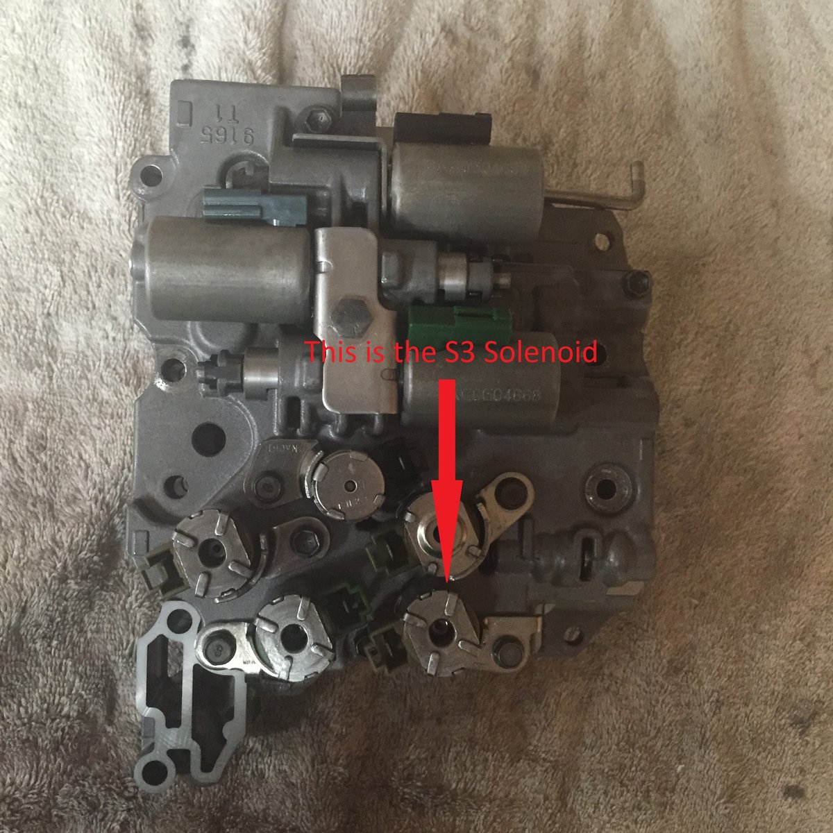

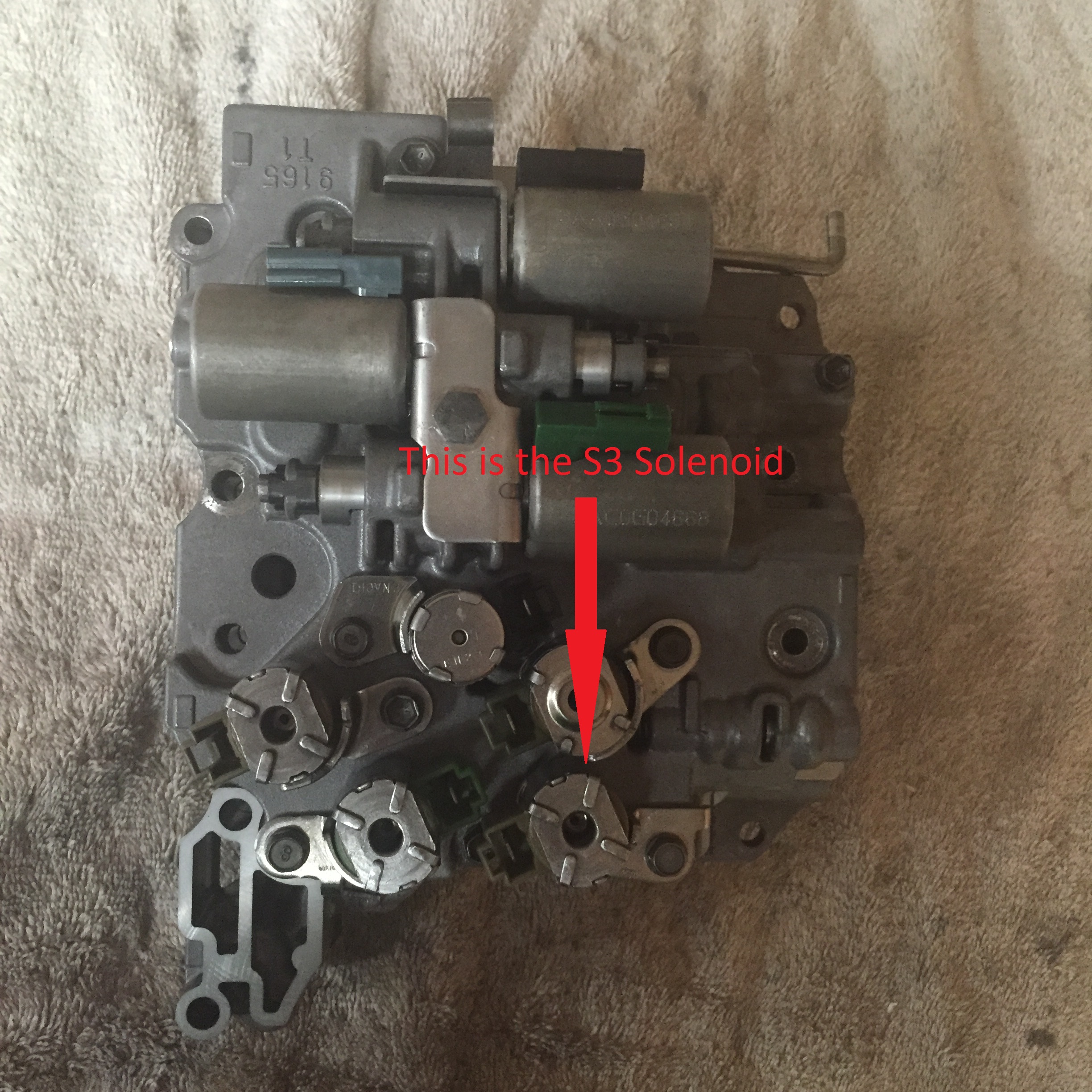

In neutral, all solenoids are off. Park is the same, but with a pawl engaged. In reverse, S3 is on, all others off. So we know S3 isn't working properly. The only forward gears that don't need S3 are D4 and D5, so I'd expect the wheels turn but it would take a lot of revs to do so.

Automatic transmissions are hydraulic machines. Hydraulic pressure is routed through a complex series of valves (the valvebody) to push clutch packs together and apart as needed to obtain the desired gear or drive ratio. Your transmission is either failing to operate the valvebody properly (perhaps due to a stuck S3 solenoid) or the valves operate but a clutchpack is so broken that it cannot be disengaged.
I'd recommend checking S3 as that fix is simple enough. If it's not the valve body, only a full rebuild of the transmission will fix this. Honestly, having done a partial rebuild on an 01, it's not worth it. I later bought the best 02 gearbox I could find, cleaned that up and put it in. Shifts beautifully now.

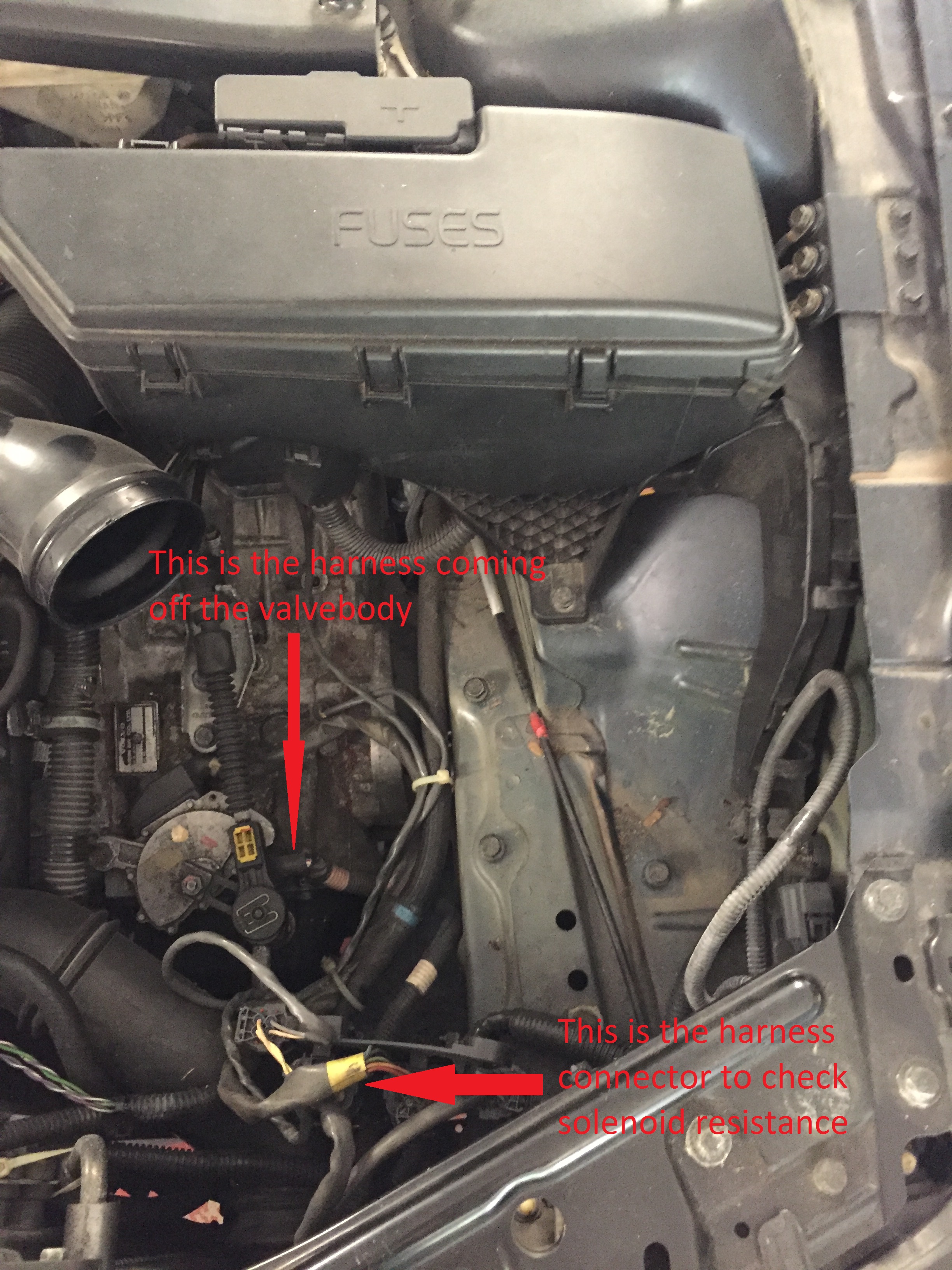

To check the S3 solenoid, disconnect the large gray connector coming from the transmission wiring harness. Check the pin corresponding to the yellow wire. Resistance to ground should be 13.5-15.5 ohms at room temperature. Hard short or open indicate a failed solenoid. Good news, that's the easy fix.
