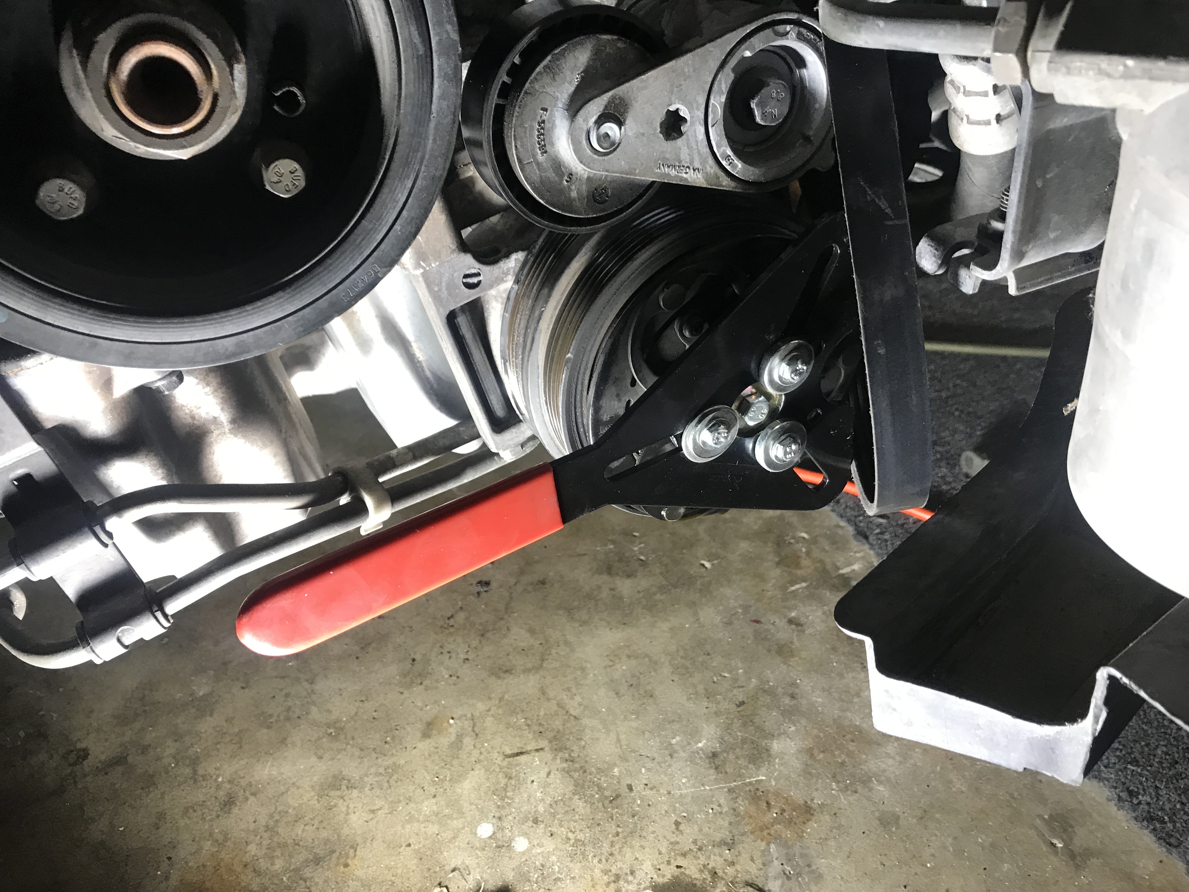

Changed a very noisy AC clutch bearing

kallekula wrote: 17 Mar 2018, 21:17 Changed a very noisy AC clutch bearing
Im not sure if you are aware or not, but your engine looks factory new. How.......

ZionXIX wrote: 18 Mar 2018, 06:38
wizechatmgr wrote: 17 Mar 2018, 23:02 Darn that block is clean =)
That is incredibly clean!

bmdubya1198 wrote: 18 Mar 2018, 07:59
I recently did a bigger job on the engine which included taking the oil pan off. Had it cleaned by the machine shop while they were doing the head. Looks pretty nice I guess, never thought about it. I only care about it being clean on the inside :)

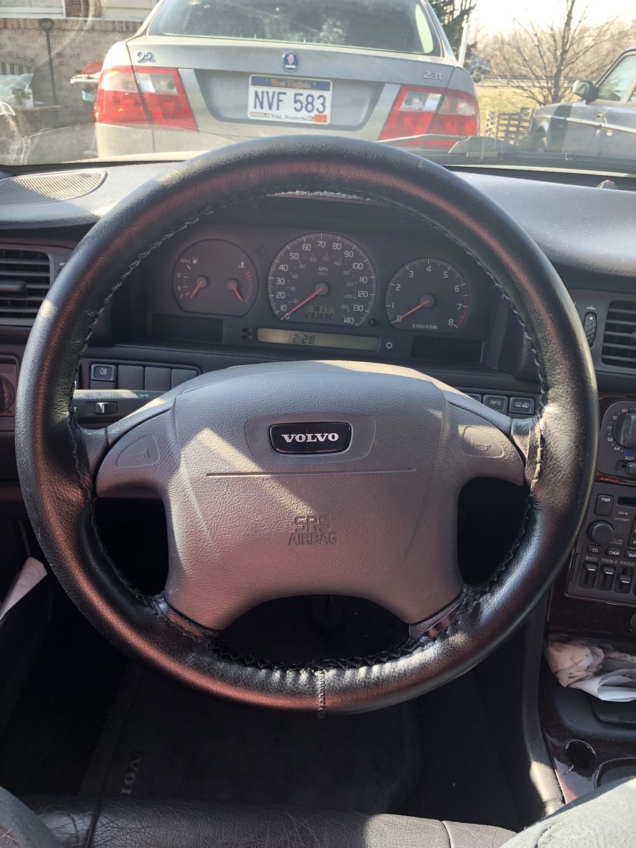

Rigged up a cover for my clapped out steering wheel.
