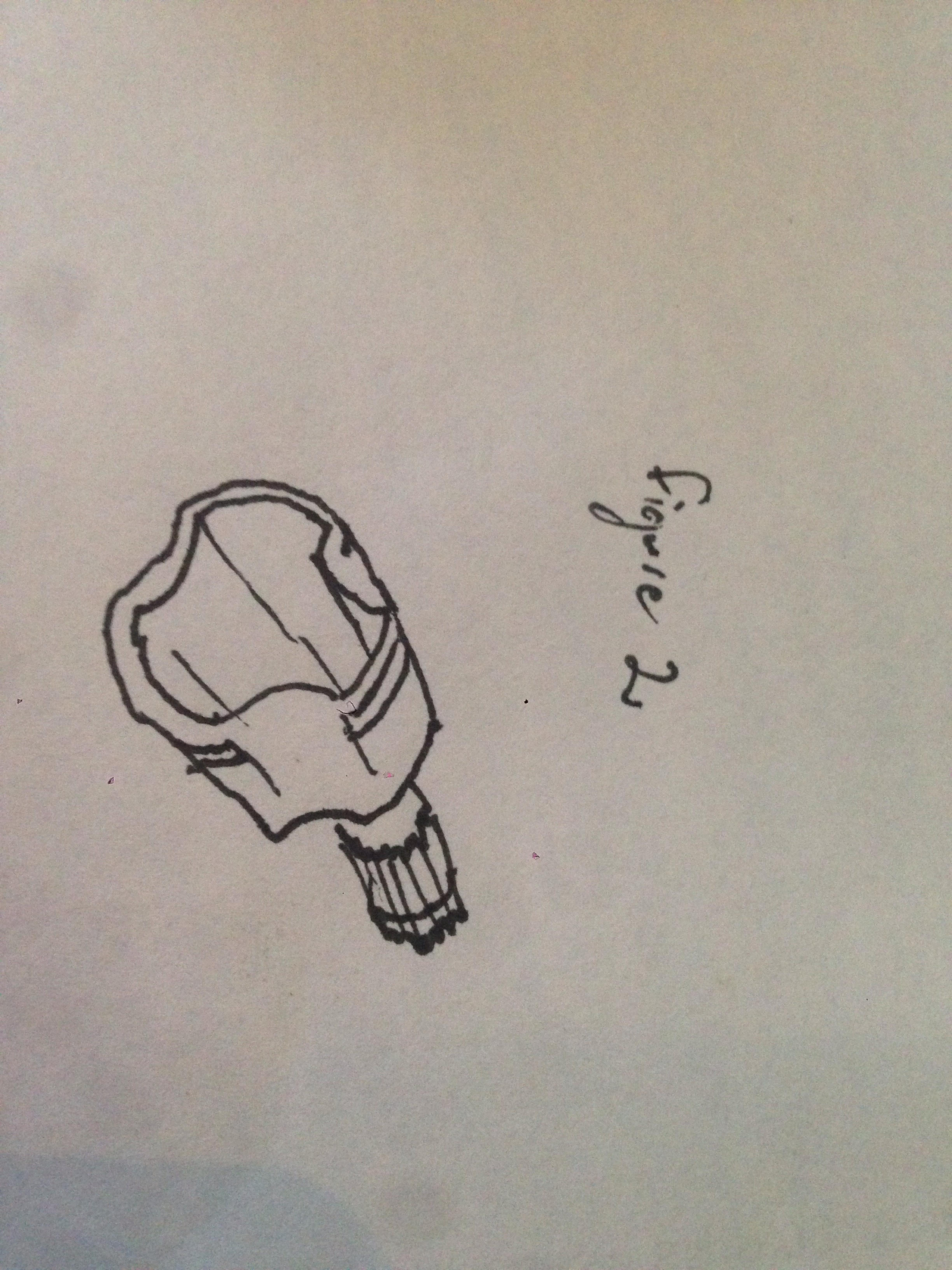

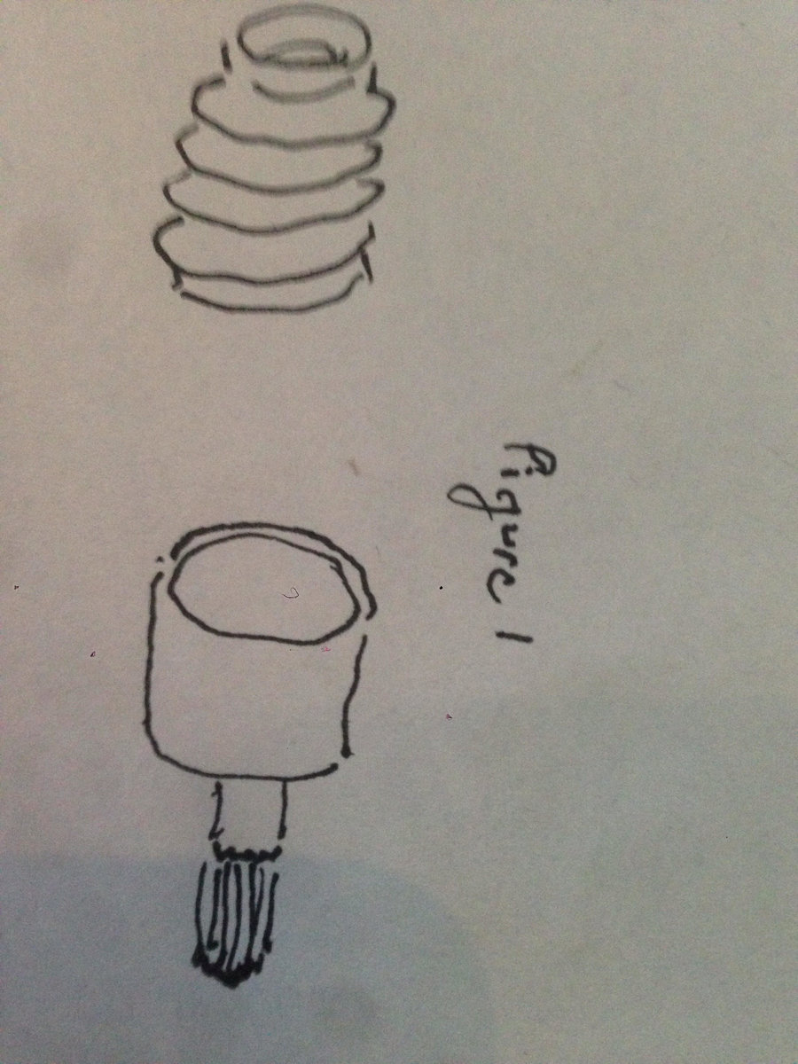

OK, so the CV boot on my drivers side subaxle is toast, and I'm looking for a replacement, but in my research it looks like the retaining gasket(?) is incompatable with all the boots on the market? I'm talking about the sleeve that the bearings slide into, that has the toothed pinion that meets the transmission - everything I see online is a circular sleeve .. but mine is weirdly crenulated, like it was crimped to guide the bearings! As much as I like the design, it doesn't leave a circular opening for a new boot to sleeve onto without 3 large gaps..
(Also, I assume my description is inadequate, I'm only passingly educated in the terminology for these components, Attached are some drawings of what I'm talking about - I'd take pictures, but I *JUST* put my wheel back on for the 4th time this weekend, kind of done being under the car for a while! ((But if no one knows what I'm talking about, I'll crawl under there again and take a picture :roll: )) )
Figure 1 is what a normal axle sleeve looks like
Figure 2 is what my axle sleeve looks like
Am I out of luck, and need to buy a new subaxle? Is there any place to buy boots to fit this sleeve?

Also, the tripod plunger design (figure 2) is a standard cv joint, there should be a rim at the end that the boot will clamp on to.
Figure 1 is also known as a Rzeppa joint. That is the one that uses a cage and several ball bearings to allow axial movement and still transmit the torque.

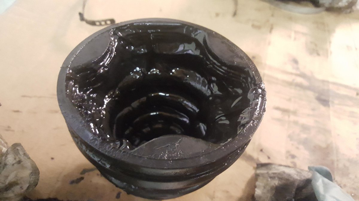

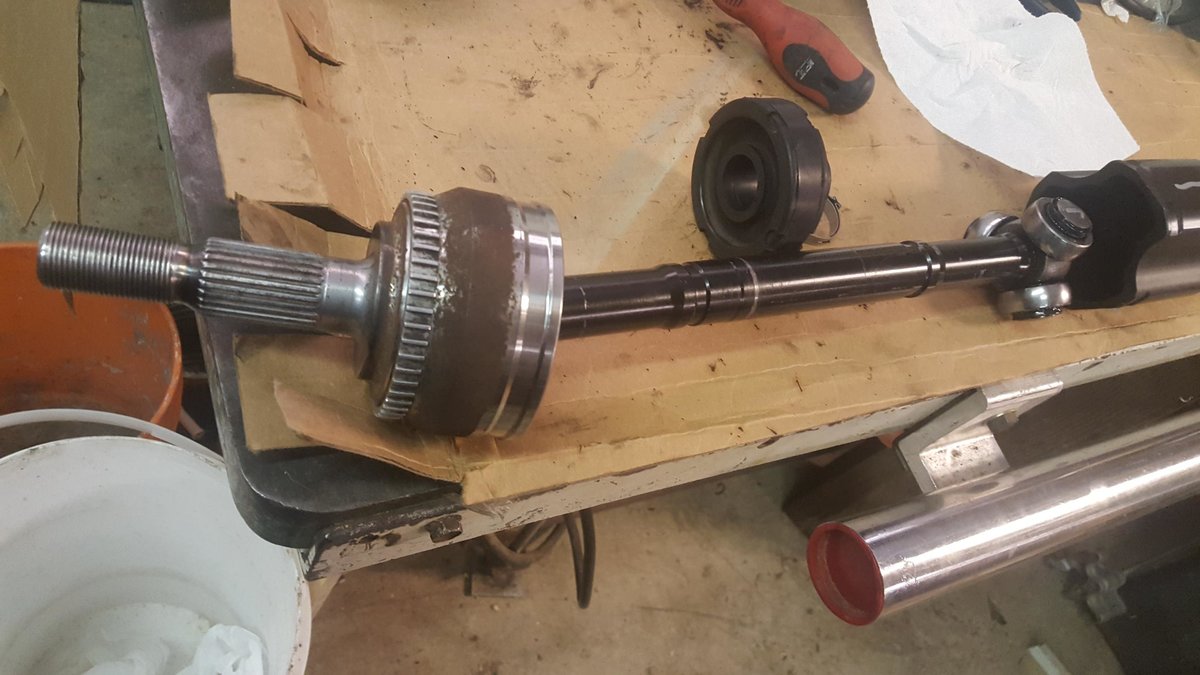

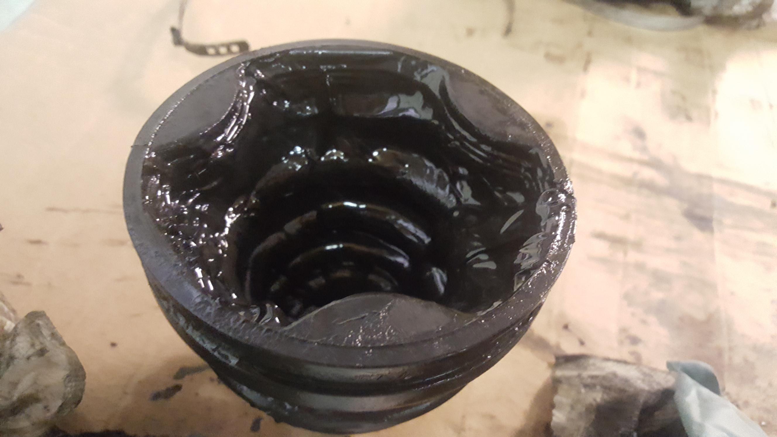

Very happy I found this posting, recognize it's 3 months old.....I have a 1998 V70 T5 manual. Outer passenger CV boot failed so I've removed & cleaned the axle entirely and want to replace both boots. I have this same crenulated axle design and none of the Volvo boots fit. I ordered from FCP and the inside boot large diameter is round and thus doesn't fit the crenulated cup. The outer boot, large diameter end, is also too large by about 5mm and doesn't fit snug. Have spoken with FCP and they can't find a boot that fits. I've now been working the past week with the nearest Volvo dealer, and their parts guy also is at a loss. I've sent him pictures and he's emailed Volvo HQ in Sweden, waiting for a response. None of their parts books show this axle with the non-circular design on the large end of the large boot. The boot itself is not round--the rubber is molded to fit the wavy shape of the receiver cup that holds the tripod bearing. This axle also had a rubber/metal vibration dampener clamped onto the axle in between the inner and outer boots. Finally, the outer bearing on this axle does not have the inside-facing retainer clip to release the CV joint that I see in all the online videos. There is no visible clip, making me believe it has an interior snap ring on the axle, but I can't get this one to pop off for as hard as I'm willing to hit it with a hammer and punch.
Someone above said this might be a 1999 design, but would it fit my 98?

Here's another tidbit of information. IPD strongly suggested to me that I don't bother finding replacement boots to fit my mystery axle in my 98 V70 T5 manual. They said the aftermarket replacements from Autozone are affordable and seem to hold up. The manual replacement axle showed as unavailable but the automatic axle was available for $111. It is a new piece, not rebuilt, so doesn't require a core exchange. I checked again with IPD who said the automatic does work in the manual despite the different part numbers. So I ordered it. Box says made in China so I'm keeping my fingers crossed on quality. Low and behold, the axle I get is identical to the one that was in my car. So that leaves me wondering, what axle design is Autozone's supplier using, so that if I did want to replace a boot in the future, which boot would I need to order? I'm certain that the OEM boots for 1998 do not work on inner or outer CVs, at least on the passenger side.
