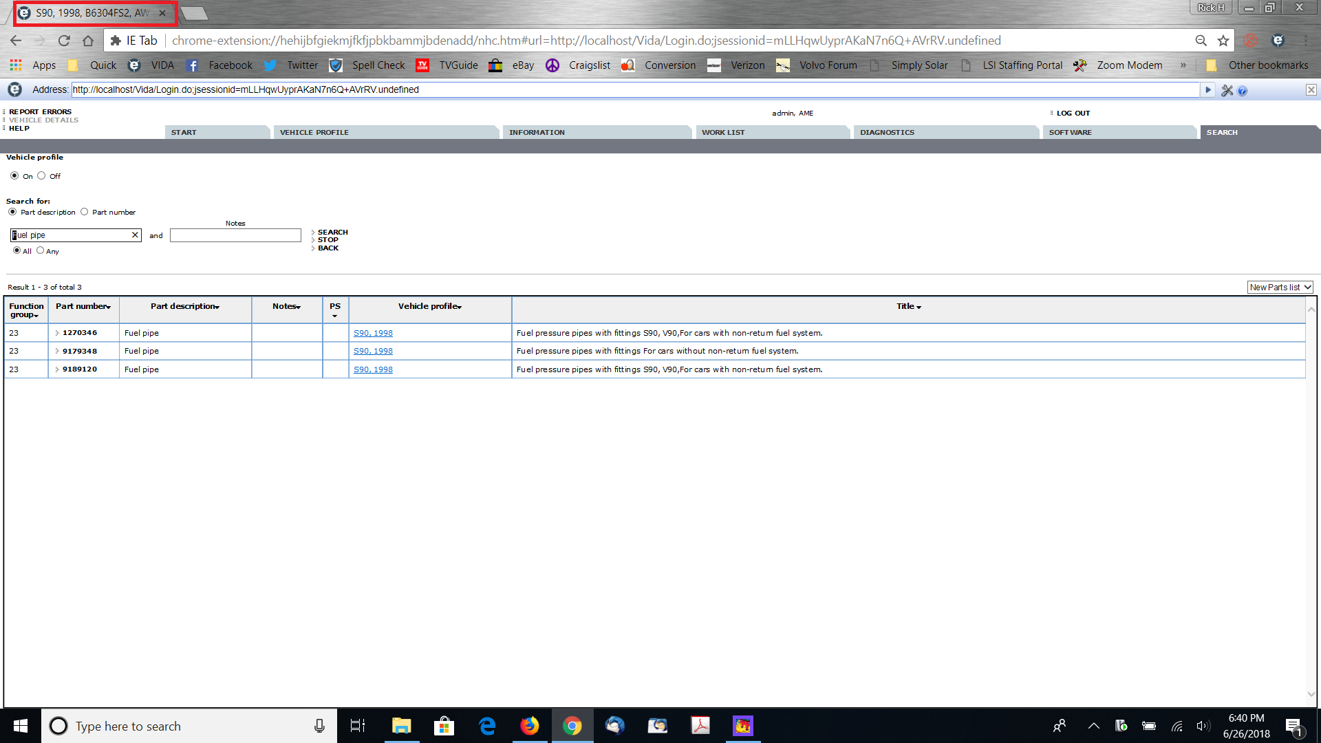

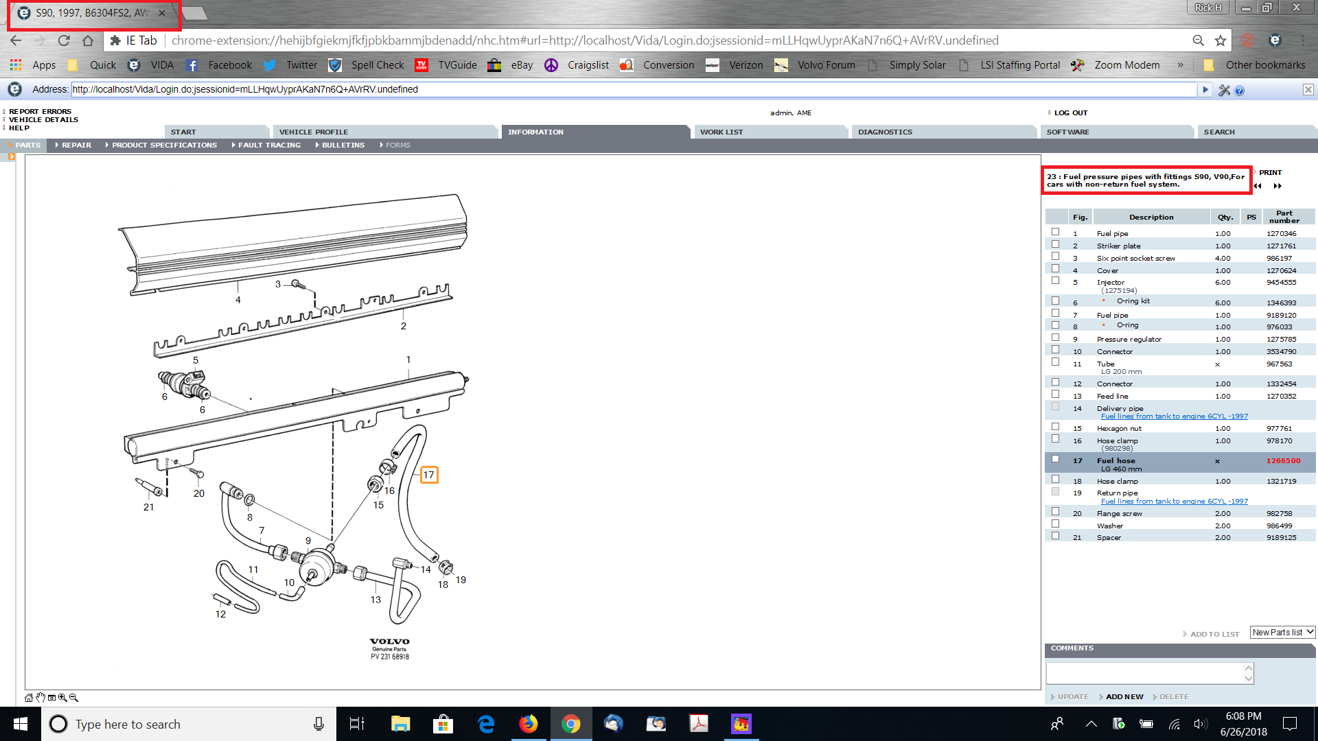

The different fuel rails in ‘97 was because 960 to S/V90 itself was a mid year change. Original 960 fuel rails had the long bracket while the S/V90 fuel rails did not, instead they had long supporting bolts.RickHaleParker wrote: 26 Jun 2018, 15:09 Previously up to 1997 the excess fuel is returned to the fuel tank from the fuel rail.
Some of the '97s had no return fuel rails and some did not, midyear changes. There is quite a number of different fuel rails for the '97 and at least two for the '98 because they had trouble with the end cap leaking.
Return-less fuel rail on the other hand was not introduced until ‘98 which I’ve confirmed through parts diagram (listed as only for ‘98) and it was also mentioned in the 1998 “New Car Features” manual as one of the features introduced on the 1998 model year.
See screenshots
The 97-98 S90 badge is just a marketing ploy. The only difference is the badge. My '97 S90 is titled as a 960.
See screenshots
