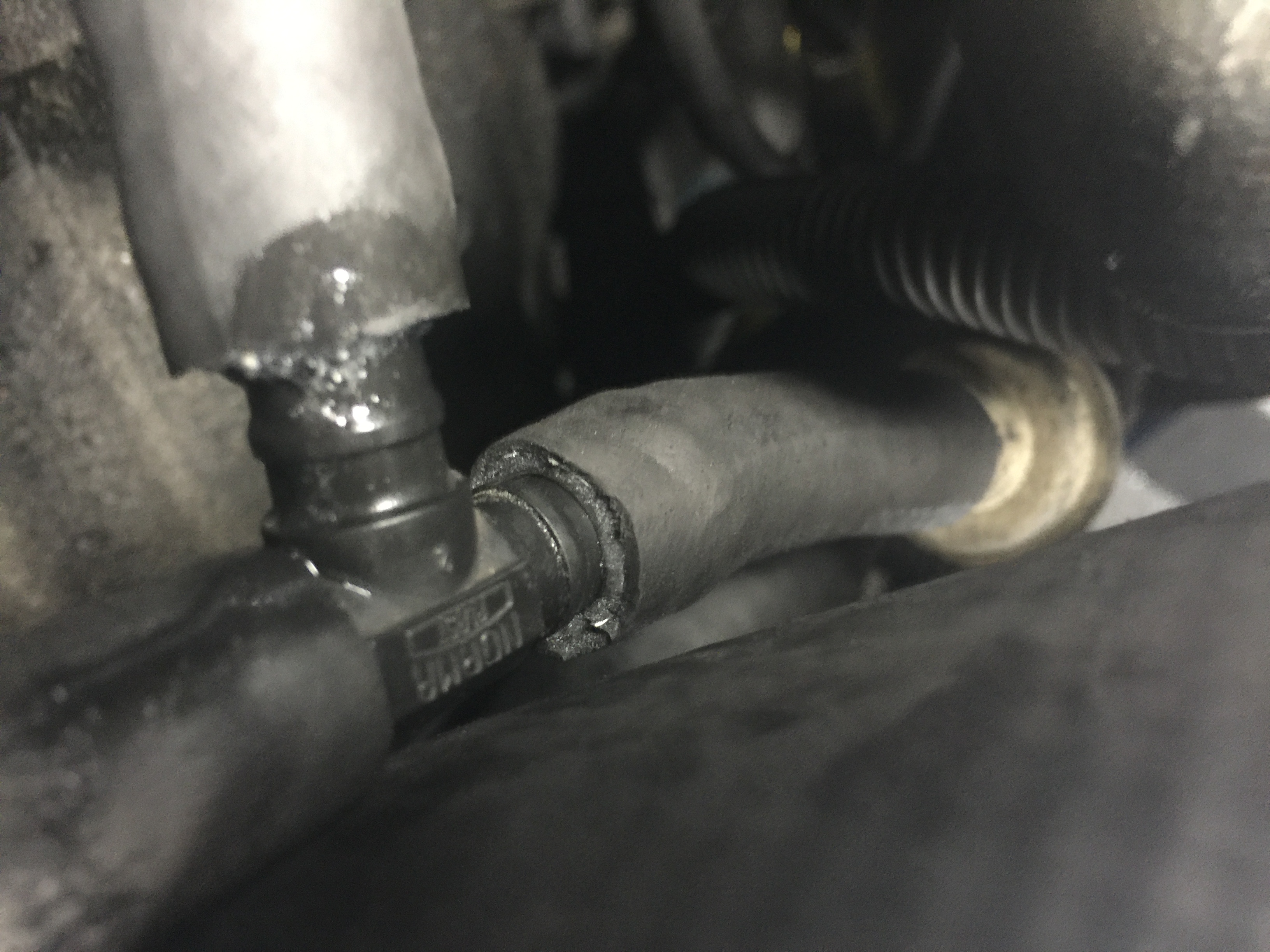

Definitely reproduced the hiss- click- silence-smooth-idle
Hiss is down around cylinder 4-5 , near the PCV-purge-booster hose assembly. Other than purge valve there arent too many other solenoids on ME7

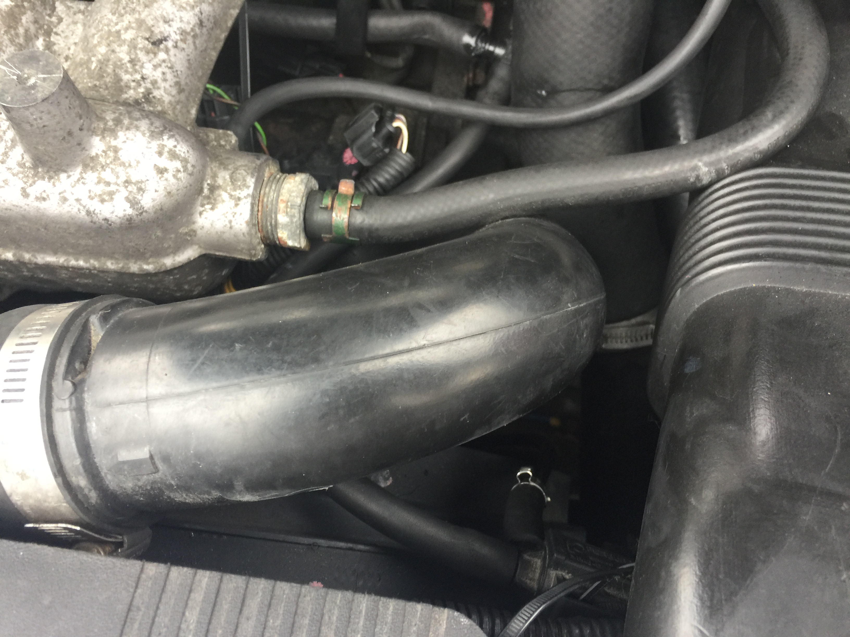

Cheap and easy to add to the list of items to evaluate (and worth adding):
Get some starting fluid on the edges of the intake manifold where it meets the head, especially near 4 and 5.

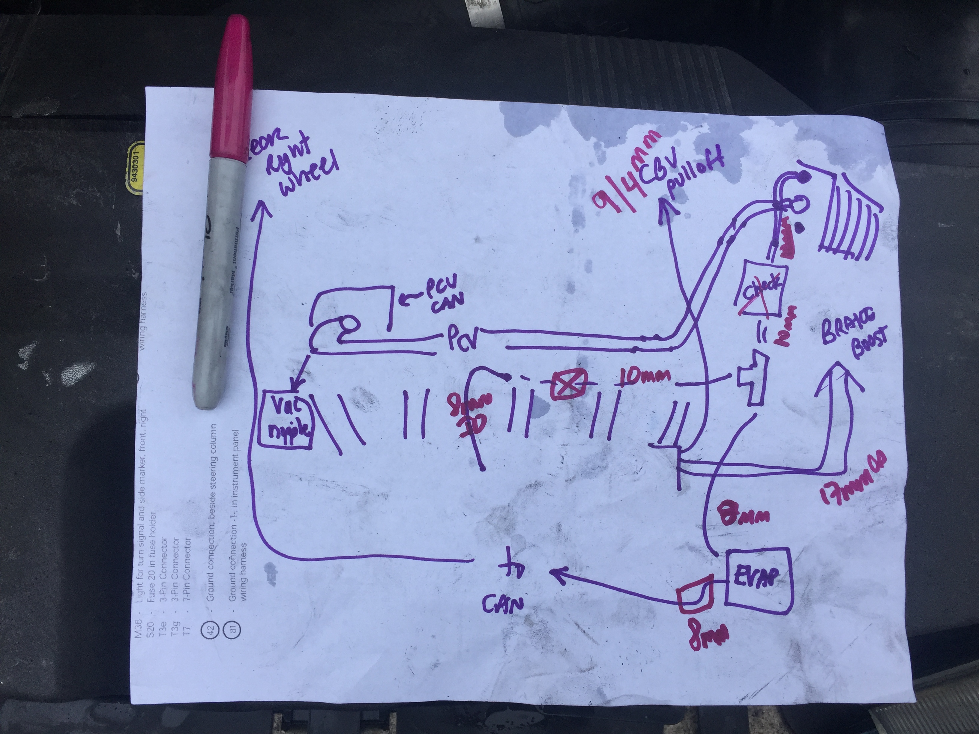

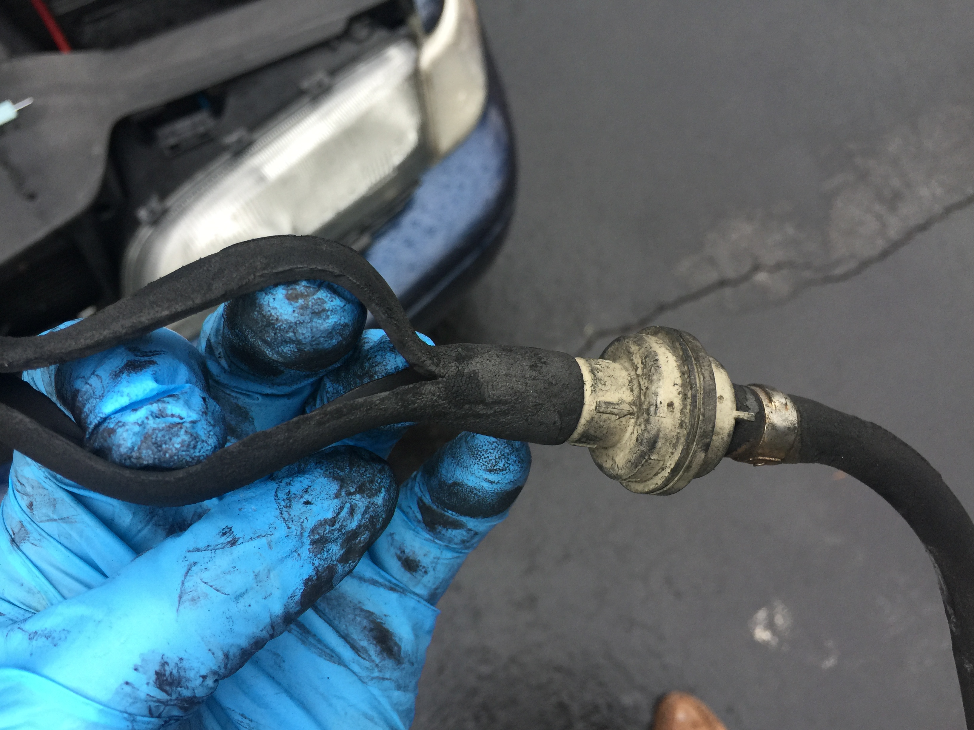

...and my intuition was correct.
I did a VAT inspection of the hoses, found nothing, so I removed the ones I could not see buried under the intake manifold and...obvious check valve fault.....
