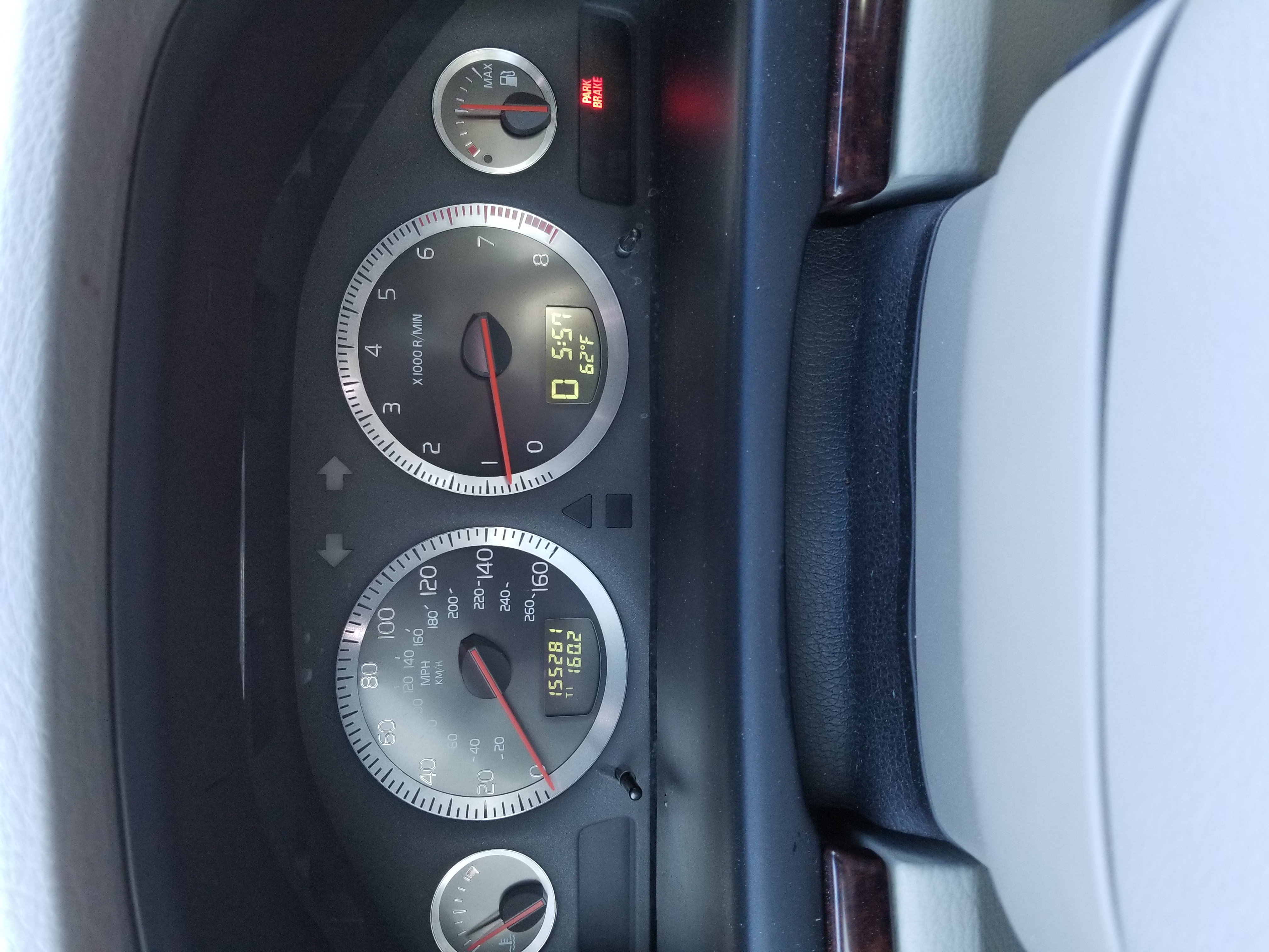

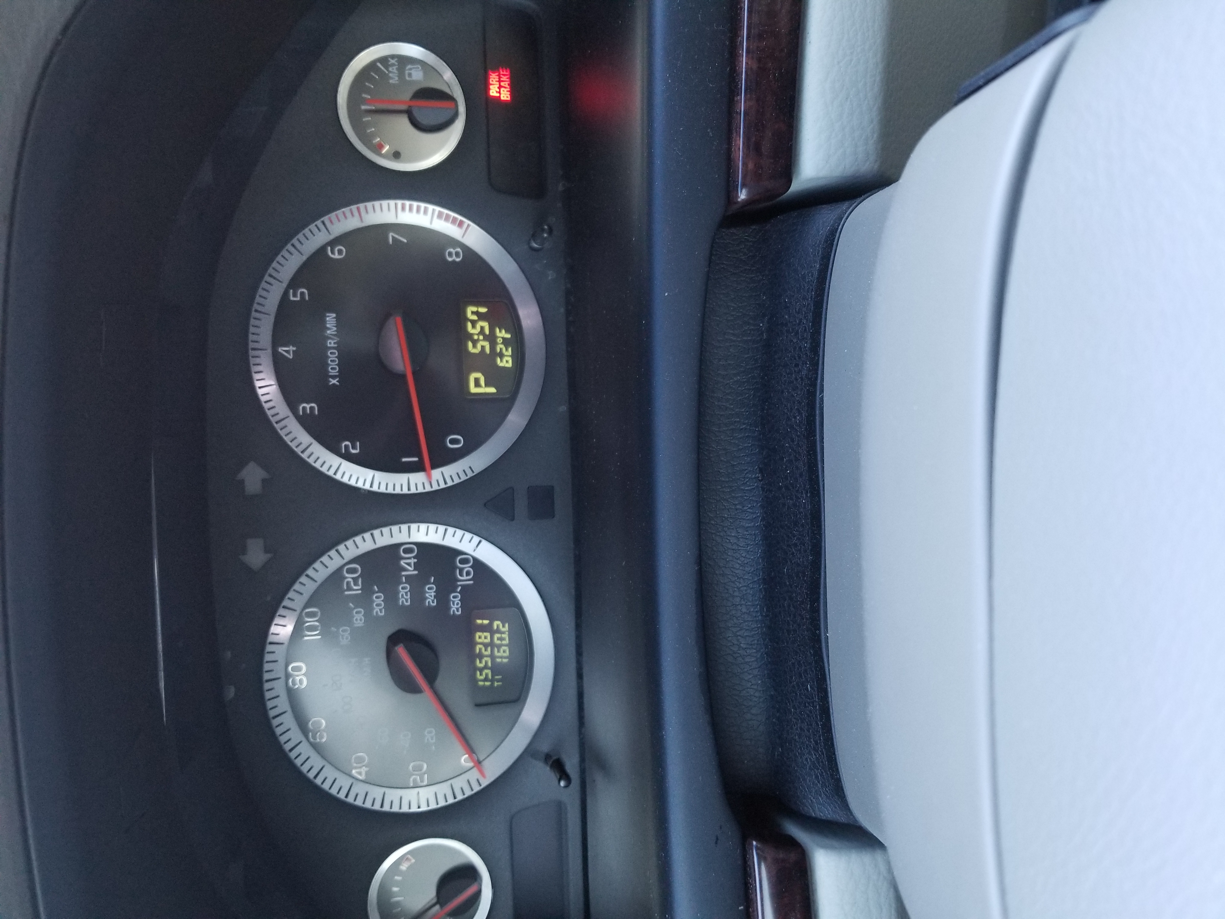

Correct around 700, but idles up in hot weather with ac on to below 900 on the tachometer. Here is my 2004 S80 T6 one photo in park the other in drive. It is 62° here so I cannot show the faster idle above 80° outside. Ac on or off mine holds 700 rpm at low idle in or out of gear. Juneboosted5cyl wrote: 24 Nov 2013, 21:35 Is your S60 a 5cylinder? typically they idle higher as they are not as balanced as a 6. T6 should idle around 650-700 from memory.
