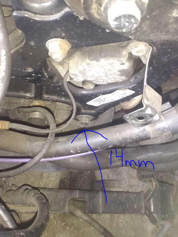

Finally got around to installing my battery tie down! Also took the time to remove some oxidation from my battery terminals.
Also, you know, poking around the engine bay and checking stuff out. I realized this bolt (14mm, lower torque bracket bolt) was loose....
sheesh... :roll:
I wonder if this is why I've had a rough/harsh engine shut-off rumble for such a long time.
I had to replace this bracket when I broke it two years ago. I wonder if I forgot to tighten this or if it worked itself loose... Will definitely check out later.

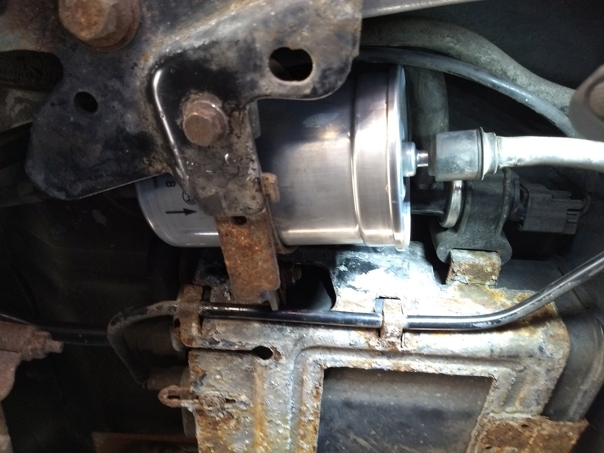

My second attempt at replacing a fuel filter was far more successful, with no broken lines and minimal spillage. The bracket took some fiddling with to reattach but otherwise pretty quick.
Motivated, I tackled the right sway end link. It did not go as smoothly.

Wow..check all those mount bolts, King of Queens. The steel into Al usually don’t loosen up much as they nicely electrochemically bond. I posted a cynical note here once about doing an entire clutch in 12 hours, then spending three to remove the upper torque rod mount bolts

brunocerous wrote: 01 Apr 2018, 22:19 My second attempt at replacing a fuel filter was far more successful, with no broken lines and minimal spillage. The bracket took some fiddling with to reattach but otherwise pretty quick.
That bracket is always a pain to get aligned. Glad it went with minimal spillage, though, that's always a plus when working with gas!

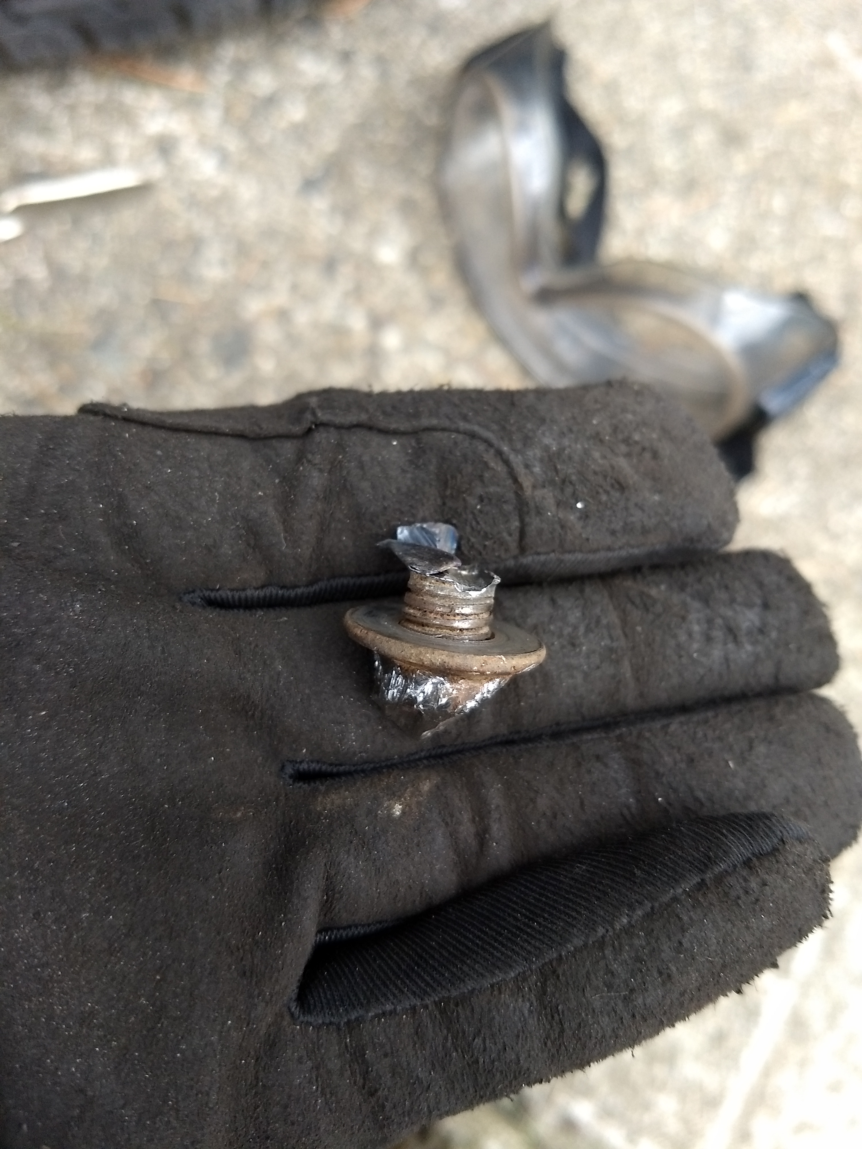

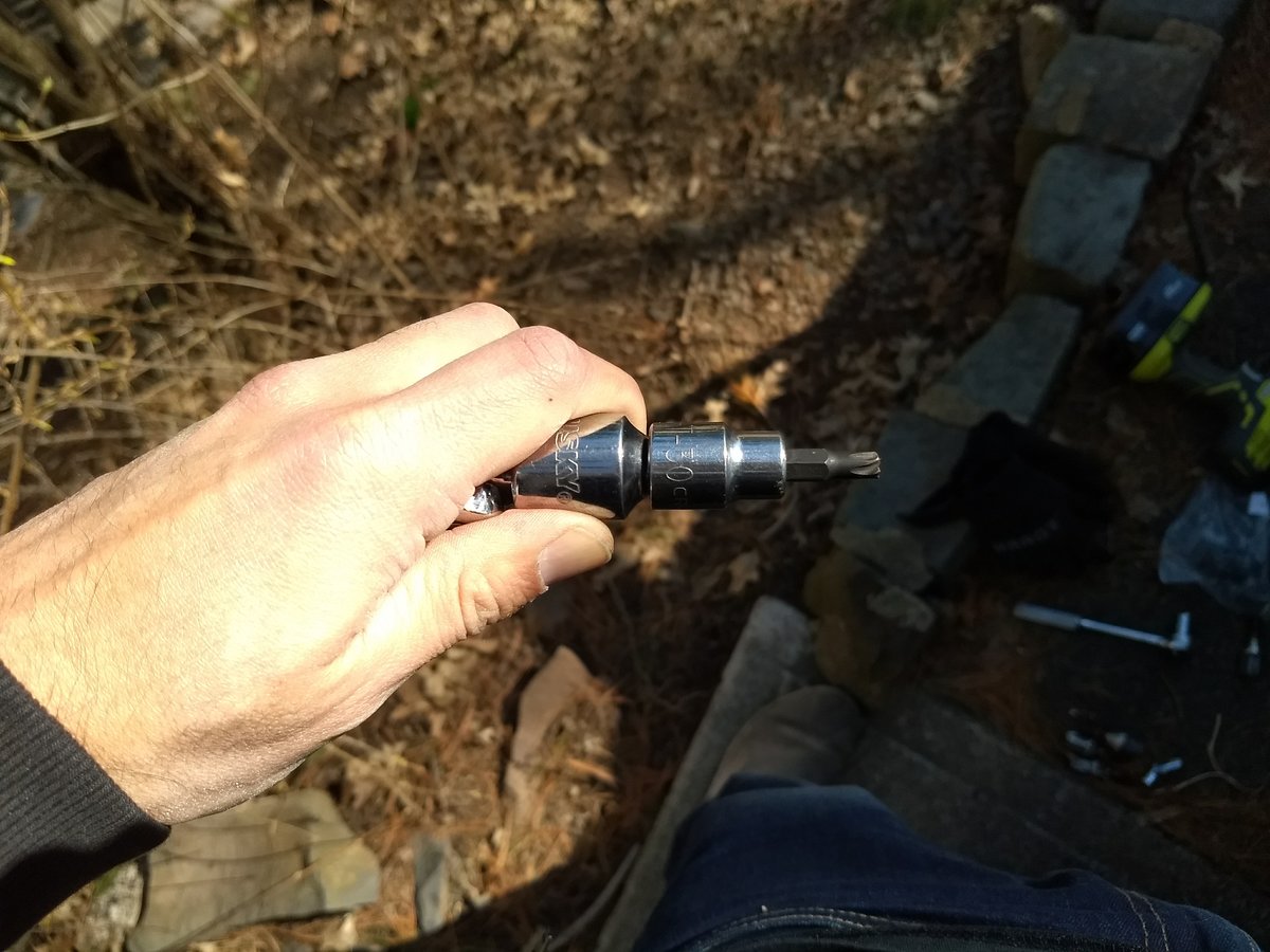

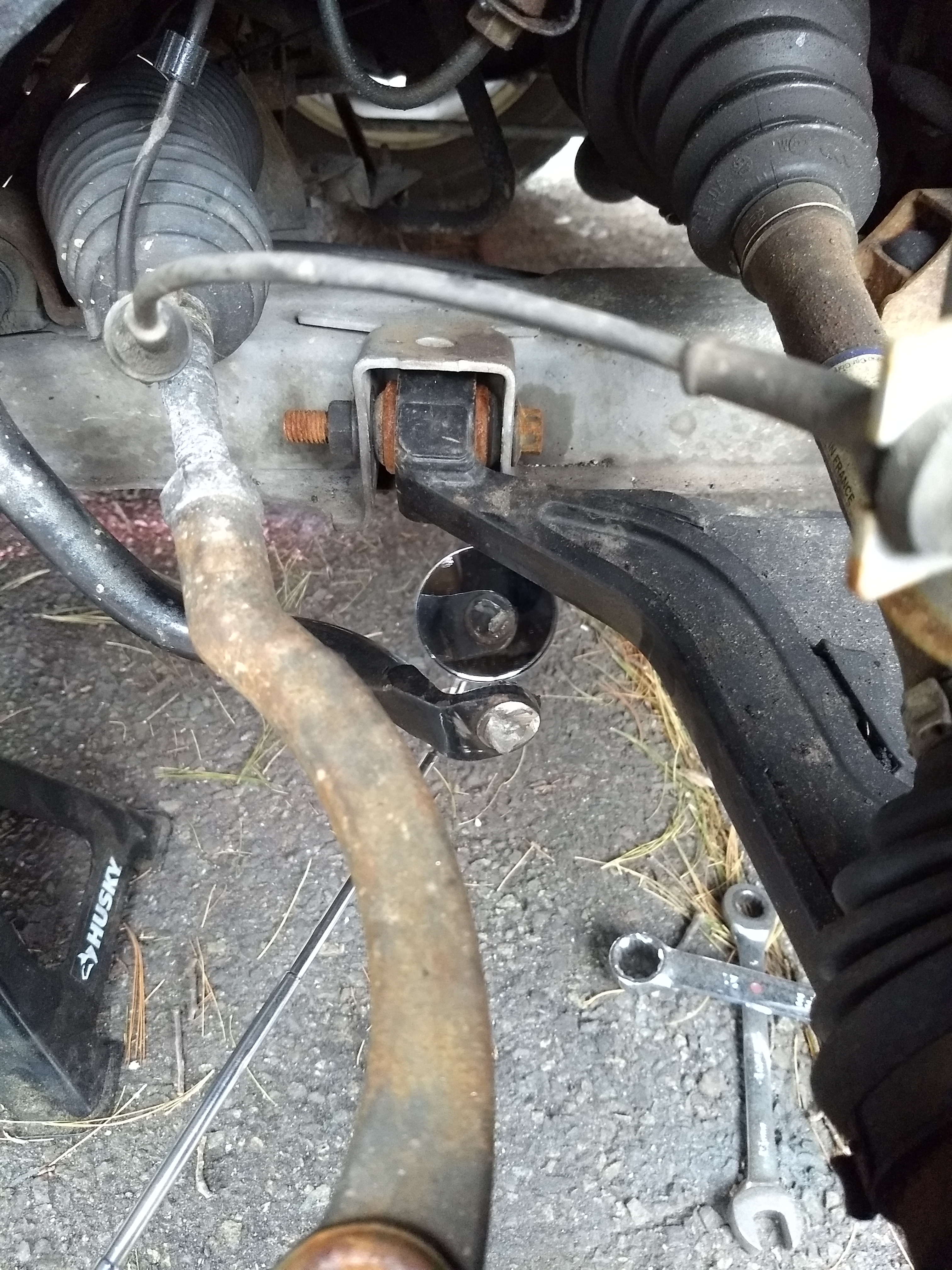

My latest snafu on the '00 V70:
The lower bolt off the right sway end link wouldn't budge, and I even bent the splines on a genuine (not Evolve) Craftsman torx bit in the process. But hey, it looks like a turbo impeller!
I couldn't get a good hold with a vise grip, either, so I pulled out the grinder and nearly lost hope when there was so little bolt material left to manipulate yet too much to remove. Eventually, it relented.
The tie rod completes the AC Delco pair I got in January, with a solid part opposite the bolt, which takes a larger, 17mm nut and uses an 8mm hex counter hold instead of a T-30 torx. So far, so good!
