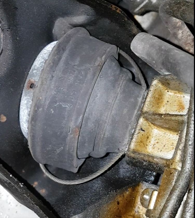

I got this picture from a video I just did (mobile phone on broomstick). Unfortunately, there's not much to be seen on it either.
However, the engine mount seems to have cracked.
Should this be replaced or is it still OK?

According to this video (at 1:31) there should be a VOLVO print on the TRW near the rubber bearing. The guy compares the TRW against the SMI:
However, mine looks different:
I guess my steering rack is some kind of cheap aftermarket stuff. :-(
My steering rack has a metal plate(heat shield?) like this which is mounted on the SMI in the polish youtube video. But I guess that's not a feature but it's universal?

Been a long time since I had a look at the steering rack. Both my cars have SMI racks. I am not 100% sure, but I think I recall the SMI rack has their brand toward the back of the rack and needs to be seen from below looking forwards. It can be hidden by dirt so check carefully.

Look at the grease cap on the bottom of the steering gear. TRW rack has a smooth / rounded cap, SMI sack has a hexagonal end like a large raised nut.

Thanks for the hint. I have this hexagonal nut. So apparently the TRW steering has been replaced by one from SMI.

If there is no record of steering rack replacement, then assume your car takes SMI rack, simple. The rebuilder said SMI & TRW are not interchangeable.

xHeart wrote: 11 Apr 2018, 07:05 If there is no record of steering rack replacement, then assume your car takes SMI rack, simple. The rebuilder said SMI & TRW are not interchangeable.
Parts are not interchangeable (inner tie-rods) from one to the other, but complete units may be swapped.
