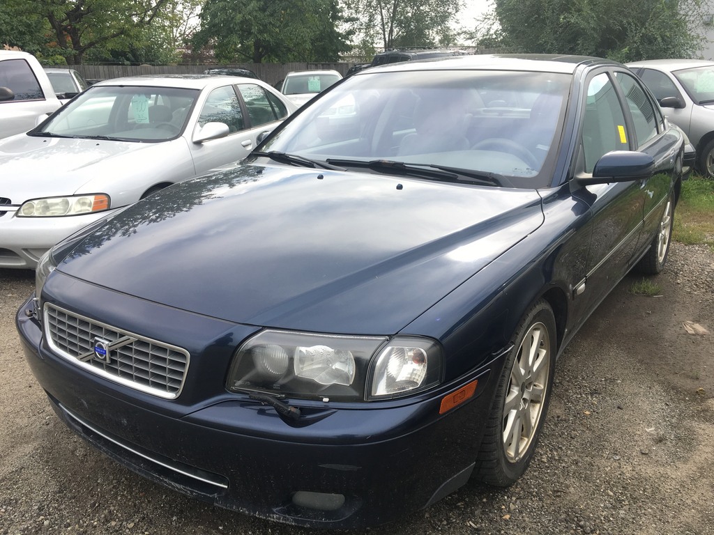

Just picked up a 2004 s80 AWD with the 2.5t. I was not able to properly test drive it so I don't know if there is a actual problem with it. I know I should have driven it but for the price, it was a steal even with a Bad transmission. Paid $600 for it and figured I can get double that money even if I part it out.
First plan is to try to fix it since the rest of the car is mint condition. Being that this is a 2.5t and not k own for transmission issues, is there something else that goes wrong on these to cause the error light? The airbag light is also on (not too worried about it) but besides that it does go into drive and reverse.
My initially I will try flushing the old fluid out and resetting the codes with my friend's Vida.
Any advice would be appreciated.
2004 volvo s80 2.5t AWD transmission service required
