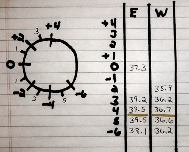

Now for a little more information to chew on. When those rear bushes go bad it will drag down your highway econ by around 2-3MPG by my rough calculation. I had tweaked the front end toe settings to keep my MPG up to compensate for those bushes as they went bad over the course of winter. With the new bushes installed it was obvious while driving that the toe settings needed to be readjusted.
Method: to keep track of the toe setting I use small zip ties, one on the inner, another on the outer tie rod. The one on the outer becomes your fixed reference point. The one on the inner becomes your pointer, or adjustment reference as you turn the inner tie rod to adjust: On the FWD S60, parasitic drivetrain and wind drag is exceptionally low for a lux car. 1.5 miles down the country road that I'm on far enough to get a feel for it... Define a start and end point in each direction (E=Eastbound, W=West in the table). Set the cruise at 50mph before making test runs. Then get up to speed and resume cruise before the start point, reset the AVG econ at the start point. Take note of the AVG econ figure shown on the dim at the end points. Write it down after you've stopped. Proceed to the next position of toe adjustment and repeat.
With AWD and/or a SUV the peak econ is lower due to increased parasitic losses of the AWD system and/or increased wind drag. Adjusting the toe by small amounts doesn't provide quite as obvious AVG MPG peak on a shorter runs. To do this with my sister's AWD XC90 I had to increase the distance to 5 miles otherwise the numbers were too close and inconsistent to be meaningful.
Note a combination of topography and a ~20mph due east wind this afternoon are the reasons why westbound is consistently lower than eastbound. The zero point (9'oclock on the diagram) was where I had the toe set to peak MPG with torn/bad bushes.
With good bushes the setting changed notably. The difference in econ between '0' and where it peaks now (between -4 to -5 on the chart) would be the loss in econ you would expect to see with bad LCA bushes. As it was obvious that adjusting inner tie rod in the counter clockwise direction was 'correct', there was no need to experiment in the clockwise from '0' position.
Now that I've got it pretty close, in the near future I'll do a few longer runs making smaller adjustments under more ideal conditions (longer stretch of flat level pavement, no wind). I know the spot I like to use, an old 2-lane highway with light traffic that spans across across a flood plain. It's 30 miles away though.

Small tip with regard to finer toe adjustments on these. The suspension is so darn good about soaking up vibration and harshness from smaller road imperfections, toe within around +/- 0.10" is difficult to gauge from merely paying attention to ride harshness/bump steer while rolling over expansion joints in the pavement. Feedback through the steering wheel feels 'confusing' to me for this purpose.
What I've figured out through trial and error/observation:
What does seem to provide consistent feedback that you can actually interpret is what I would have to term not specifcally not as bump steer, but "dip steer":
On a fairly smooth road scout for a 'dip' in the pavement, 1-2 inches deep that isn't big enough to span the width of the vehicle: One side of the vehicle remains on flat pavement, the other side rolls through the dip. **not broken pavement or a pothole**, but where a puddle would form 2-3 feet in diameter after a rain. Roll over it 70-80 mph and pay attention to whether the car feels like it wants to lean into or away from the the side that rolled through the dip. As that side momentarily loses a bit of traction, if the car feels like it wants to car leans toward the side of the dip you're slightly toe in...or vice-versa. The faster you go and more attentive you are the more precise you can get about it.
Rolling over *bumps* or cracks just doesn't produce driver feedback on these cars that's easy to interpret within a 'very close' range of toe adjustment aside from a little bit of understeer/oversteer. It just all feels like the same sofa (on wheels).
