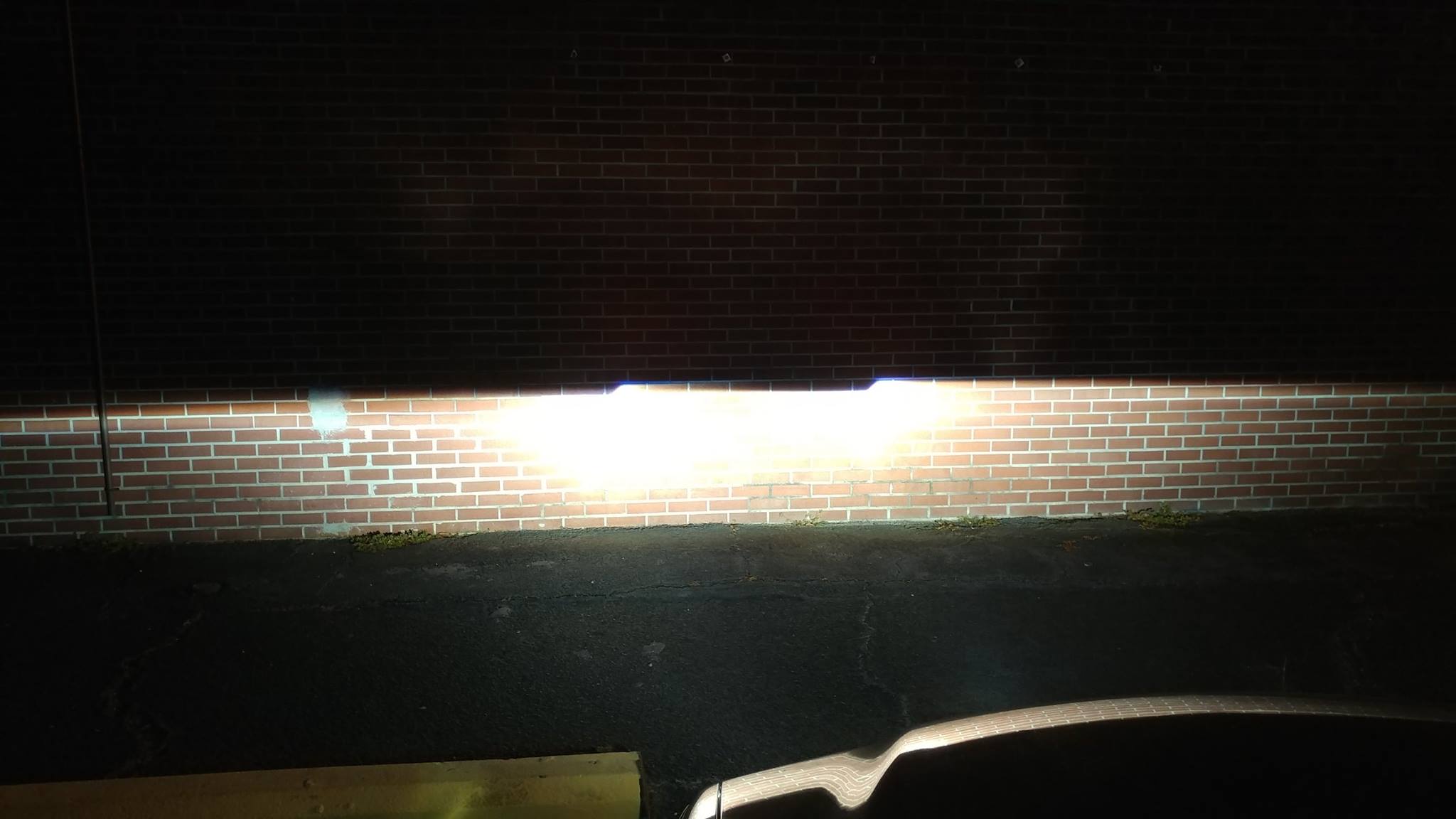

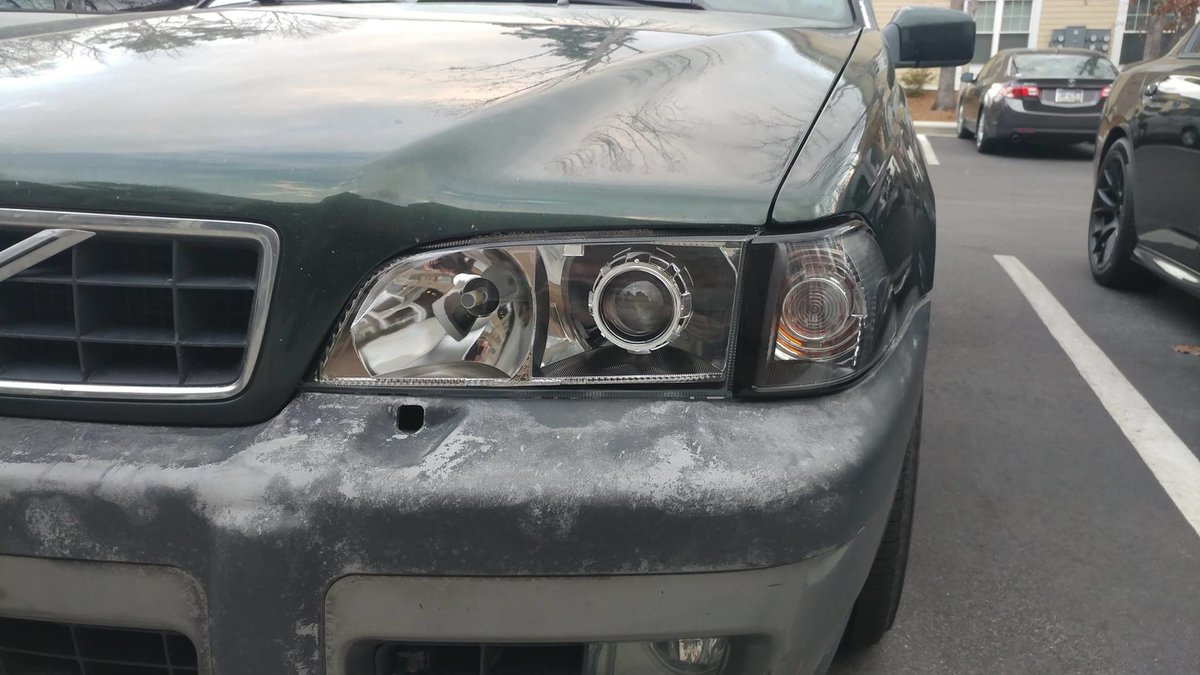

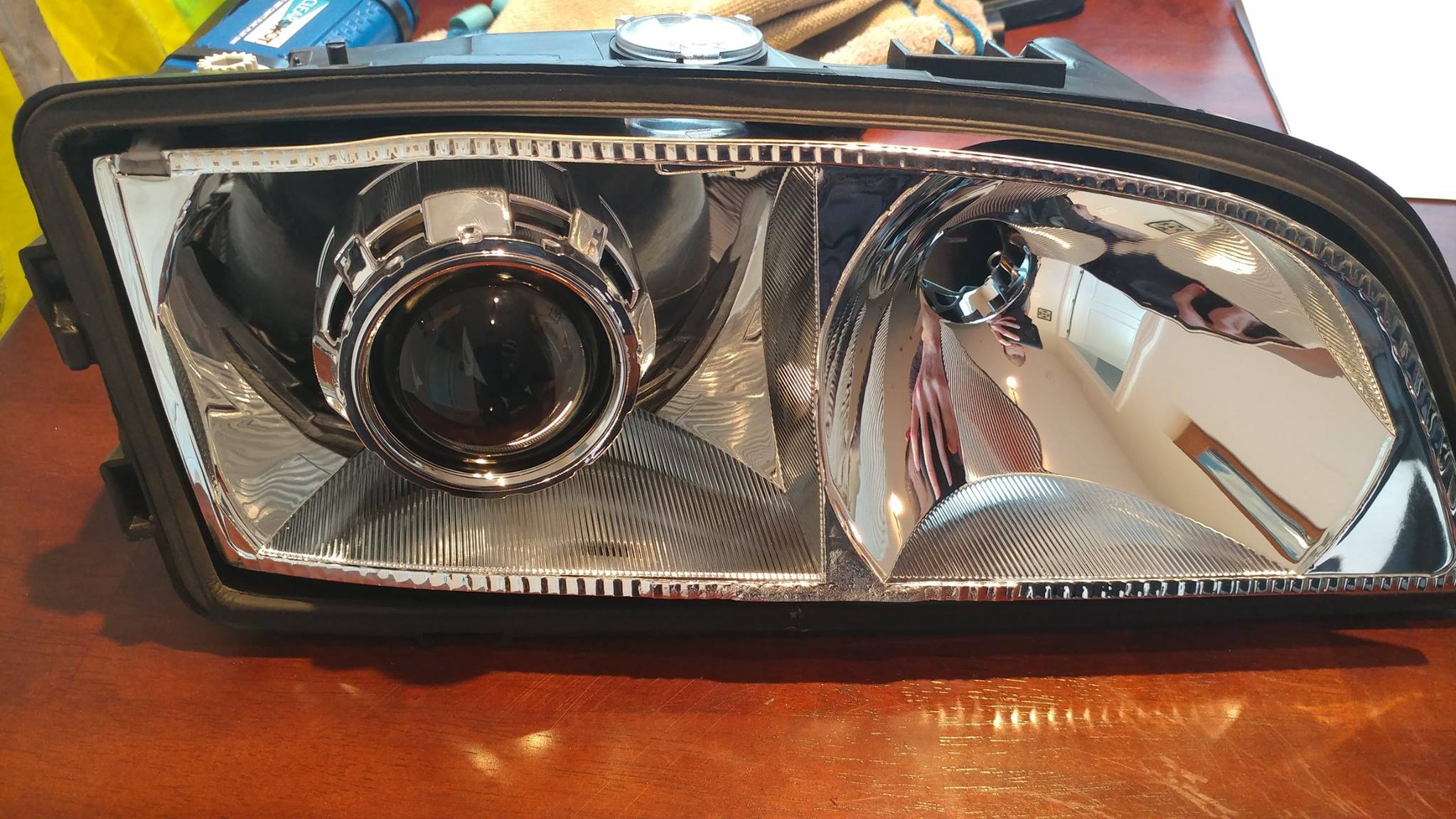

I had HIDs in my ABMs for a few years and the light output got progressively worse. I took them apart one day and found the HIDs had basically disintegrated the reflectors.
So the way I went was definitely pricey, but unfortunately is one of the few ways to properly go to HID lights. I basically took the glass from the ABMs, put them on new TYC assemblies, and then use a TRS HID retrofit kit (linked below). I now have H1 bulbs. TRS provides very clear instructions for everything and it was a pretty smooth process. I also put in LED H7s in the high beam position.
The result is amazing. When you flick on the high beams now, not only do the LEDs come on, but because the HID kit is bi-xenon (high and low beam in one), a small motor moves the shroud in the projectors and then you get full light from the projectors as well.
https://www.theretrofitsource.com/compl ... age-3.html
A few pics. Can't find one with the high beams on... though it is quite impressive. Also yes my bumper was really bad. it's since been painted and is a deep black now. :mrgreen:

ecbsykes, that looks clean and like it is supposed to be there. Nice work! I might have to try that. I have heard/read good things about that site.

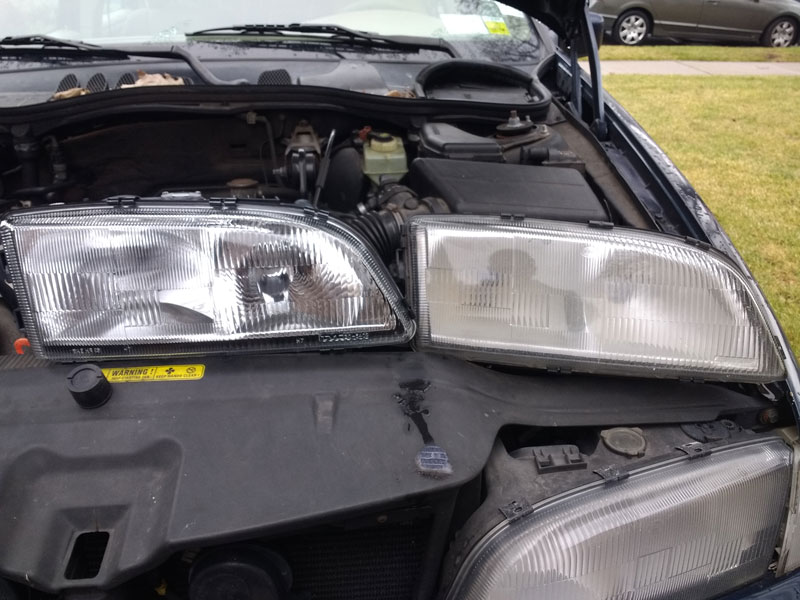

Just in case anyone wants to see the difference between the TYC assemblies available on Rockauto vs the original 20-year-old assemblies. We're pleased. We can finally see again.

Thanks for sharing, I've been pondering about replacing my headlights for a while, your picture helps seeing the actual difference!

Me too. I really wanted to spend $300 on headlamps. And have been hemming and hawing for over a year! (I couldn't see anything on the highway anymore.) In the end I think it was an article my brother forwarded me about faded headlamps being a safety issue that made me finally commit to seeing. I think they'll last. (And anyhow, I need to start saving for the "Wife's S40"... I think that's coming in 2019... :roll: )
