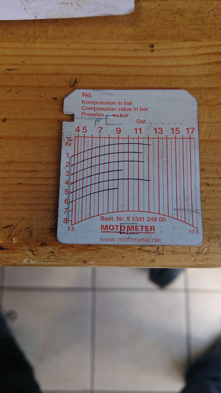

They called me to tell me they had cleaned all of it, but that they didn't really find an explanation for crankcase pressure other than blow-by or leaky stem-seals. We agreed on doing a compression test, see the chart in the picture.
They took 2 readings of the #4 cylinder, which is obviously performing less than the others.

You have a problem with 4th cyl.
Higher viscosity oil will not help on that.
It WOULD help in the case that ALL of 5cyl have lower but EVEN compression.
Could be bad rings on that cyl. or a valve on it that is failing.

Thicker engine oil may change the compression numbers if you have an engine ring problem. The change should be seen on all 5 cylinders as an increase. If you have another problem the oil weight change will most likely have zero effect.
I would suggest you pull the spark plugs and look at them. You are looking for #4 being oily relative to the others. I would also at least look down the spark plug hole and examine the piston tops. You are looking for carbon build up - more on #4 than the others. If you have access to a camera, maybe you can look up at the valves. Looking for the same thing. It sounds like your shop did this. Can you ask them exactly what they did to check the valves and valve seats look good? Taking off the exhaust and intake will show the tops of the valves, but not the internal portions which is where your leak is most likely occurring if it is a valve issue and not a ring issue.
Where am I going with this? My guess is that the engine valves are pretty coked up and #4 is not sealing well. Cause is most likely the valve stem seals starting to leak do to age and mileage as they get harder and harder. As a result excess oil is entering the combustion chamber and slowly coke deposits have built up and the valves are unable to fully seal, mostly on #4, but the rest will follow suit if the valve stem seals are starting to fail. At some point the problem will get so pronounced you will burn out valves. At the same time the coke build up may be building on the valve seats causing a physical restriction on closing fully. They could also be pretty pitted at your mileage.
The other possibility is the oil rings are worn and/or the oil ring scrapper is coked up and this is most pronounced on #4. This is not common in Volvos, very common in certain Toyota engines. Running a cleaning solvent and increasing oil change frequency sometimes cleans this up.
I would focus on the valve stem seals. These need to be changed out. Some liquid mechanic bottles allegedly will soften these - not so sure though. You mention that your mechanic has used a "seal conditioner" so s/he is traveling down this same route. Oil rings and liquid mechanic aside - for a complete picture you need to pull the cylinder head top cover. Major surgery. Yes you can change out the valve stem seals without pulling the complete head off and disturbing the head gasket - but you still have the coke build up issue on the valves. You can try some direct inject cleaners or water to solve this, but I would not bet on a great outcome. If I recall your engine correctly the advantage to this approach is you don't have to take off the exhaust and related plus the head gasket is not disturbed. Theoretically you may even be able to not touch the timing. Worse case you do the timing belt, tensioners, waterpump and all related cam seals while in there.
The right way would be to pull the head and clean it up, lap the valves and replace the valve stem seals. A fresh top end job. This is a big and expensive project to pay for, but plenty of write ups on how to DIY.
I have outlined what you need to look for and why you may be having the problems you have. You can go through my notes with your mechanic and they can answer why or why not I am incorrect. They have seen the car and have way more information than I have, and from what you are saying they have touched on much of my concerns. The cheapest approach would be to confirm with your shop they have put in some added solvents to clean the engine oil rings and then let their solutions run the course. After finishing up, I think they are advising you correctly.

Thank you all for your replies!
SuperHerman, special thanks to you for your elaborate reply and explanations!
I don't think they looked up at the valves though.
He indeed said that stem seals would be the prime suspect and that in some cases the 'seal conditioner' does help to regain sealing ability. He was honest enough to add that it never really fixes the problem, but sometimes help to reduce symptoms.
We agreed that a seal job would be too costly at this stage, he even talked me out of it: "This would be a really expensive job and I would just drive the car as is for now, all of the money you put in isn't reflected in resale value, and you'd only spend money for your own pleasure. If it were my car, i'd just drive it while keeping a close eye on the oil level".
Then for my next question: can I really break something by driving it this way, assuming I keep track of the oil level and top up in time (mechanic says not)?
If I can just keep driving untill it's getting REALLY bad and then have the head pulled & valves fixed, I'd rather postpone the expenditure and -although I really like this car- maybe even consider giving in and just drive it untill it doesn't go anymore, then sell for parts. It cost me a few thousand EUR last year, and I'm now considering that maybe investing in a newer, lower mileage car is worth it in the long run (P2 V/XC's also appeal to me...).
I know this is no real wrenching, but.... I'm also still considering putting in real 'leak stop', had this work very well on a previous car (but that thing really was a wreck, so nothing to lose!). Should I be wary of real 'leak stop' with these Volvo engines?
Same goes for cleaners that are added to fuel and/or into sparkplug holes to loosen up stuck piston rings (like Seafoam?): Indy says it did work for him sometimes, but is also know to sometimes loosen debris stuck on the piston rings which then causes more trouble down the road, so he advised not to seafoam it at this point yet. Any specific cleaner known to you guys that might help with this issue?

Allright, thanks!
I guess I'll just keep a close watch on oil level, switch to a 10w40 high mileage oil. Will monitor CEL, temp gauge closely (as I always do with older cars).
I'm hoping to drive this car for a few more years, but would like to keep costs low if possible.
