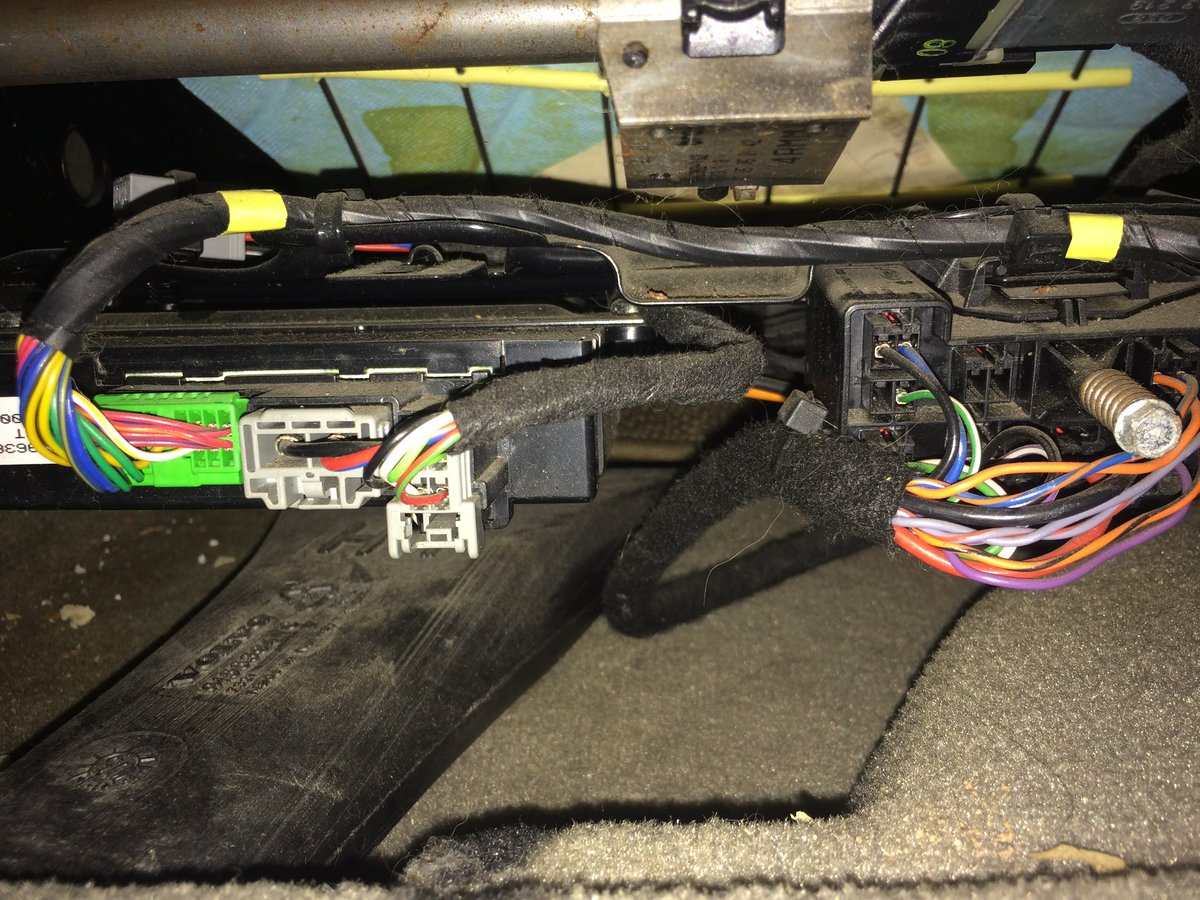

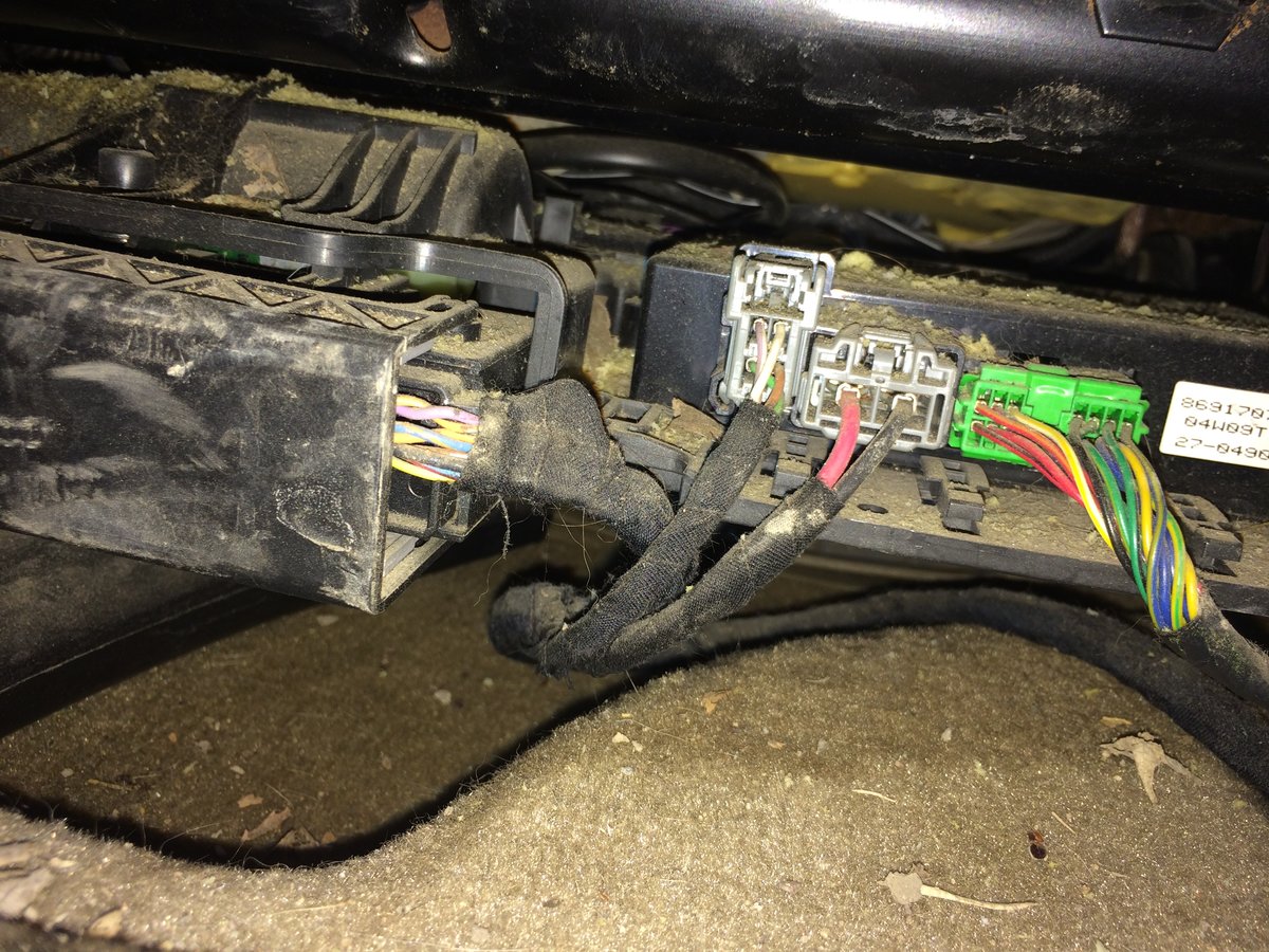

I'm about to attempt a seat swap, but wanted to see if anyone had success putting heated power seats from an 06 S60 into an 04 XC70 that has heated power seats? I have a chance at front seats out of an 06 S60 137k & want to put them in our 260k 04 XC70 whose seats look like they've withstood a bombing.
I have both an 04 and an 06 XC70, was eyeballing the seats this morning and the mounting points seem similar.
According to the Volvo site the subframes are different. That, the mounting points and the electrical should be the big things.
The connectors appear to be the same, I don't know about whip length though.
Anybody had any success with this?

The seats were entirely changed around 2005 (not sure which exact year was the change). Different rails, SRS connectors, cushions, nothing fits.

As it turns out, the compatible seats with 2004's are limited strictly to 2001-2004. That's for bolt, & plug & play seat swaps.
