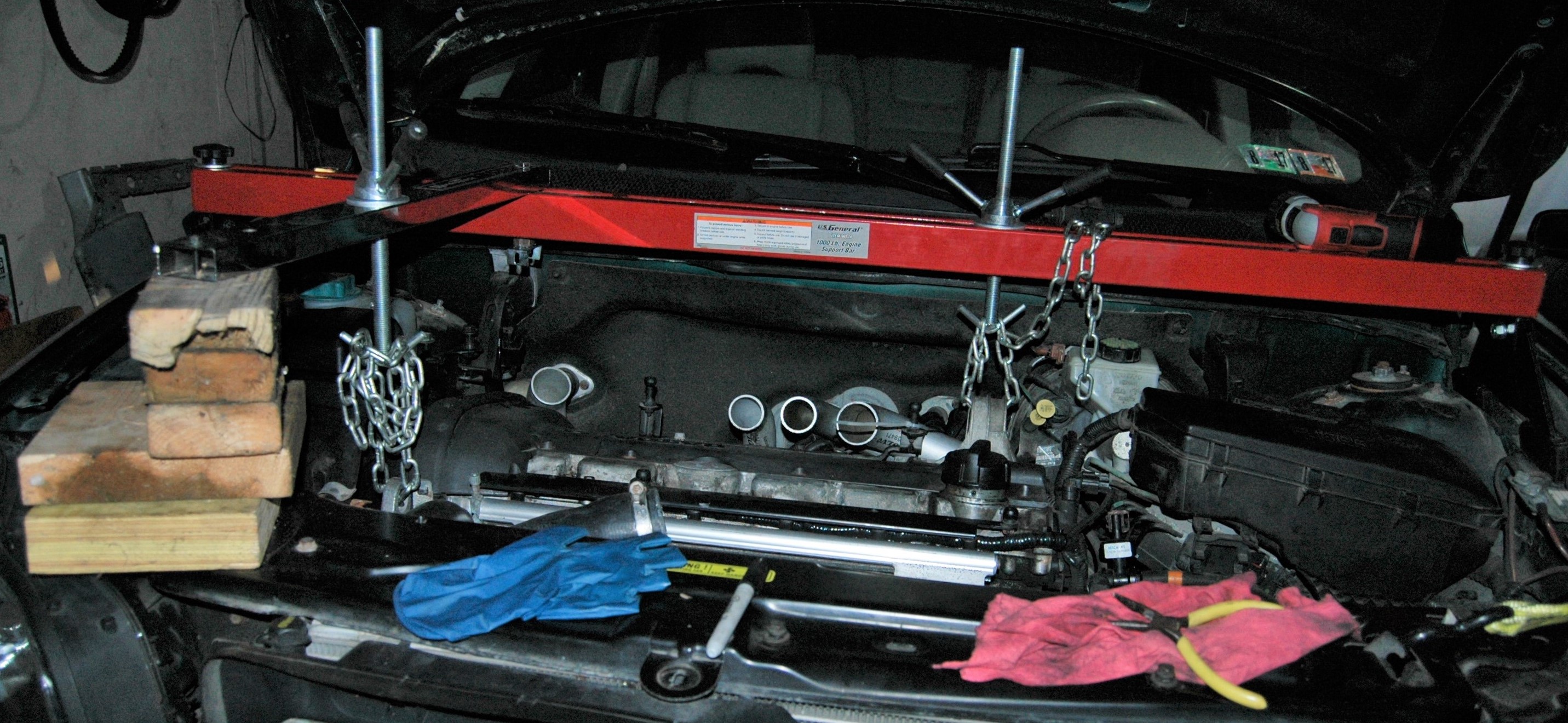

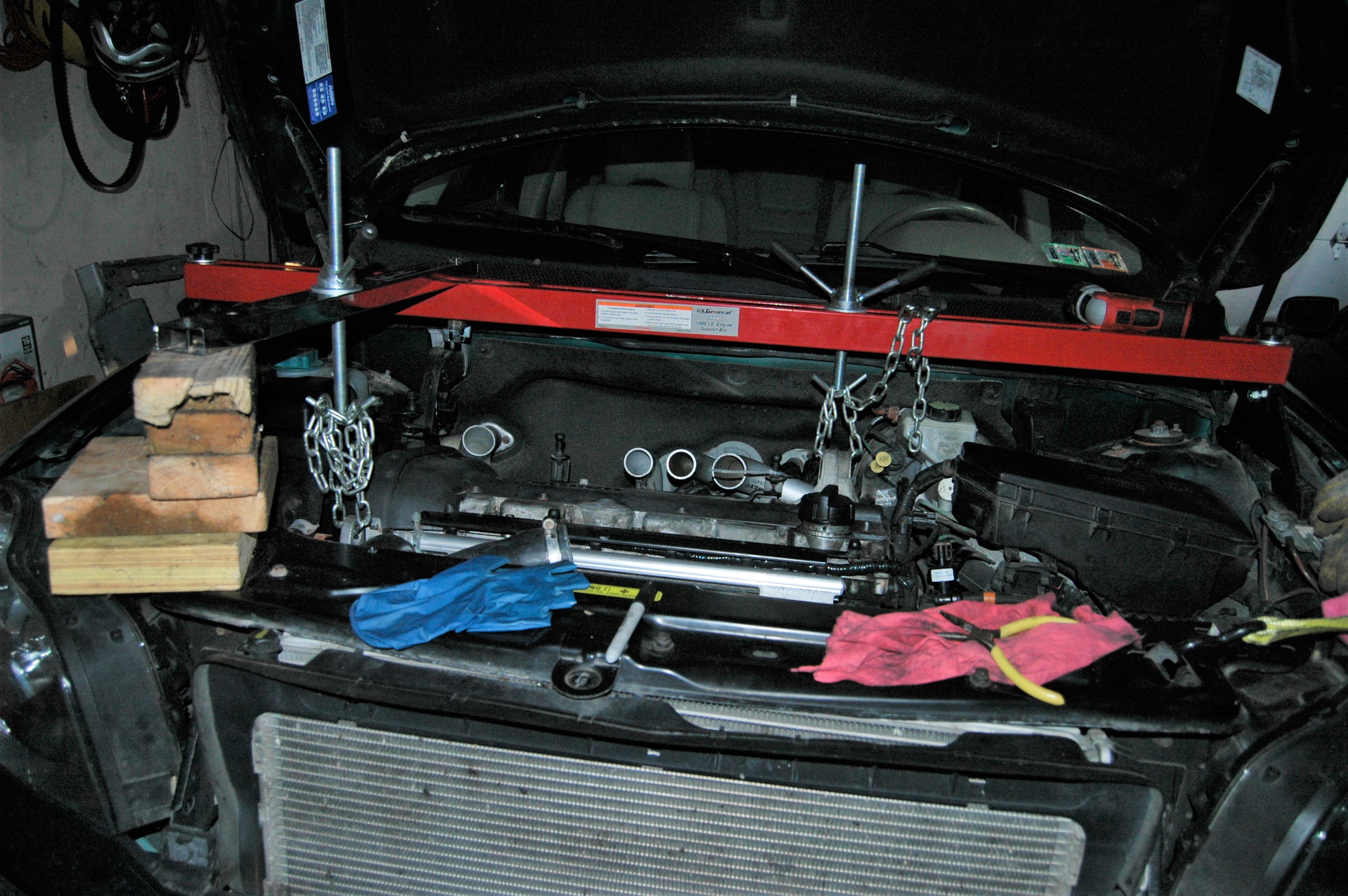

I got a support bar and all six mounts/torque struts a few weeks ago, but did not have a chance to do anything with them until today.
This was my first time doing engine mounts of any kind, so I went a bit slowly. I replaced five mounts in about six hours, including blocking the rear wheels, lifting onto jack stands in front, cleaning up leaked juice from the ruptured mounts and splash guard, and putting tools away.
I reviewed the VIDA procedures and discovered that I should have bought new bolts for the right side lower mount/pad. These are angle-tightened so the old bolts must be discarded and replaced with new. The local V dealership parts guy said they would have to get them "from their east-coast warehouse" (ha!) so I said "no thanks" and ordered them from MY Chicago warehouse. Once I get the bolts, I'll do this mount.
This car has two lower hydraulic mounts, two lower torque struts, a mount "pad" on the bottom of the right side, and a torque strut at the top right of the engine forward of the strut tower.
I had gotten some scrap rectangular steel tubing to make a third leg as shown in SuperHerman's photos above, but when I looked at the steel crossmember over the radiator, it did not seem to be supported by much at either end and I didn't think I could rely on it to support 400 pounds. Furthermore, the left lift point is at the front of the engine, which doesn't afford much leverage for fiddling about with the left rear where the mount is.
I set up the support bar somewhat diagonally to minimize the horizontal extent of the chains supporting the engine and tightened up the chains. Under the car there is an (aluminum?) bracket at the lower left rear corner of the transmission that looks like it was designed as an engine lift point. No idea if that's the true purpose, but I got a jack under it with a piece of 2x4 along the left edge of the transmission, just high enough to support some weight but not move anything.
