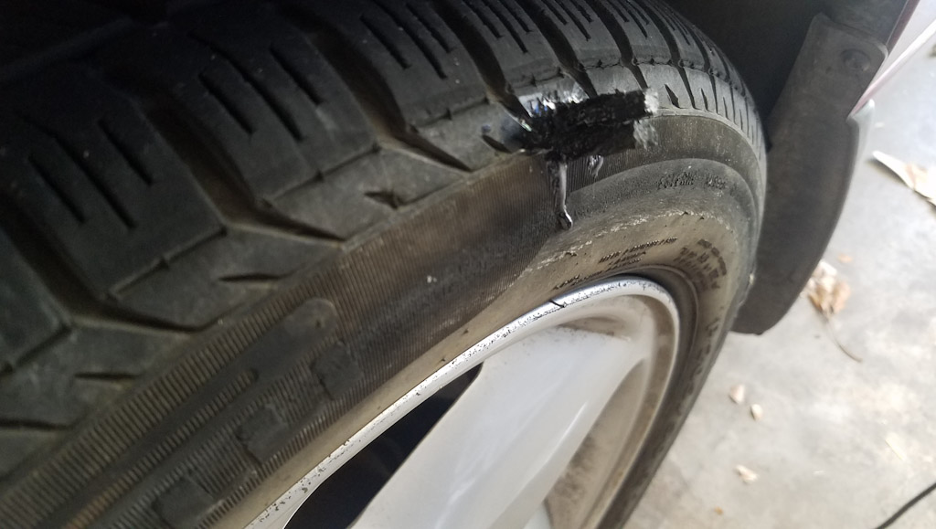

Had to patch a tire in the worst possible spot. Definitely no highway travel for me until I get new tires.

Ouch, definitely time for some tires!

Move that one to the back, Zion, and watch your speed. Ive driven with worse, but that was when I was awfully poor.
