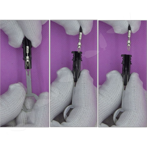

The name of the tool your asking about is Pin Extractor.
Examples.
A Pin Extractor compresses the retaining tabs so that one can back out the pin.
On some but, not all, it is possible to use Jewelers screwdrivers to extract the pin.
Examples.

I thought it might be a tool thing of some sort. However, the wire/connector in my car is a much older style. Its literally a holder for the types of wires/connectors you might see anywhere around a car: a wire ends in a small fitting that slides over another "spade" like fitting. In this case the plastic holder just holds 8 of these wires which are then plugge in to the ECU. So its not exactly like the style of pin you pictured. But maybe the removal is similar? I need to get a small screwdriver in there and see if I can release it?
