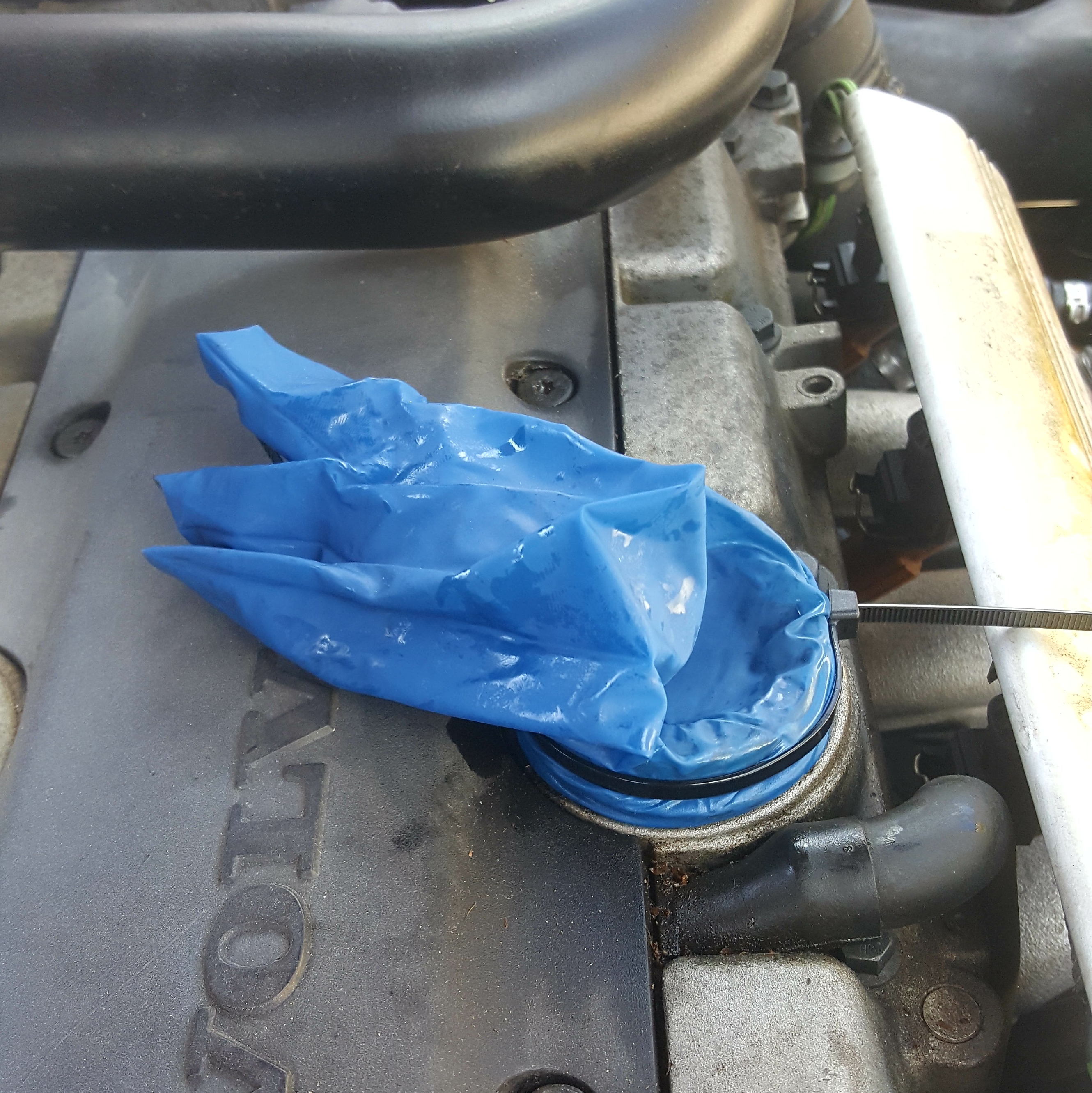

When was the crankcase breather system last cleaned (PCV system)? This is the normal cause of oil seals blowing out as the system blocks with age causing more crankcase pressure and blows out the seal.
Look for PCV + Glove test to see if you are getting excess pressure in the system. If you are, then replacing the cam seals will just blow them out again, along with the Real main seal (RMS which is a 10 hour job).

Thanks for the replies. I did check the PCV a few weeks ago. I don't know when if ever it has been done but the glove test turned out fine. Didn't inflate at all. Just kinda laid there.
