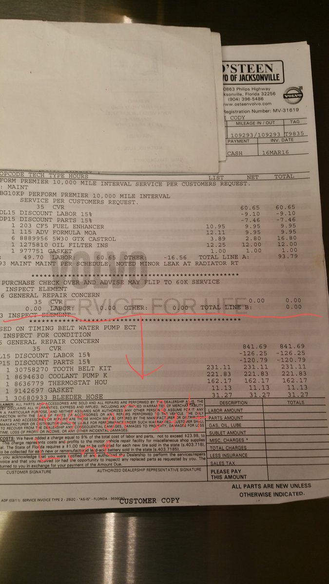

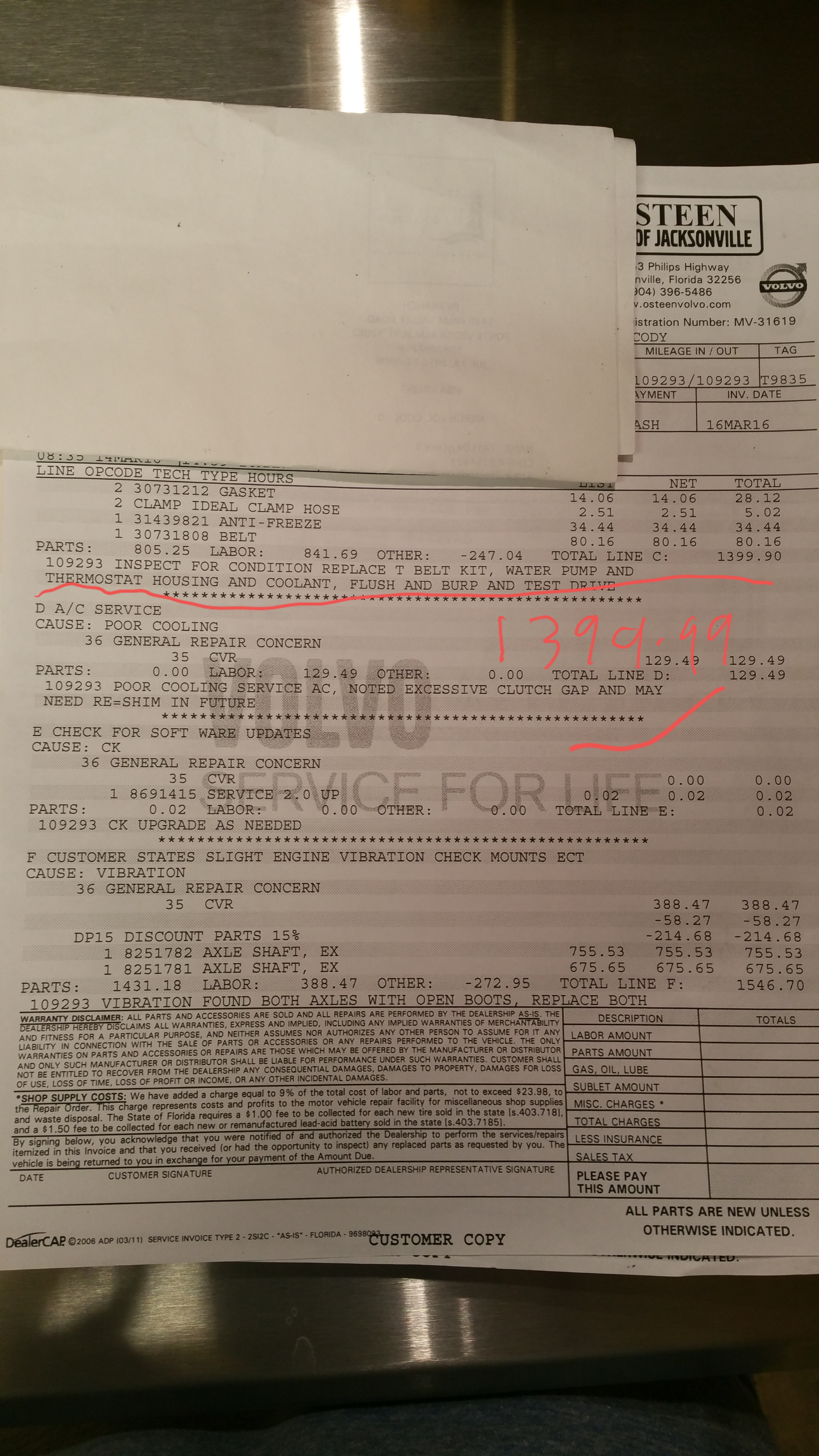

Here is my receipt for my timing belt. The Volvo belt kit comes with the seals. Notice my dealer charged $1399 for the service. Juneredc70 wrote: 02 Jul 2018, 18:28 Well, because I did not know that is what a dealer would charge? Which is why I asked if that was a legitimate price in the first place. Dealer or indie.

For the record, the cam seals should not be leaking at 150k that is unusual for these engines. And changing the front cam seals is not standard at all with a timing belt job. The timing belt kit includes two rollers (one is a tensioner) and a belt, no cam seals are included.
That said, on your car they obviously are leaking and should be changed. The 99 may not have rear cam seals, just the front ones. $1100 for just two cam seals and one timing belt (no other timing path components) is high, even for a dealer.

Thanks for that erikv11, thats kinda what I thought. I double checked 2 different suppliers for what came in the timing/water pump kit, including my receipt and none of them include the cam seals. Thanks for reaffirming what I thought originally. I will take some things apart and have a good look around later this afternoon. Currently I am wrestling with a 300E window regulator.
