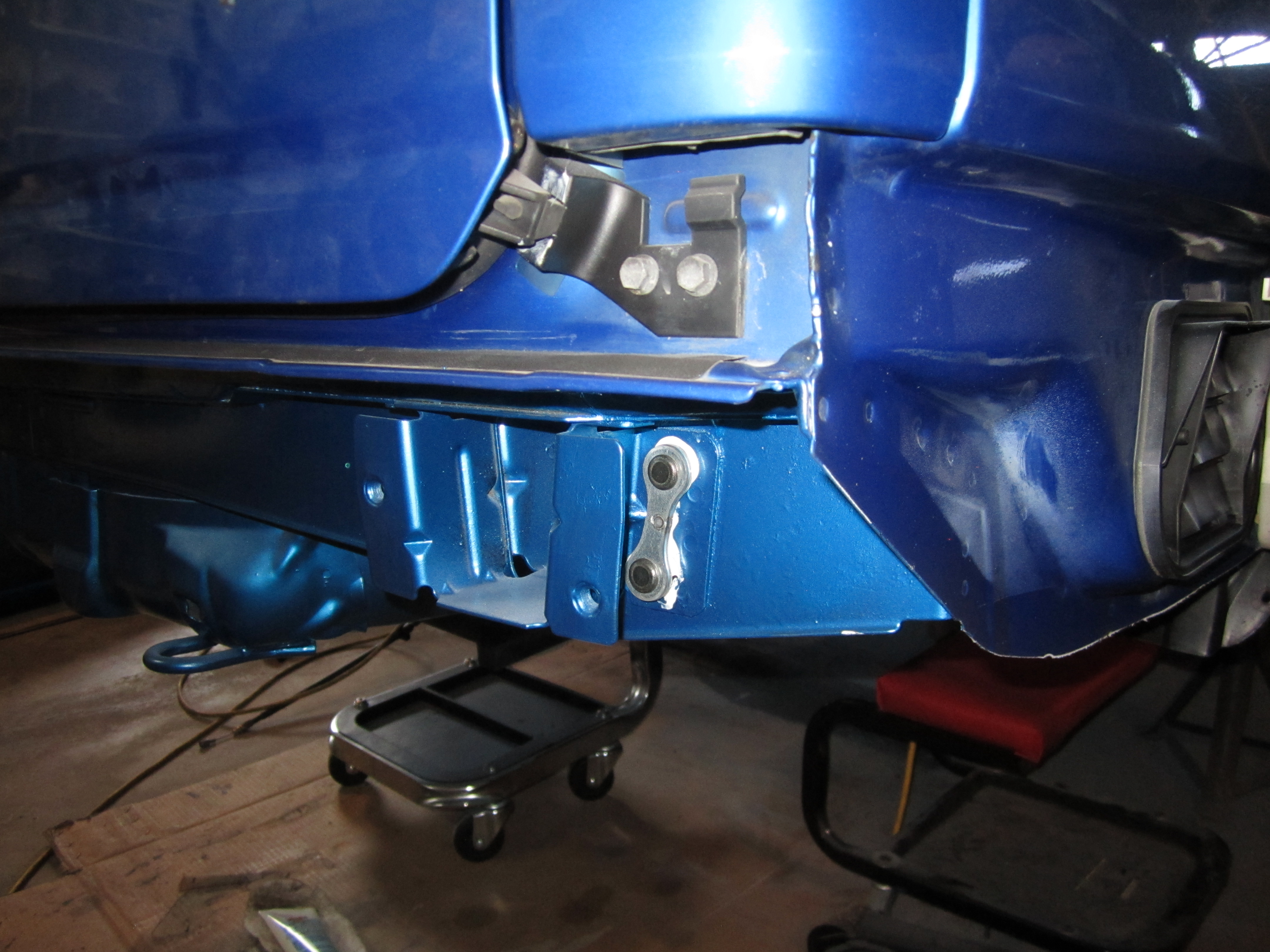

I hope after all that work you went to the effort of protecting all that rusted rear metal the bumpers mount to like this:
Only joking as only I am mad enough to do that!!LoL
- Posts: 36153
- Been thanked: 4068 times
God that looks gorgeous!
I sprayed it with WD20
